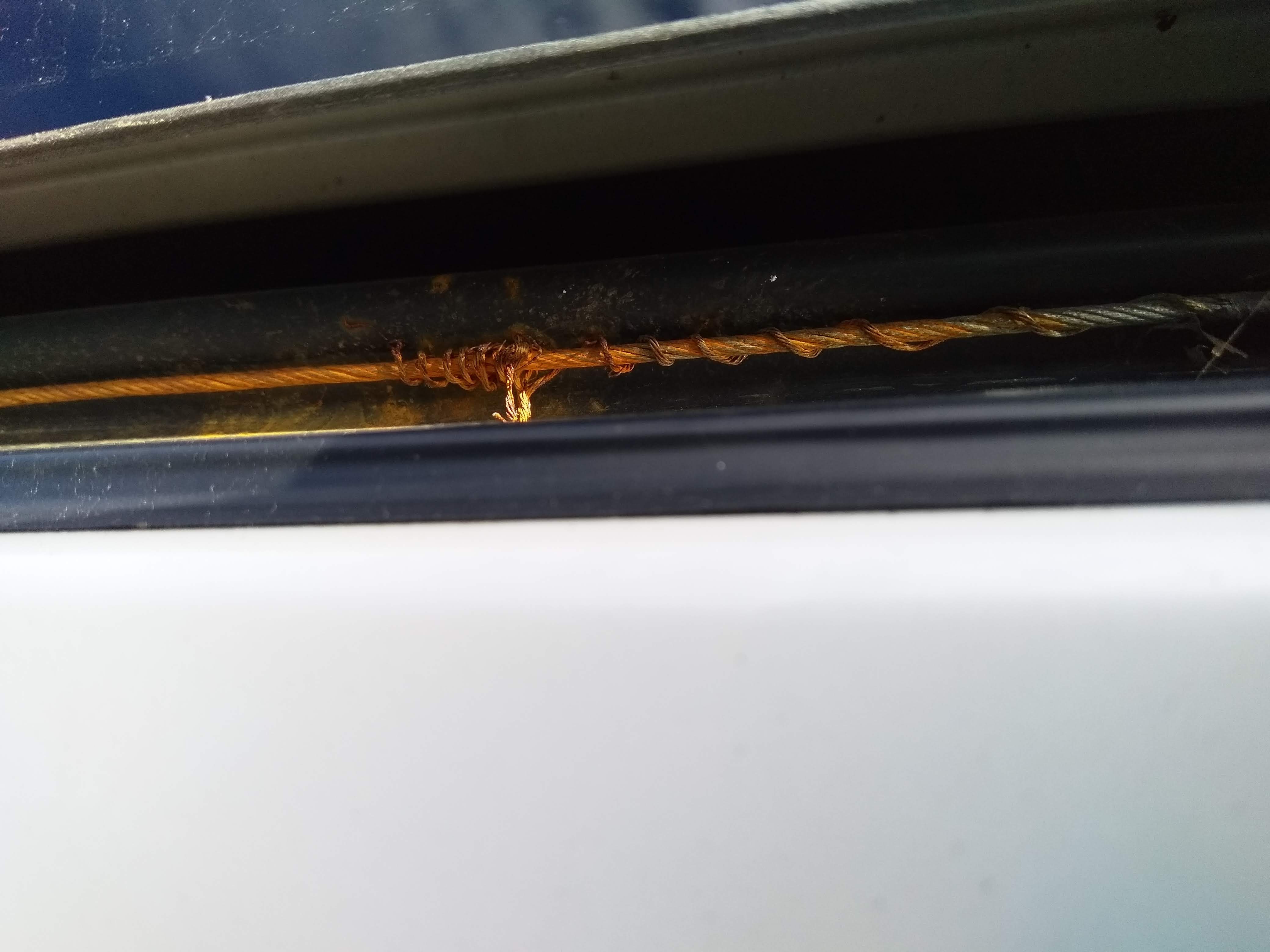

Hi, hoping for some advice please...
Our nearside sliding door cable has lost it's rubberised coating, rusted and frayed on our 2004 Alphard. The door motor works fine, but the door jams on the cable so we've had to stop using it.
Is this the correct correct replacement part please:
https://gt4-play.co.uk/shop/alphard-power-sliding-door-cables-genuine-toyota
https://www.ebay.co.uk/itm/314117006249?
Is it possible to just replace the external cable somehow? Or, do I need to buy the part as above and replace the lot?
Many thanks in anticipation
Rob

Hello Rob,
Welcome to the Forum
2 hours ago, Picasso said:
Hello whats your reg no. i will check
Hi Picasso, thanks, appreciated - but not keen to post registration. Can you help from the model please?
3ltr, V6, 2004, Alphard G
Send Lee a personal message.
Personal Messages are private.
Click on the Picasso circle and then Message and send him your registration number.
Lee has a system for finding part numbers for the exact vehicle.
It's up to you, but I can vouch for Lee.
Thankyou Roger for putting trust in me . Rob the o,e number is 6964158010. The link for gt- 4play is correct one for you bought one of this same seller myself last year
Thank you, Lee and Roger. Hope didn't offend, first time on forum. Appreciate the help
Rob you never offended me I like helping on here if you need any drawings or need part no.s just ask I can xrefference oe no.s to aftermarket parts we are all here to help each other good luck with your alphard
Auto jap spares should be able to sort you out,I have had stuff off them before, have your registration and chassis details, better to phone and talk to someone, very helpful sort you out with correct parts
