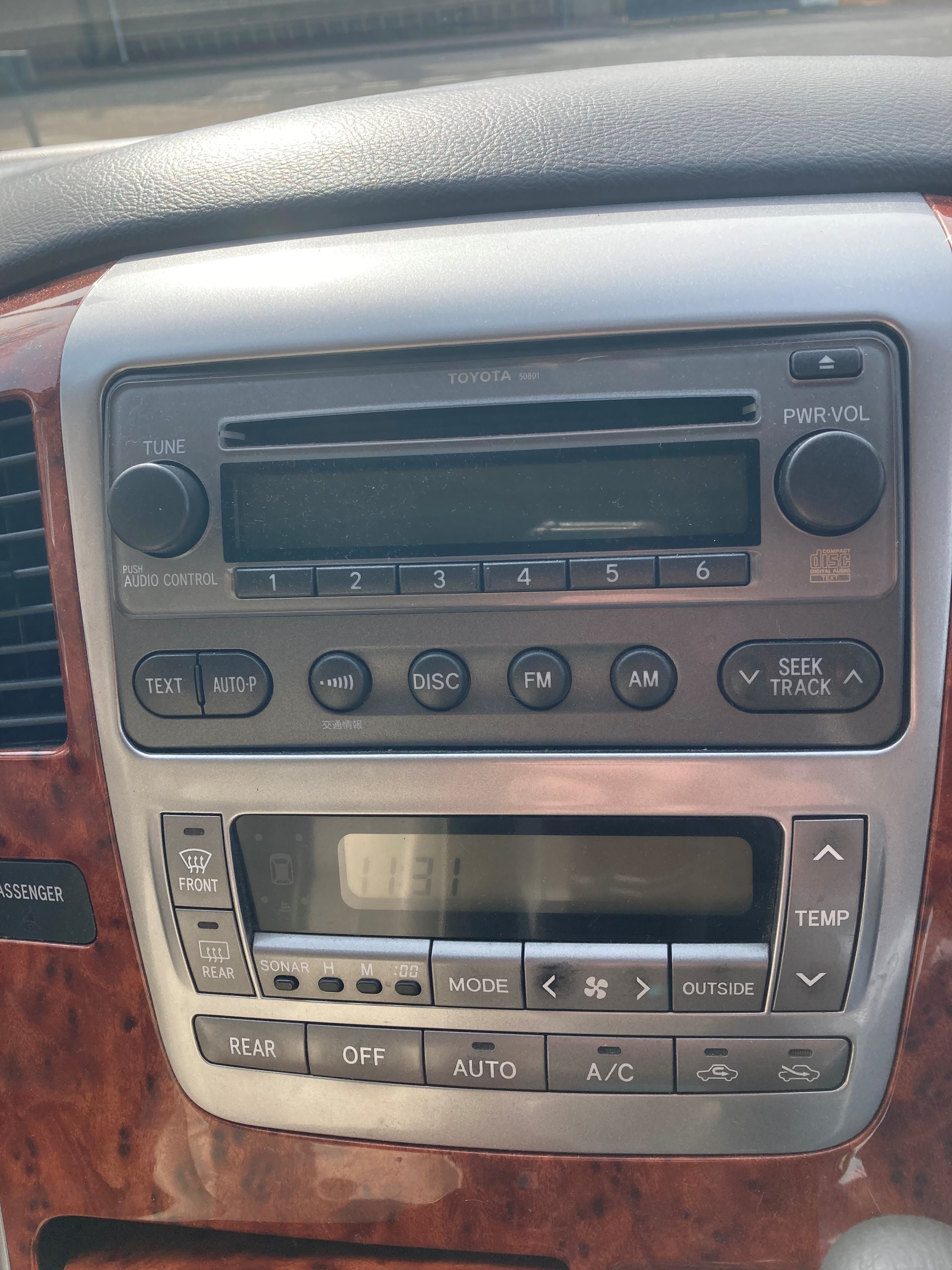

Hello,
I hope someone can help. i have a 2003 model without satnav and was considering getting one fitted or fitting myself. I have attached a photo of the central dash and wanted to know if anyone could recommend something that will fit directly in place of the current radio/CD player and if anyone knows if it something that is easily fitted by myself or if i would need to go to a garage.
Thanks in advance
Any double din unit will fit you just have to measure the width, they are fairly easy to fit but to use the steering wheel controls you need an adaptor loom, see Dynamic Sounds Ltd, the exist cameras are 6volt so you need adapters or change them for 12v ones which will be a better quality

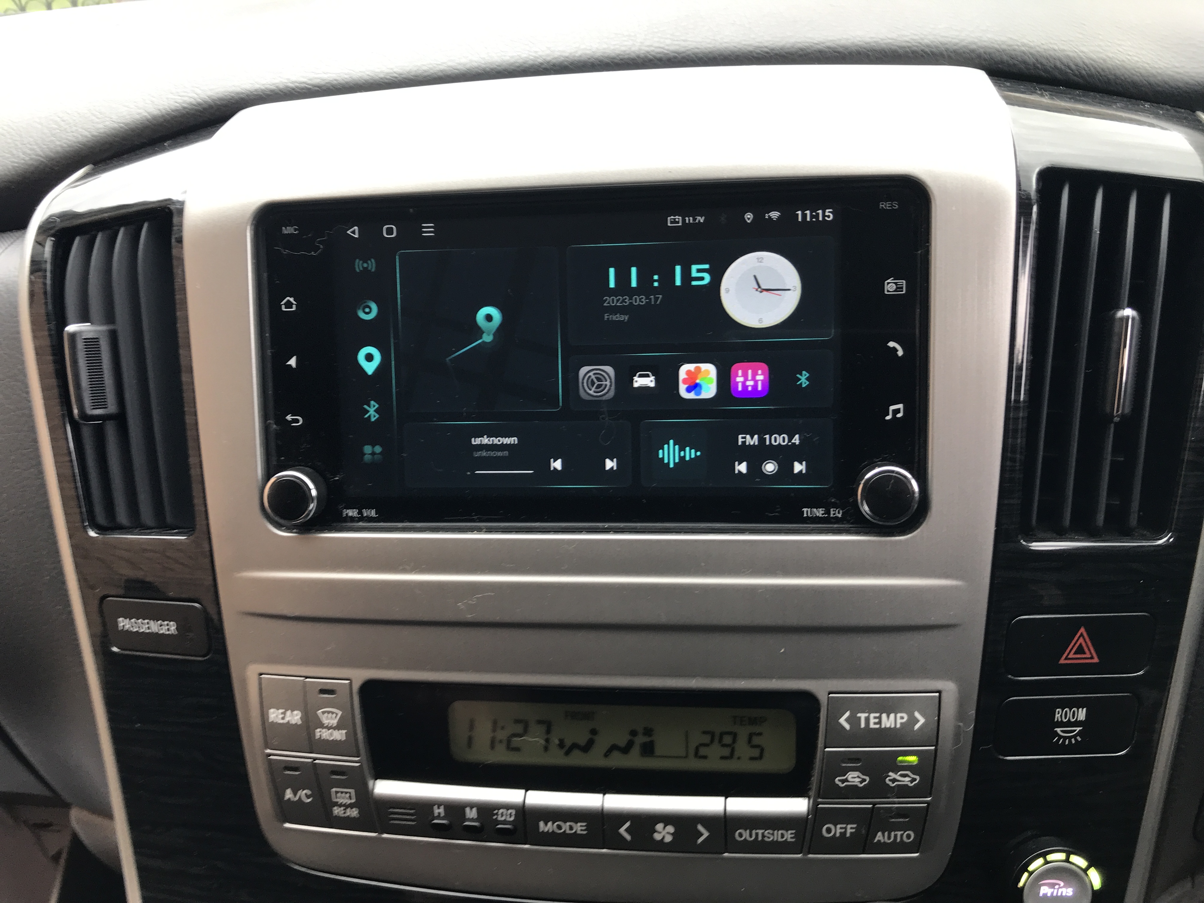

hi  my Alphard had a panasonic  stero unit when I bought it . I had the unit replaced with an Eonon android unit which included rear camera, It cost £500 including fitting (including camera)  With regard the sat nav, although you can use google maps and others I downloaded Tom Tom go  cost £19.75 renewable annually.  Trust this will assist.image.thumb.jpeg.0979c1c5cc76f1efdb0ab666f6c4ab0a.jpeg
