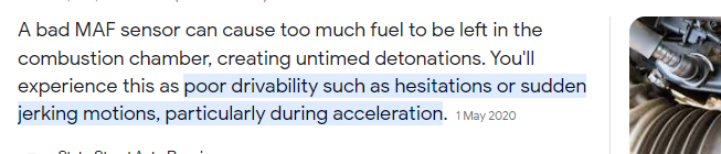

Sounds like my alphard hybrid... but I have a CVT.  I thought the transmisison was shot.  culprit was the MAF sensor, but it threw a code on mine.
thanks Mark
definitely may be worth checking this - cheers image.png.71f47b5baae76674a78daae60bcea2b4.png
