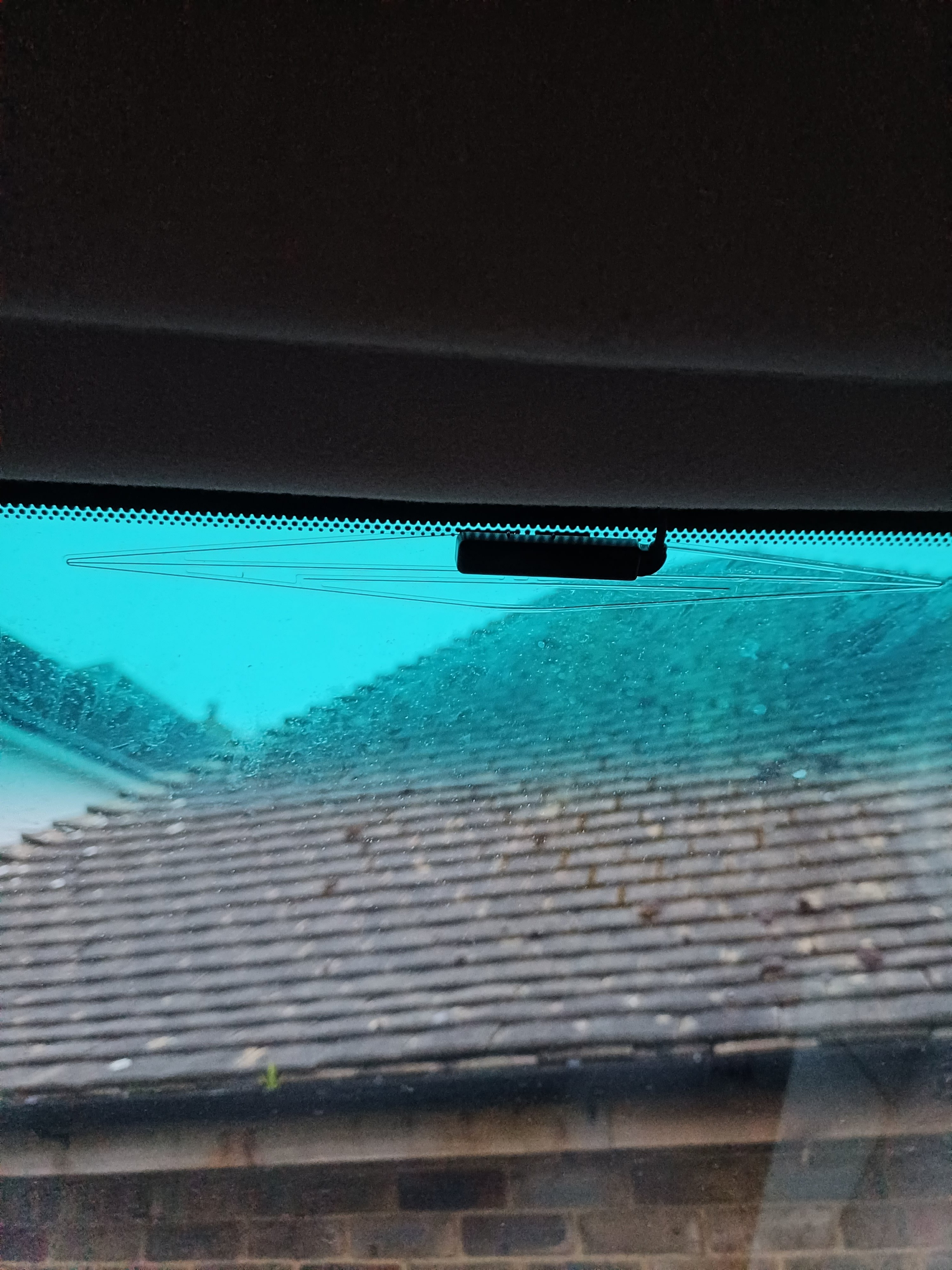

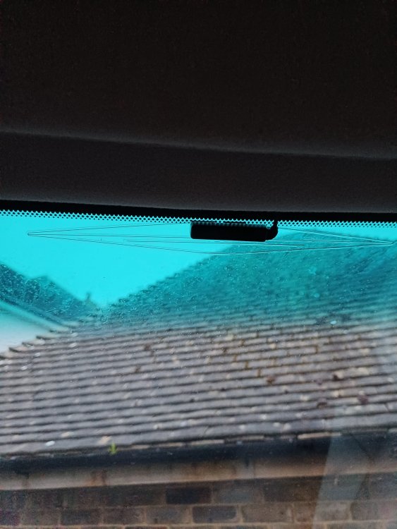

I have four of the above antennas on the car (two front windscreen, two rear window).....any idea what these are?
It does have a very nice Pioneer double din system with wireless android auto/carplay so did wonder if it was some sort of third party FM antenna for it (has DAB and that ones obvious) but more likely some import quirk.  If anyone has any ideas be much appreciated.

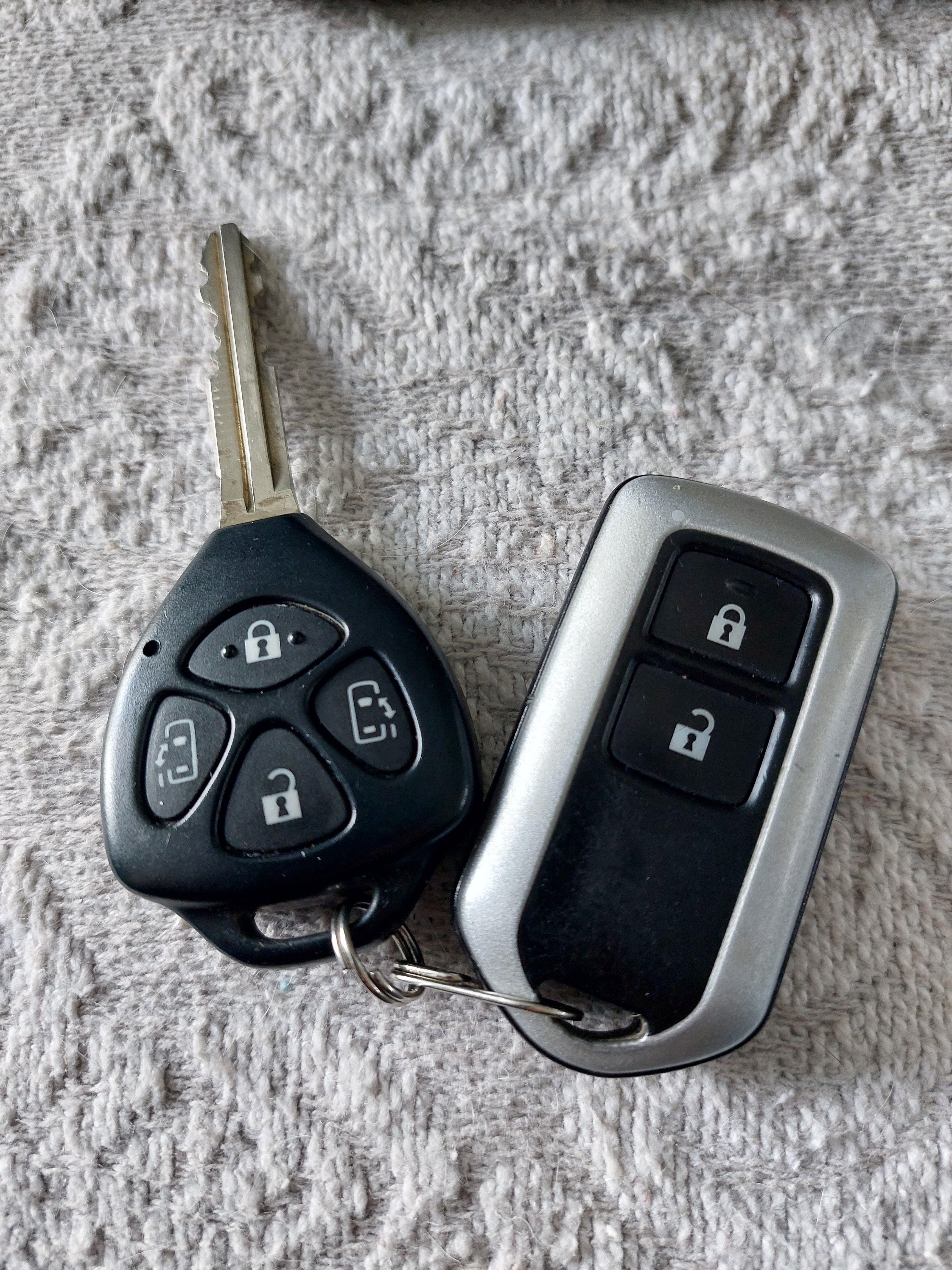

The fobs for (my) the keyless entry system, smart system, have only three buttons.
Lock, unlock and tailgate.

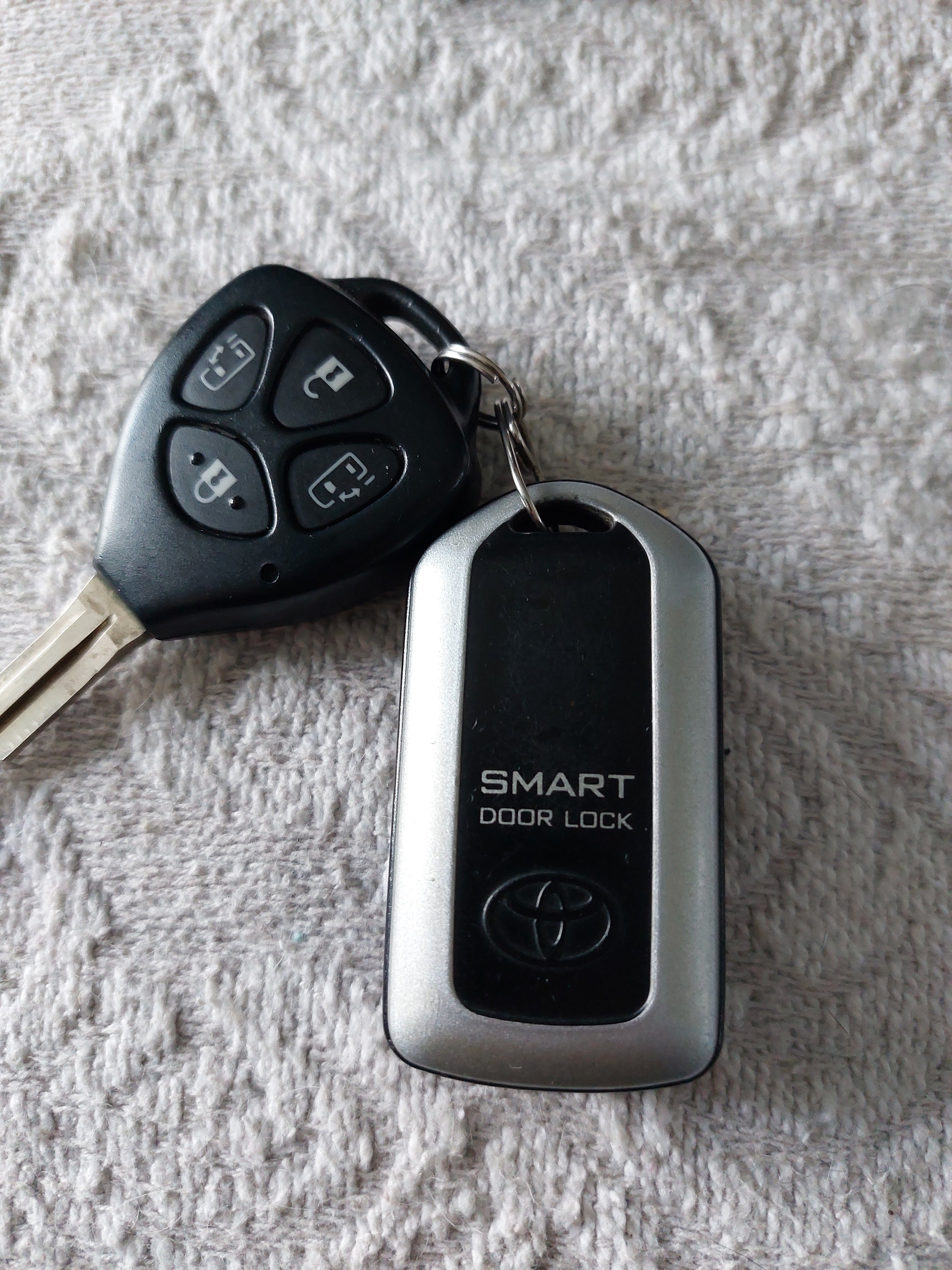

Mine is also Gen1 AH10 and have this unit that I keep with the main key which may be why the buttons unlock the car.
Thanks for this, I dont have a proximity key which explains it.  Can only assume its been misplaced, or perhaps never came over from Japan when imported.
No real loss as still need the key to start the thing, but good to know!

Alasdair's photos are exactly what you need should you decide to get some.
They are not cheap.
Investigate programming costs if / before we you buy; as they can be surprising and difficult to locate where to have them done.
It is unlikely a Toyota dealer will do it for you.

Any oem aerials on the windscreen are for the toll card system, I had 4 on mine, the oem tv and radio aerials are in the rear quarter windows, radio offside, tv near side. the rear screen would have been connected to the headunit it was not a stand alone unit
Ah interesting, probably the toll system then!  It has a little black receiver by the rear view mirror that is definitely part of it, then the other four are like the ones in the photo i posted...two front windscreen, two rear window.  If it wasnt TV related guess it can only be that!
I still have the little smartcard box for it in the centre console, guess the work involved to remove it the importers just dont bother?
Yes too much bother or not enough knowledge, the reader has 2 wires, one is for the aerials the other is 12v + & -, don't cut that one as you can use it to power usb sockets for phone chargeing

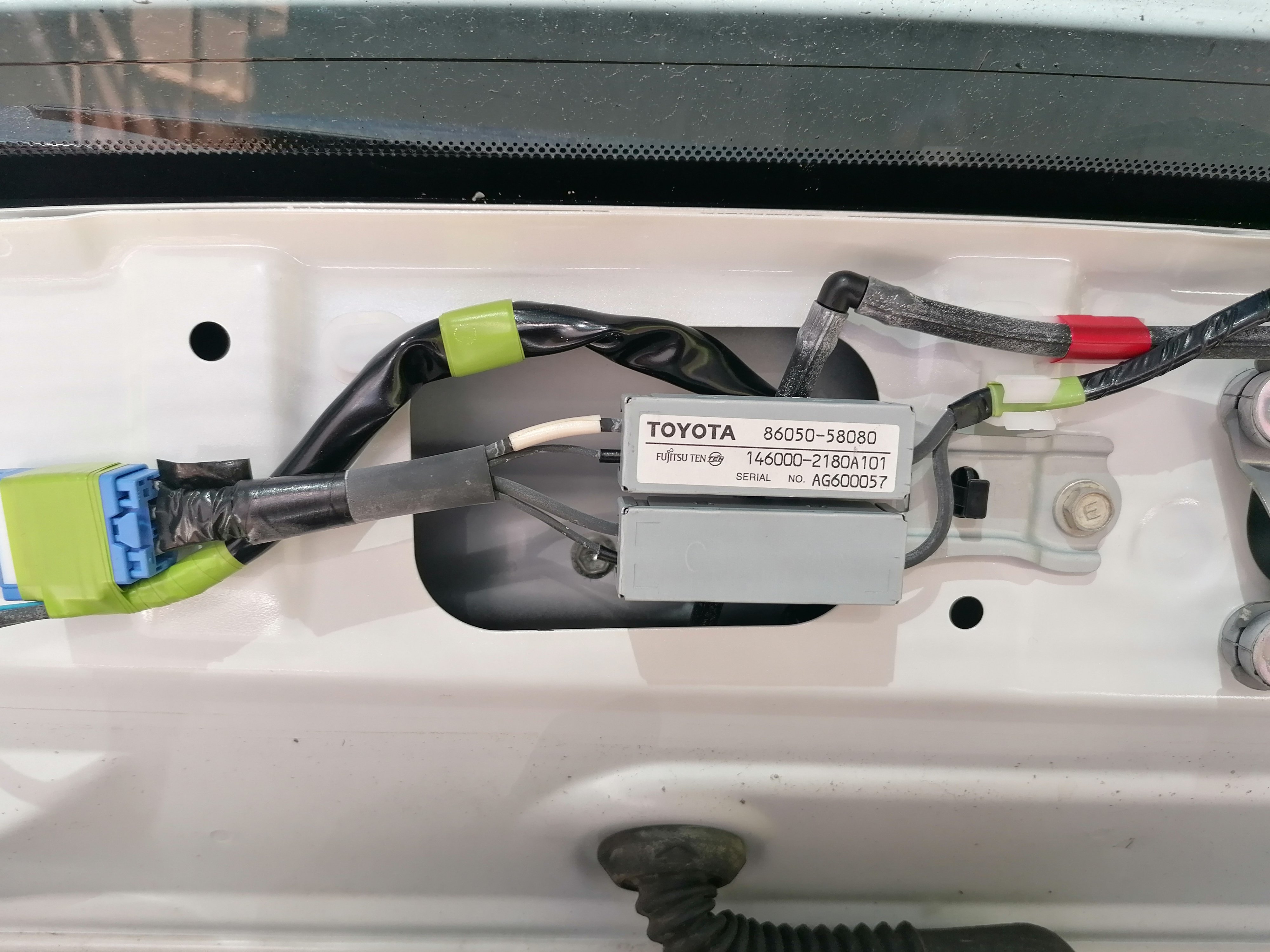

20 series tv antennas x2 are fitted inside the rear spoiler!
Ah mine has a little black patch on top of the spoiler that looks factory but a bit out of place....wouldnt surprise me if thats something to do with it
