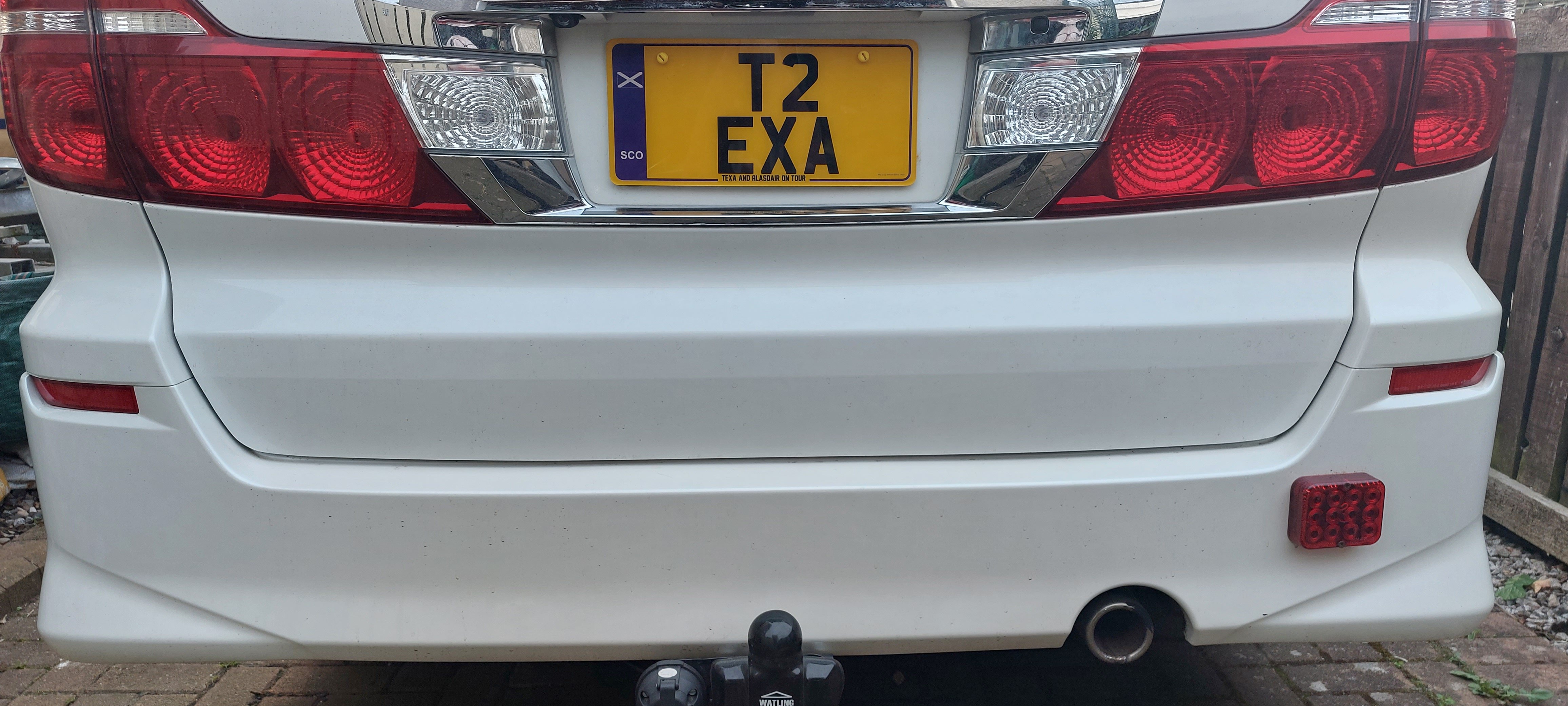

Yes, check out PCT Towbars they are the best and I think the only company makeing one for an Alphard
There seems to be better supply of towbars for gen 1 Alphards (on K platform)
I tried  to get hold of a PCT gen 2- ANH20 towbar but strangely was refunded on purchase. (possibly-probably fitting problems)
Fortunately I  replied to a request on here  via Carl Millis-Technical design engineer at Tow Trust Towbars Ltd who are actually going into production of the ANH20 towbar ( New MC platform)
They have used my Van as a template to fit,  The first bar  is now made & painted  ready to be trial fitted early next week  (early June 2023)
They will soon be able to supply bars in either fixed flange, swan neck and detachable versions. All manufactured with the latest lazer cutting and high tech forming equipment by "Tow Trust " in Warwickshire -Great Britain!

Alphard series one 2005 3.0ltr  Fitted my tow-bar nearly three years ago, never been queried by any law enforcement officers here in this country or Europe
