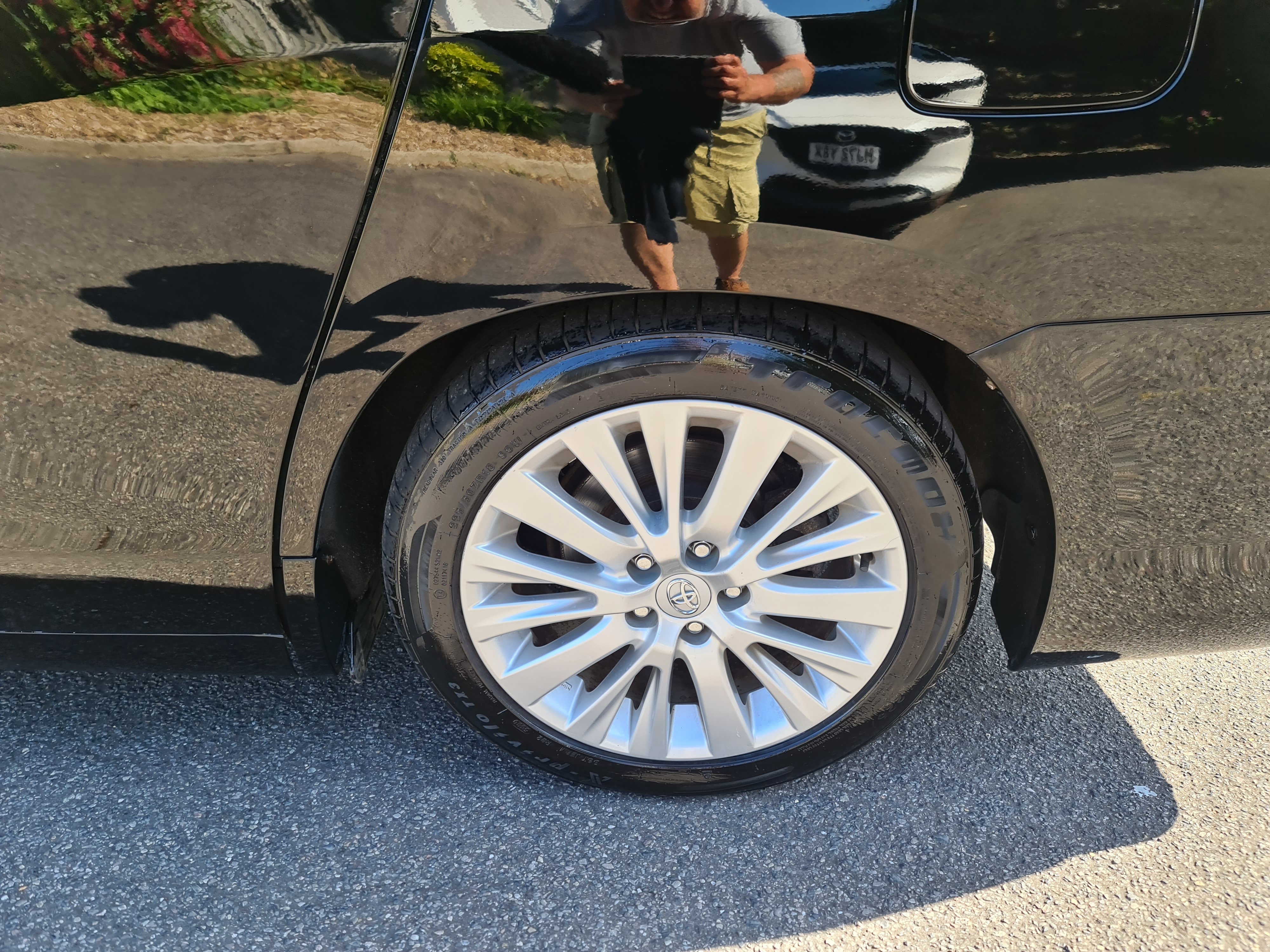

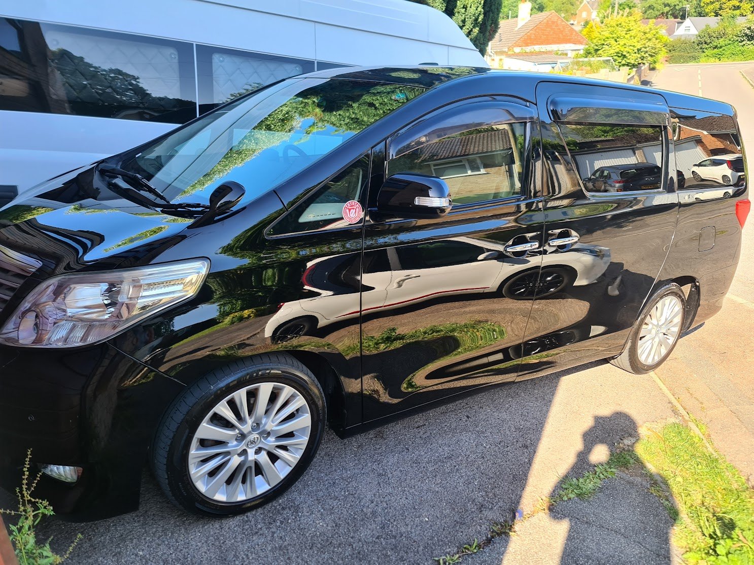

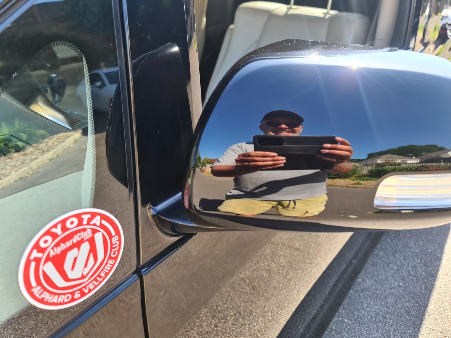

Recently finished a 4 stage detail on the paintwork (i am not a detailer so don't beat me up)
2 x wash with tfr and snow foam jet wash off
Meguiars Clay bar decontimination (Amazing how much comes off)
Meguiars Compound with machine and hand wiped off
Megiuars Polish with machine and hand wiped off
Meguiars Liquid Wax (Polymer wax) sponged on and hand wipe off
Final buff with sheepskin buffer
took around 8 hours not including roof, that still needs doing as too hot.
arms like popeye now. But wow, the car looks sooo deep black now and had loads of comments from passers by
