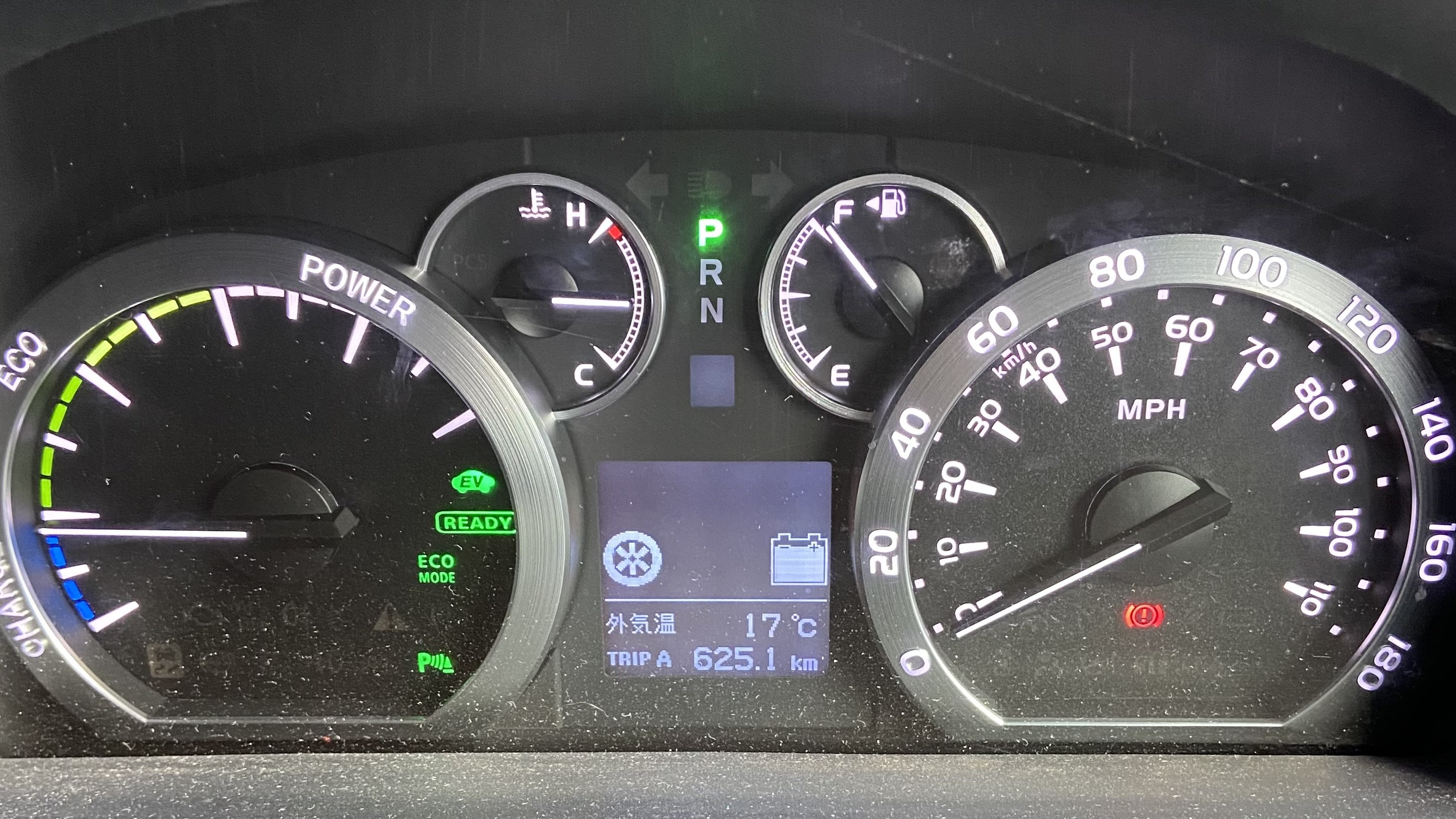

I got the Lockwood dials fitted. Very happy with them. Clock remains in km.
