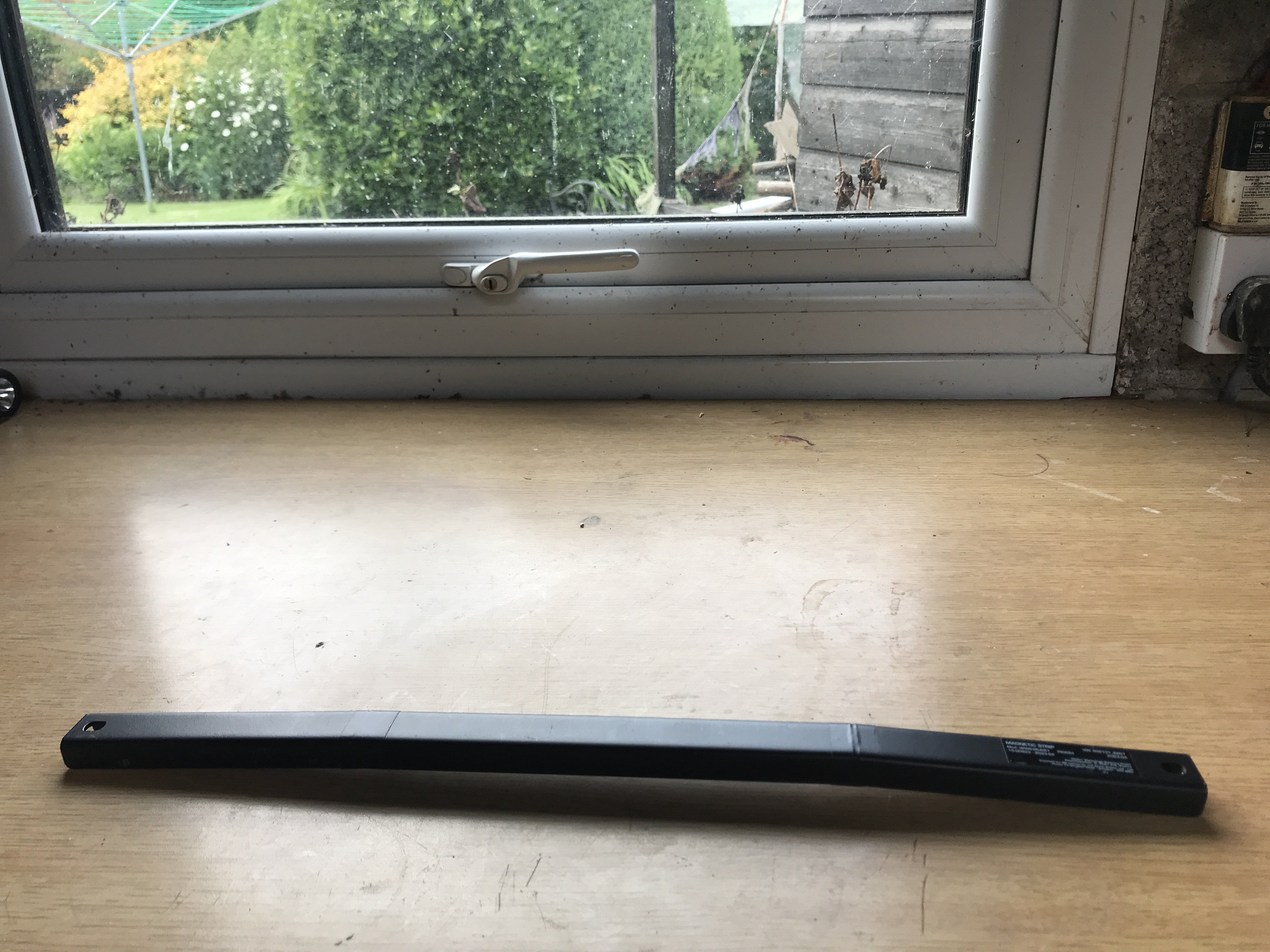

Hello. I followed this topic with keen interest as I also did not want to have anything permanently fitted. I bought several of the Parkside magnets. They really do work. Our awning was up in a filthy storm last weekend and the magnetic rail on the roof did not move at all.
One mod I have done is to cut some slots in one of the magnetic bars and bend it slightly to follow the curvature of the roof at the front, see picture attached. It now sits firmly on the roof along its whole length. I think I might curve one for the rear, as it doesn't quite sit flat.
I do love this forum for the ideas you get. Thanks All.

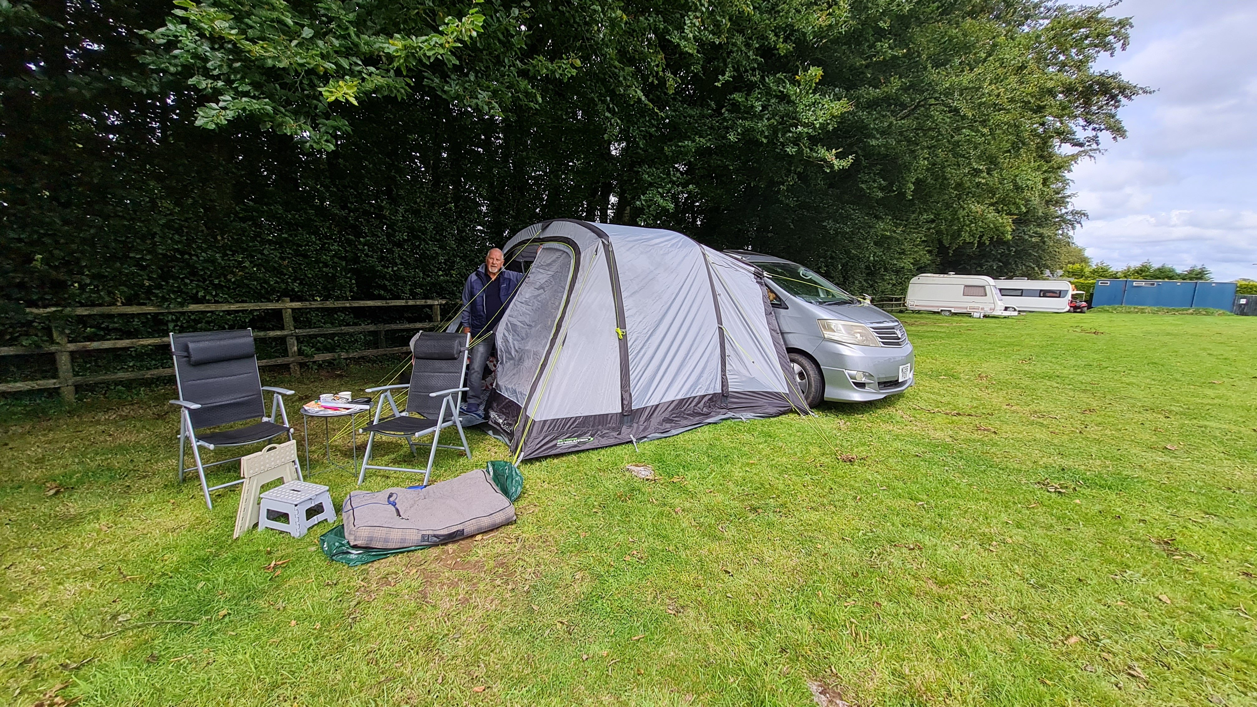

We have a calfornia Coast Air beam awning for our alphard and we bought the corresponding magnetic roof strip that is solid. We just peel it off, drive away and when we get back we back in and reattach the magnet strip.

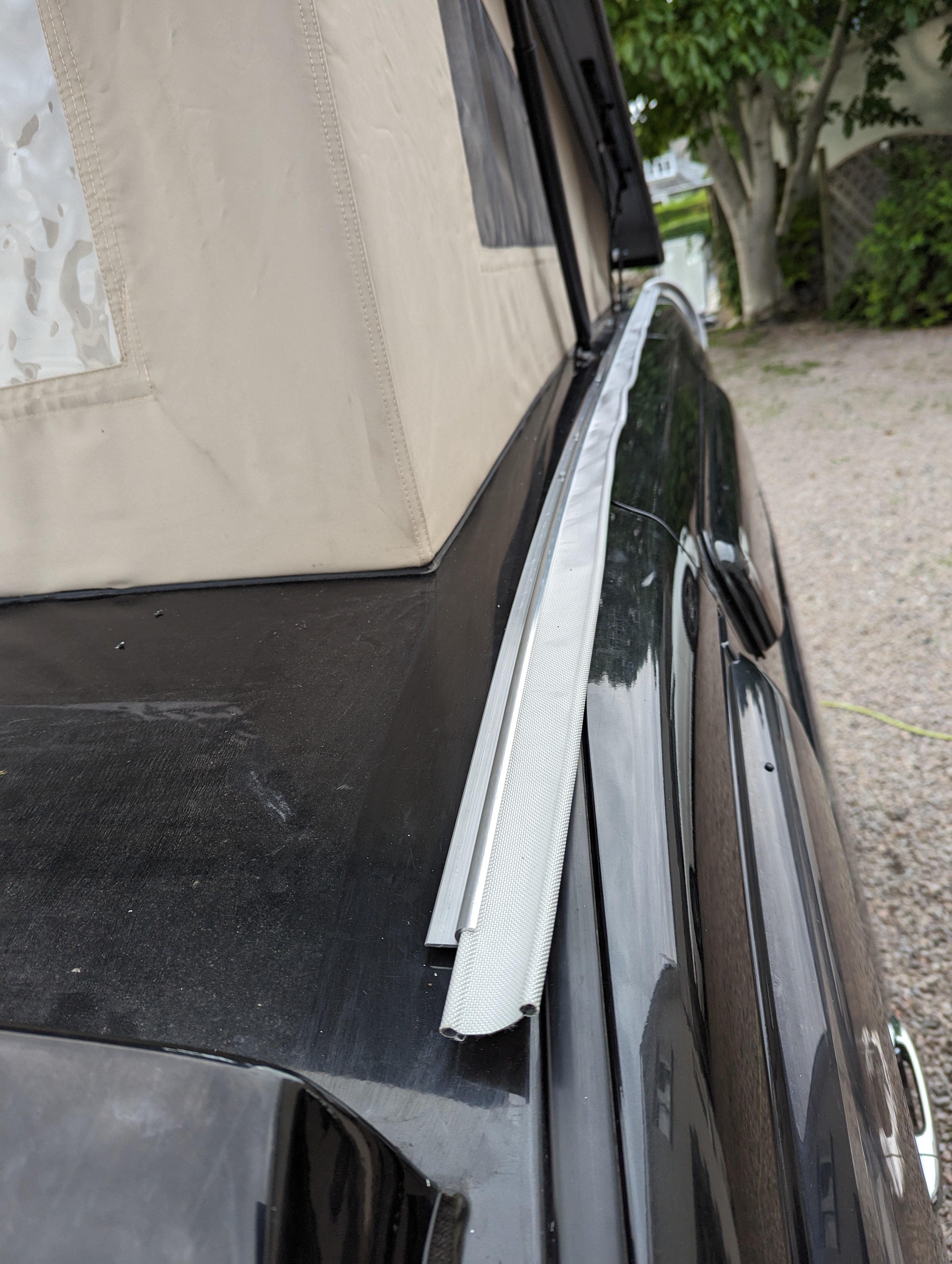

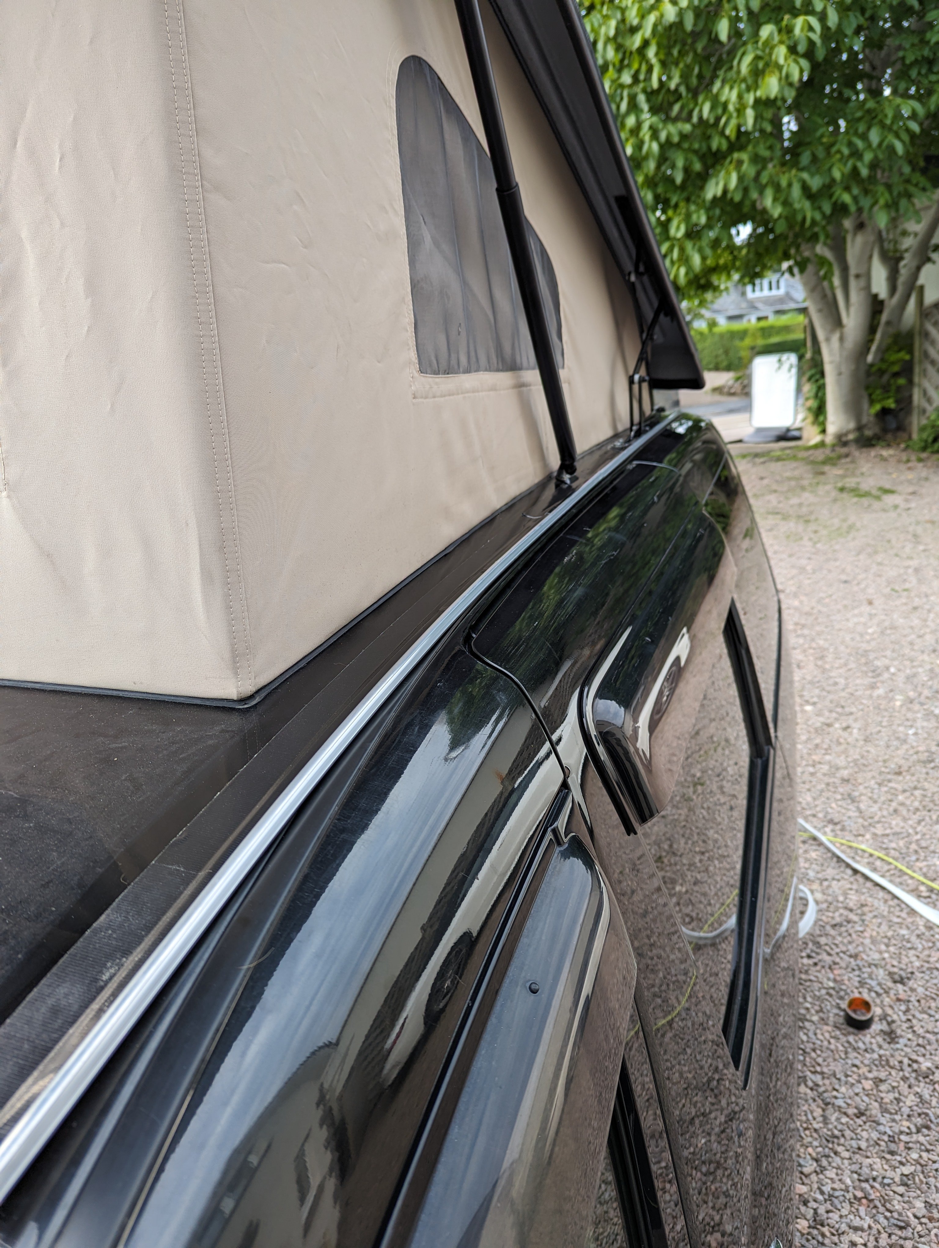

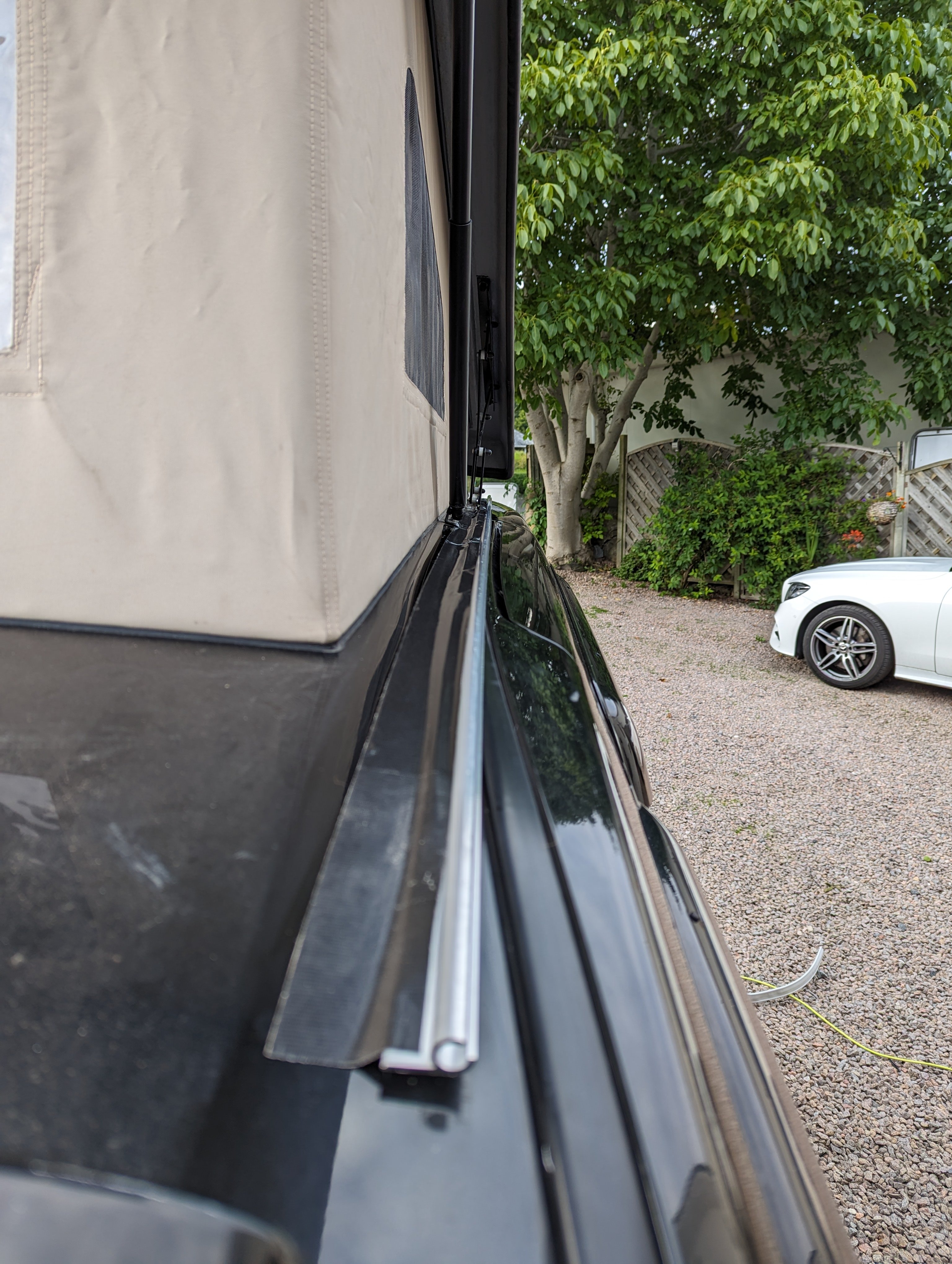

I have an Alphard conversion with a poptop.  I have bought 'stick on' rail to attach to the van roof for the awning together with a drive away strip.   Where is the best position to stick the rail to the van?
I need about 2.2 meters of rail to attach to, thus the length I need would fit on the roof just inside the foot print of the pop top and thus be hidden when the top is down, it would fit on the roof alongside the poptop and be visible all of the time or I might remove the back strip that covers the gutter on the roof and stick the rail in the gutter.
Any thoughts?
