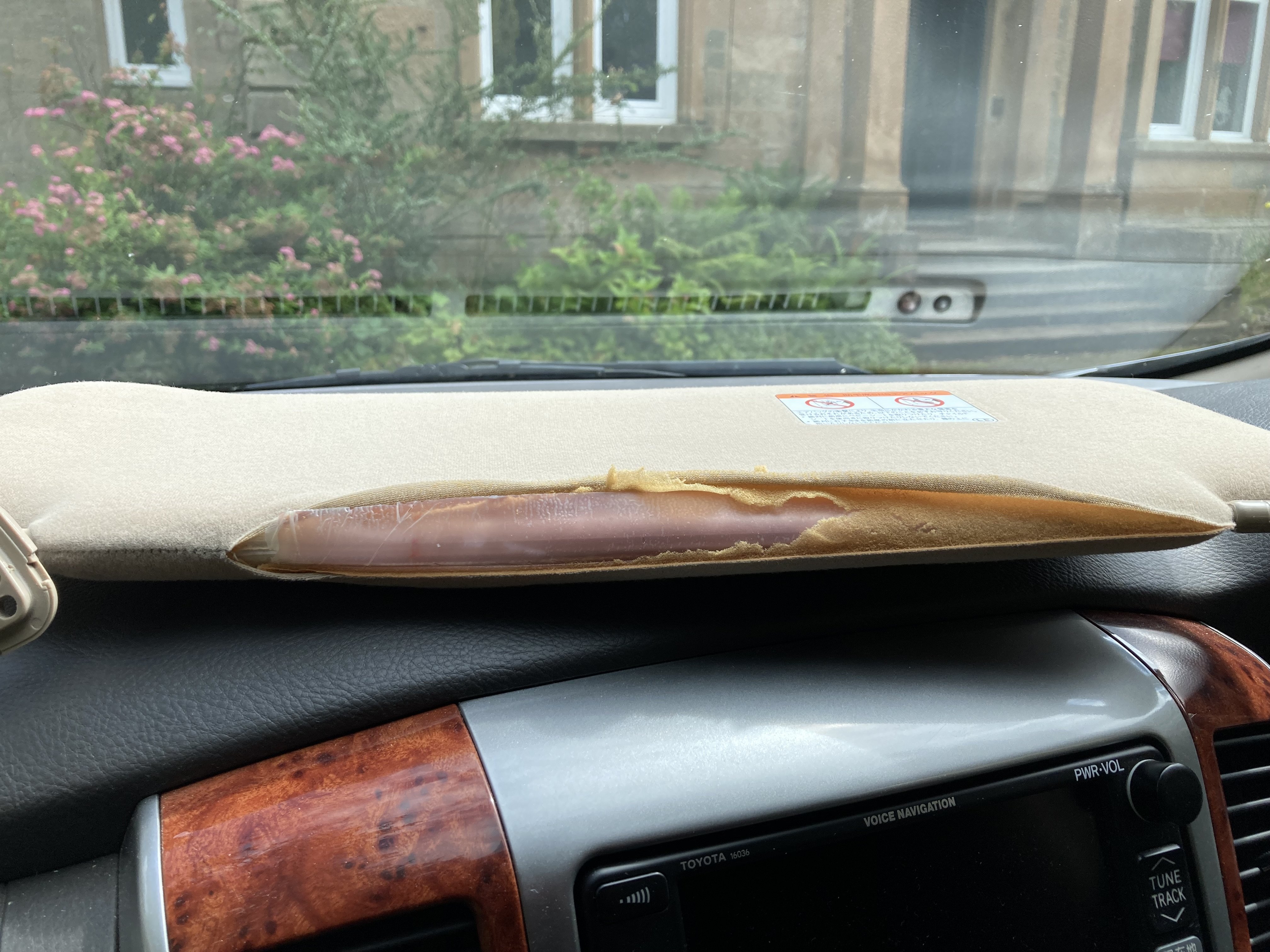

The covering material has started to come away at the edge at the top of the visor, both sides.
Iโ€™ve just had a fiddle about at the attachment points but nothings come loose so time to consult the experts ! ๐Ÿ˜‚
ย I got some fabric glue and might resort to an โ€˜ in situ โ€˜ method.
Not ideal๐Ÿ™„

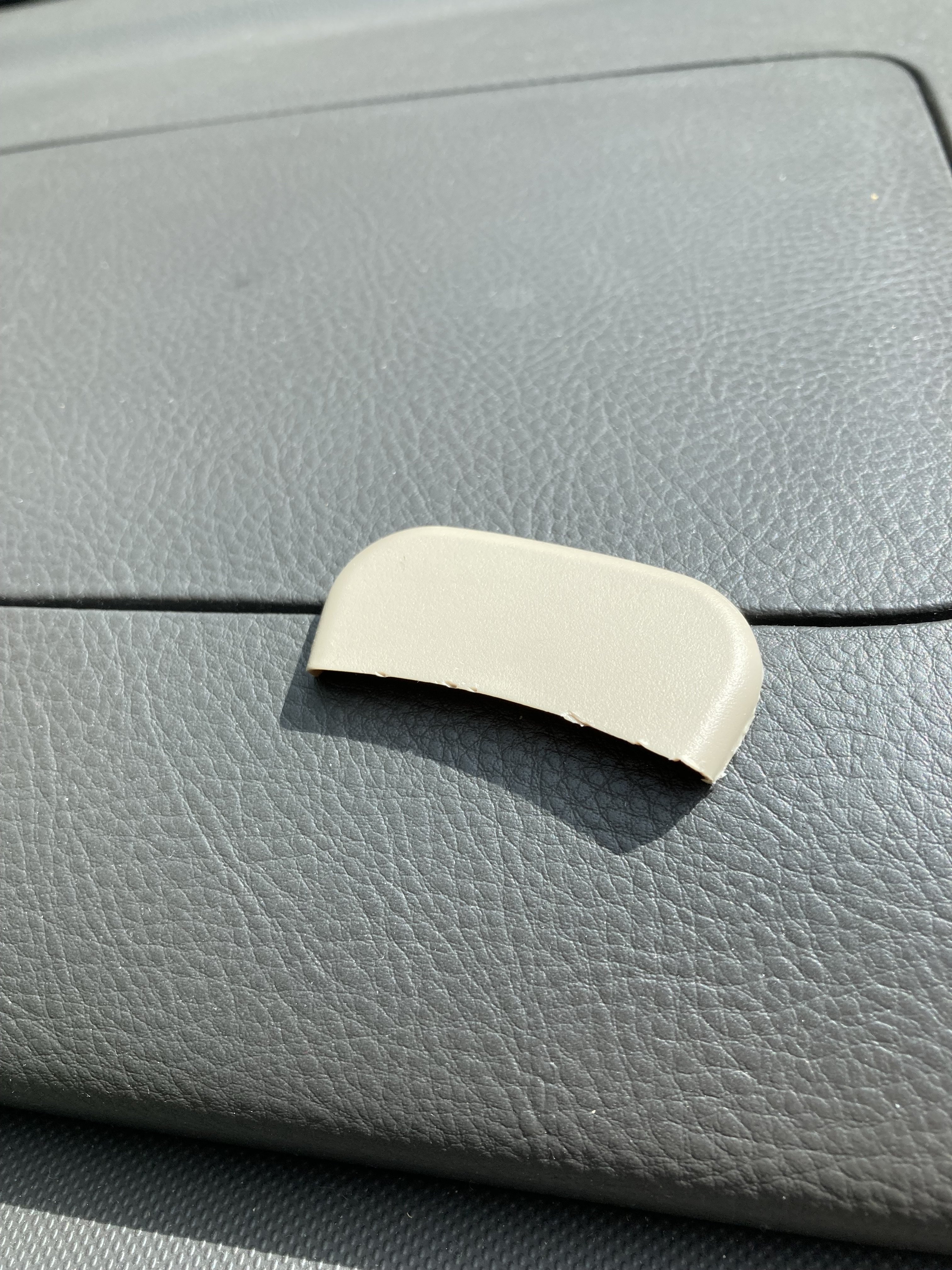

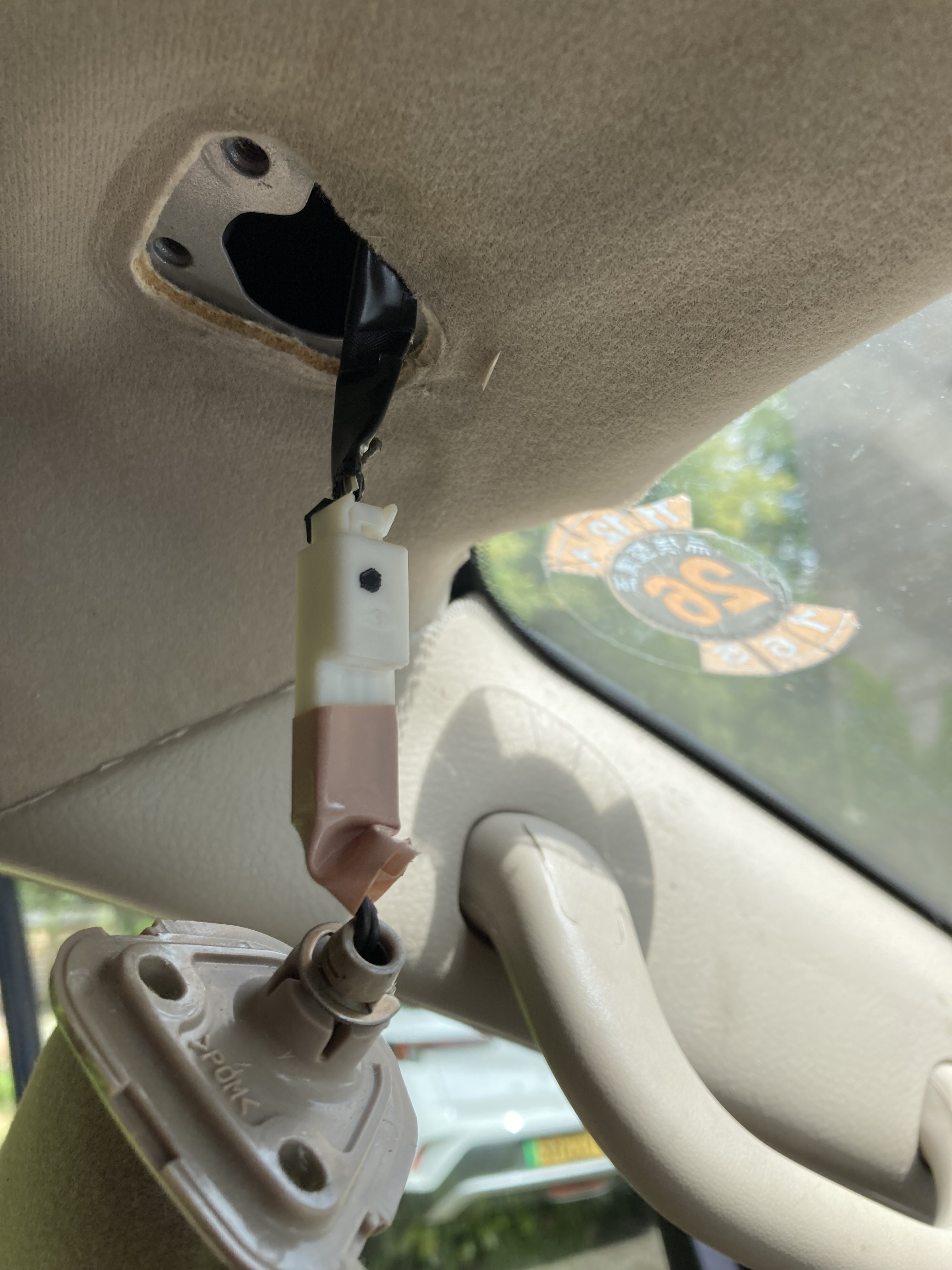

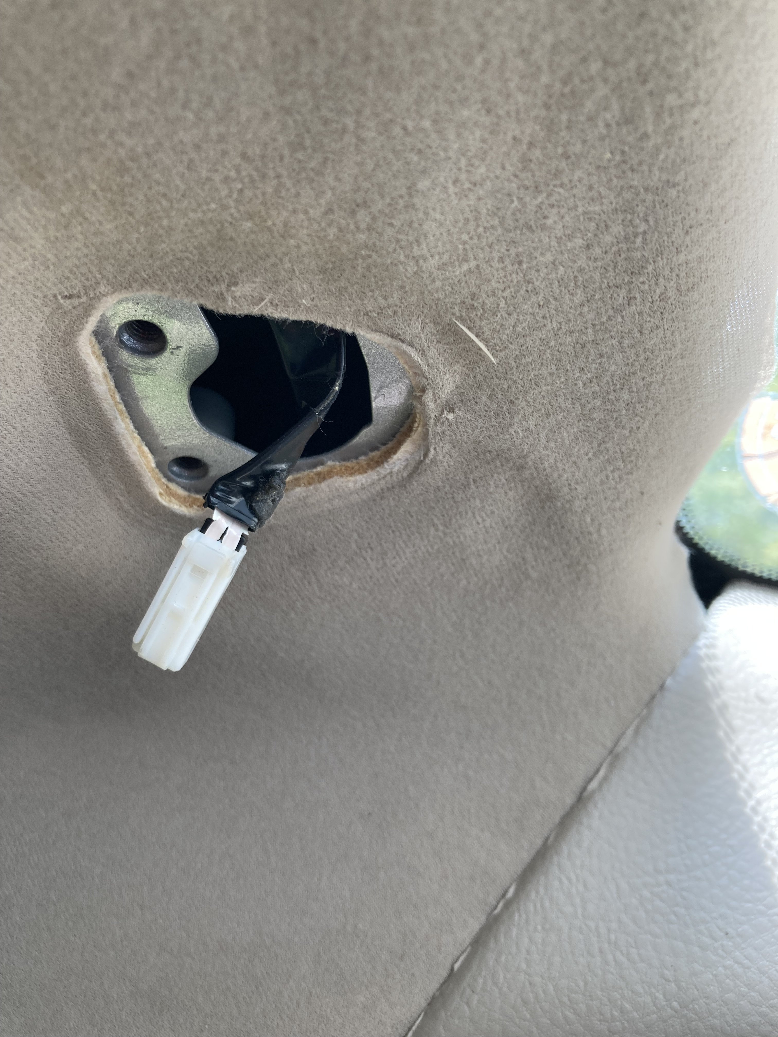

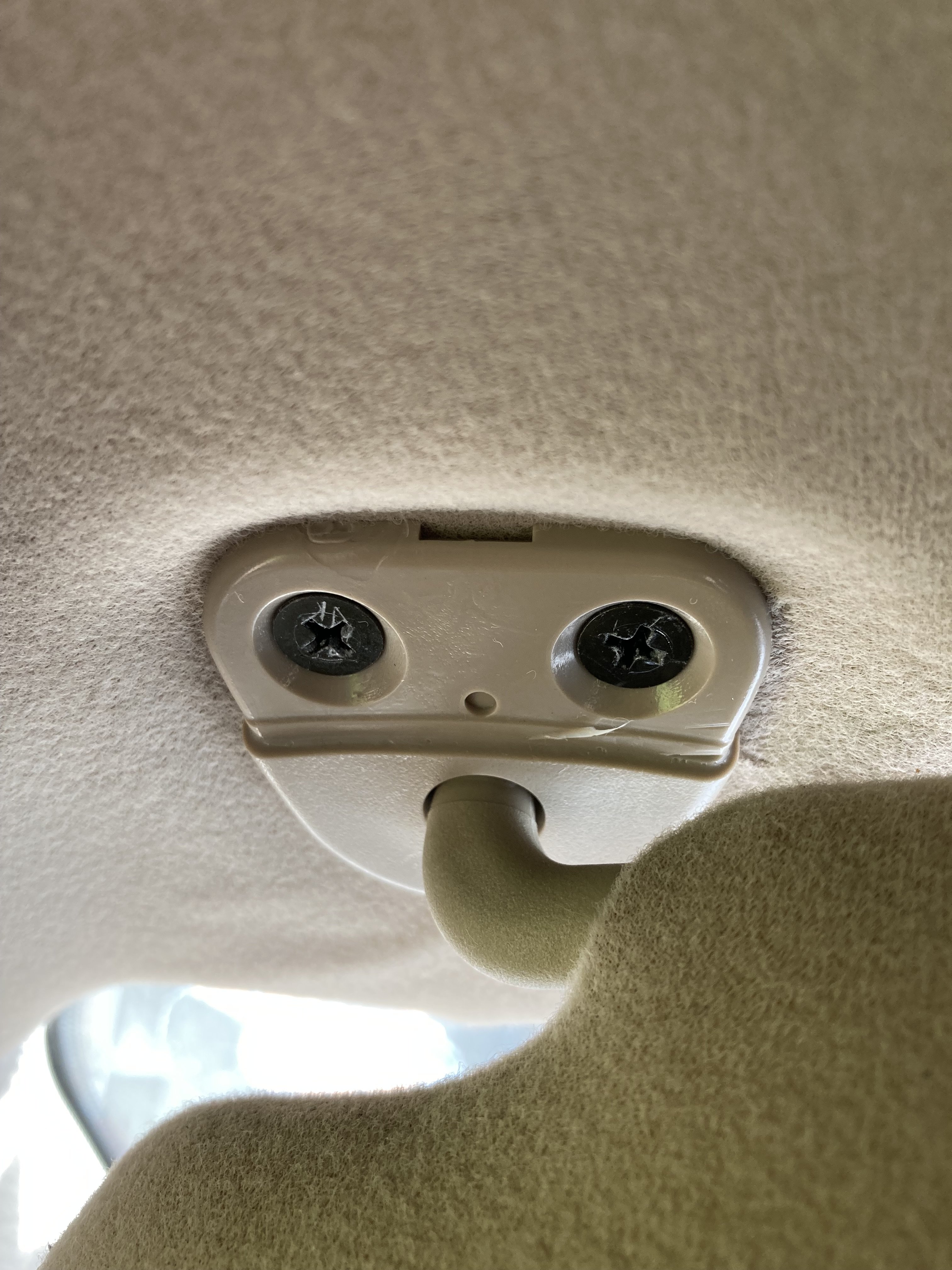

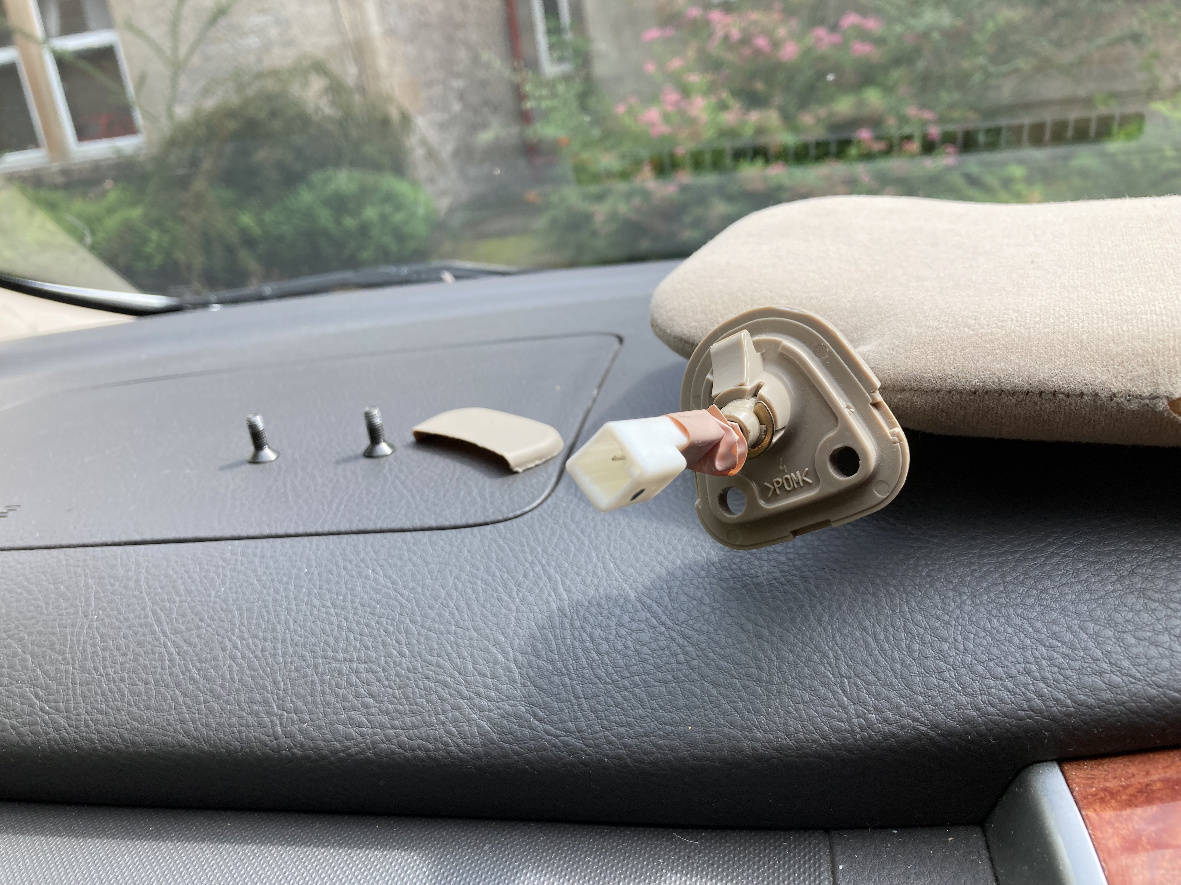

Good news on visor removal (ignore YouTube!)ย
Itโ€™s held in by 2 screwโ€™s hidden behind the โ€˜halfโ€™ cover.
Pics to follow ๐Ÿ˜‰

All back together, fabric glue seems ok. Material was also starting to come adrift from head lining so thatโ€™s been glued too + minor splits on drivers visor.
