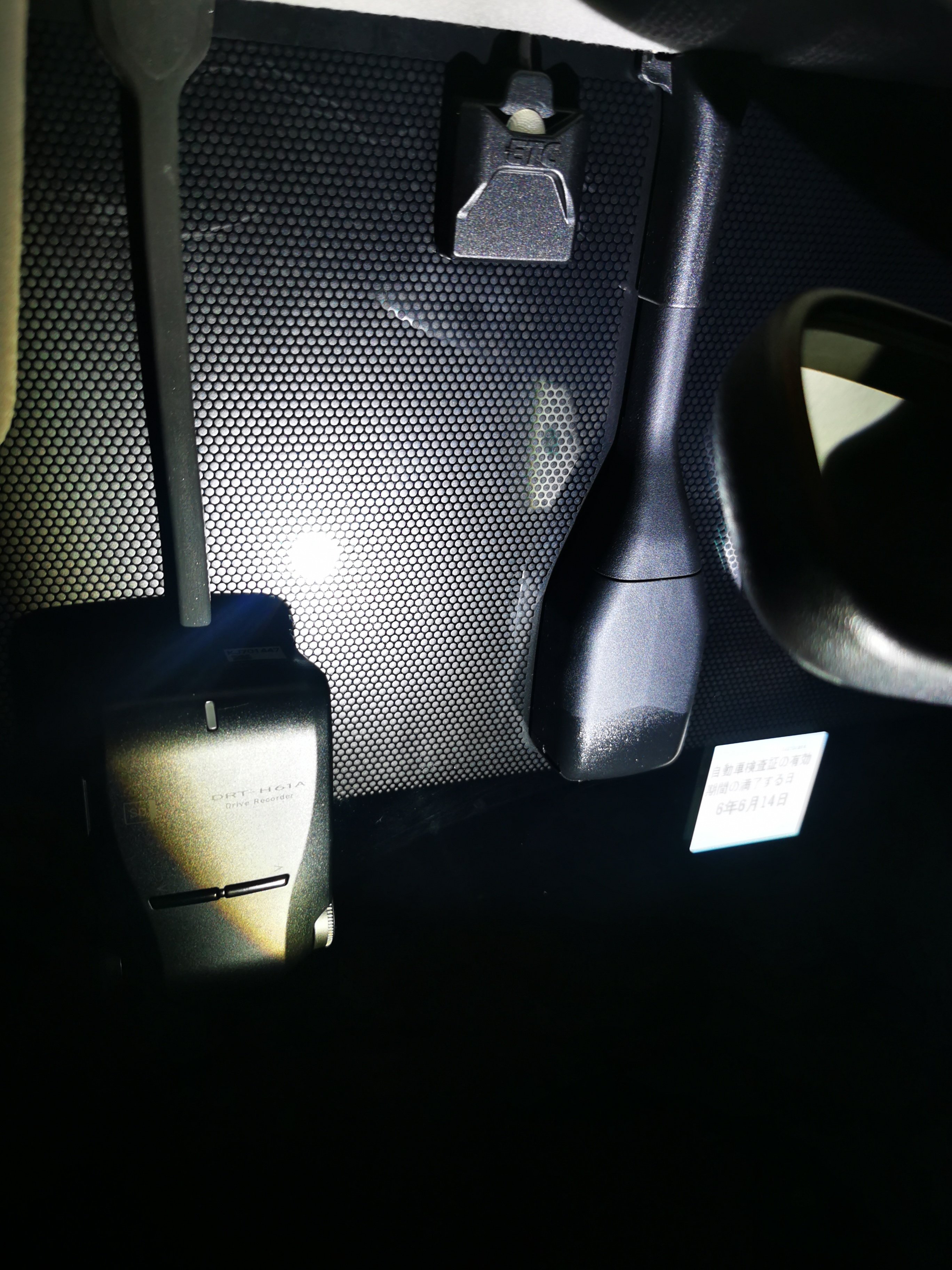

I also have the Toyota dash cam but shows no signs of life, is this anything to do with the new android head unit?

What does it look like?

It has dawned on me that this dash cam works in conjunction with the original head unit and sat nav, possibly getting its power from it as well and may not now be connected to anything...
In fairness, image quality of dashcams is vastly improved since the DRT-H61A days.
It originally without hedge connected to the AUX screen on the headunit, and pressing the button on the right on the dashcam would allow you to see the image and browser, whilst the parking brake was on.
If you still have the connector hidden behind the headunit, it's basically a RCA composite setup, so you could get it working again if you have a video input on the new headunit.

According to the very large book (for a dash cam) that came with it, it is supposed to be able to connect to the wifes phone but zilch, so I assume it was not re-connected when the head unit was changed just as they also 'forgot' to put the gear selector light socket back in as well because that doesn't illuminate either 😒
