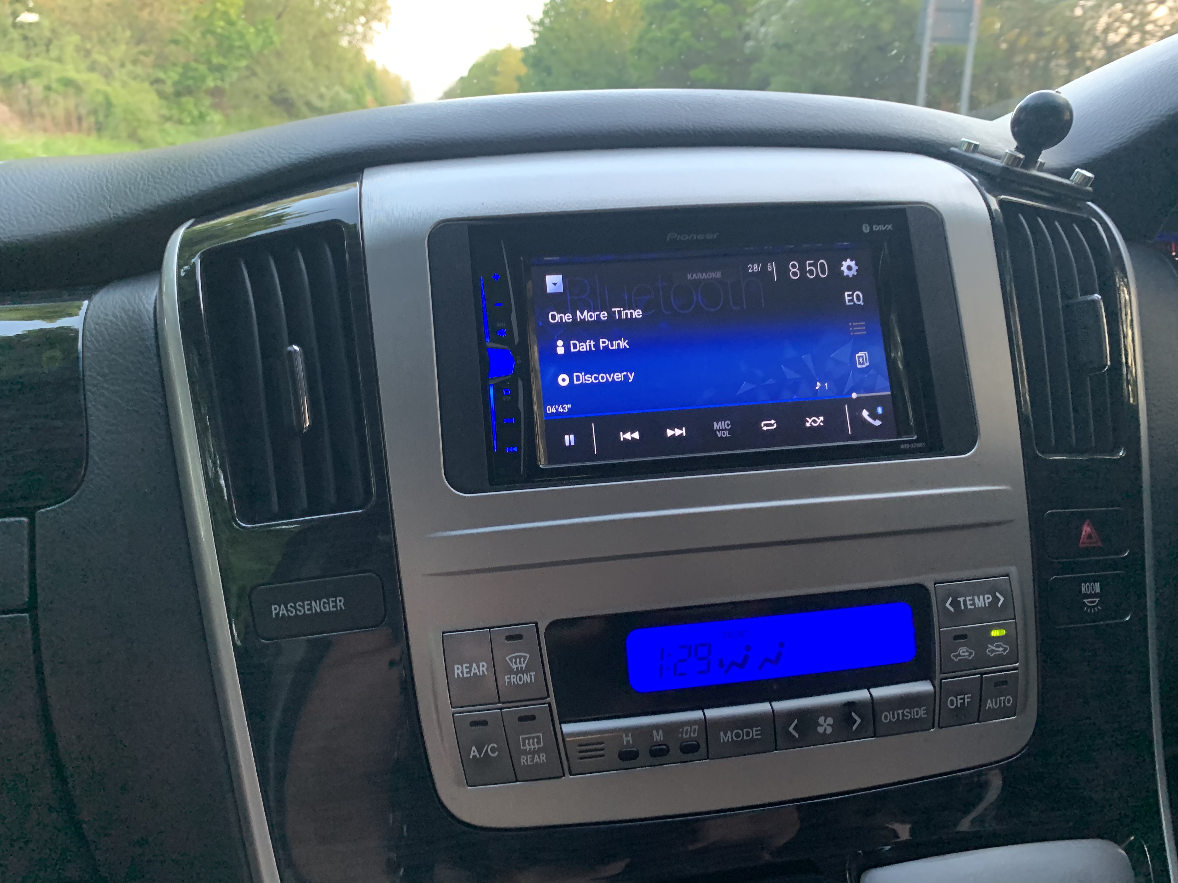

Well I’ve just completed a UK double din radio install and gotta say it was a total pain the ar5e to do and ended up costing a lot more than I expected. I installed a Pioneer double din unit, decided not to go for Apple CarPlay; the unit cost £130 delivered ex-display model in v good condition with all original kit. I then bought steering wheel controls + fascia kit for £35. I thought that would be all I need. What I had not budgeted for was £95 for a cable to enable the OE reversing camera and £85 for a new fascia panel which takes a double din unit (the original was bigger than a double din). The camera works but it does not show the reversing / guide lines and I cannot use the camera except when the vehicle is in reverse (the pioneer unit does support use of camera at any time but I assume the power for the camera is linked to the reversing light; both of these are minor irritations. The fascia panel also came with a nice double din insert so I didn’t need to spend the extra tenner with the steering wheel controls. The steering wheel controls only deal with volume, track and mode, I.e. just the left hand side, they don’t deal with anything on the right side of the wheel. No big loss there ... I’m not convinced it’s even worth £25 to retain any steering wheel controls anyway. In fitting the head unit the original brackets needed adjustment to get the front of the unit at the right depth; I have a pillar drill for this task but still took a few attempts to get it right. Lots of spare cables and connectors at back of stereo now and even managed to remove some dud ones entirely. Whilst at it I changed all leds for fresh blue ones (cos it looks cool ... maybe), I had a couple of dead leds in there so needed to do something. I also removed the cigarette lighter and replaced with a really nice double USB charger + voltmeter with on/off switch (important to have the switch as usb sockets can drain power if on even if not charging). Managed to install new microphone for hands free calls on sun visor with the wire neatly tucked away. The stereo also has usb connection in the back so I have a usb extension plug which also charges router via the ashtray, looks good and neat. Didn’t bother with DAB as can broadcast from iPhone via Bluetooth.
Total cost for all of this, including leds, about £350 and several hours of, at times, frustrating work. Nowt broken! Was it worth it? Maybe ... time will tell, but if in doubt I would recommend just using that little kenwood unit recommended above for about £90. If you keep the vehicle or want something neater then maybe take the plunge on this expensive and awkward I srt all. Note, much cheaper and easier is not retaining camera and not need a new fascia panel.

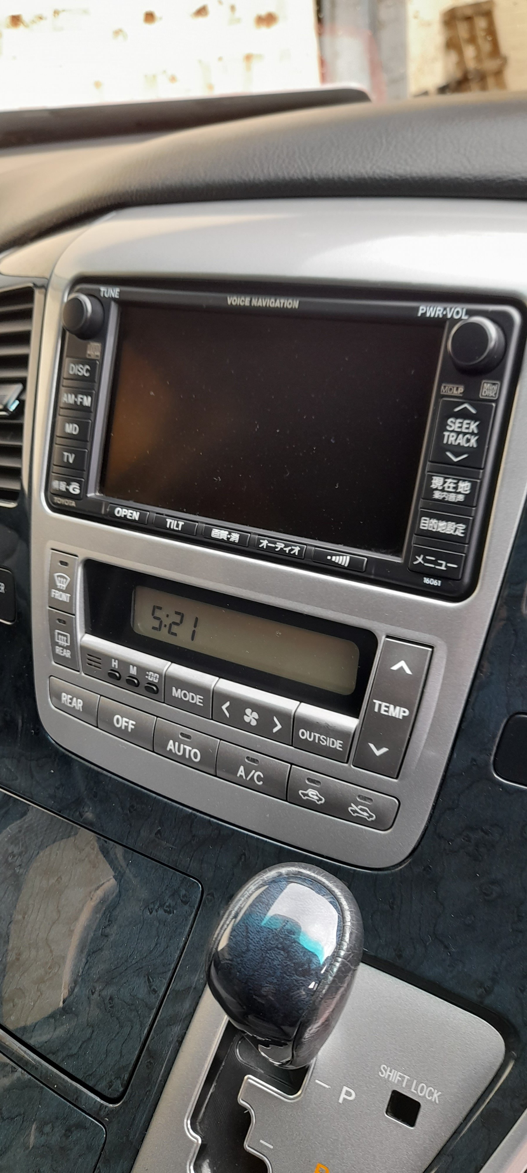

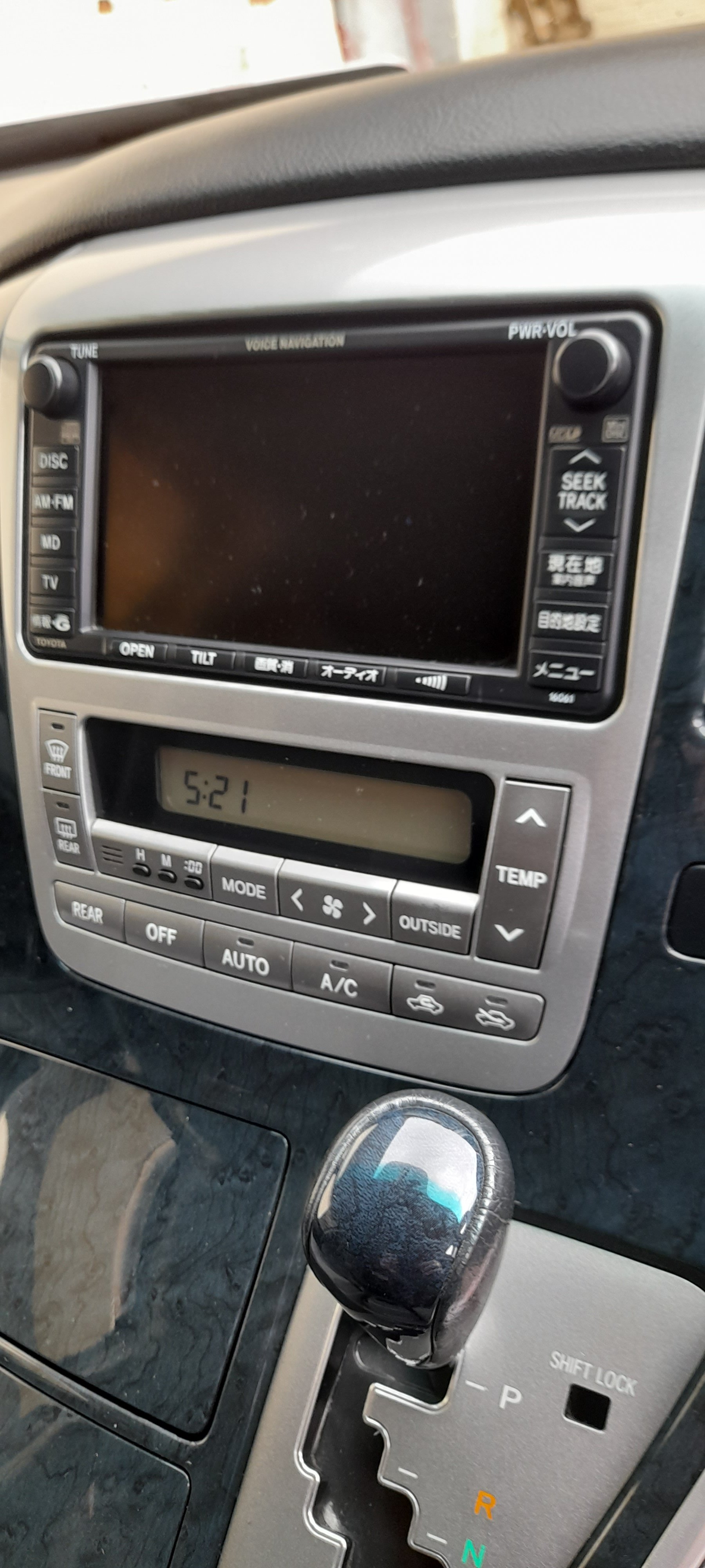

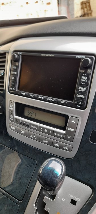

Mine doesn’t have cameras etc. I just want something bog standard that I can connect my phone via Bluetooth.
is there a dongle or adapter that’ll connect to the 2003 unit?
