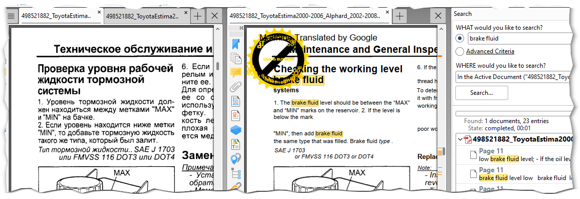

Below is what to expect in the end result. On the left is the Russian original. On the right is an English, searchable PDF but with watermarks in the corners of every page from the free version of the PDF tools. If you can’t tolerate the watermarks they can be removed by purchasing the PDF tools for £70.

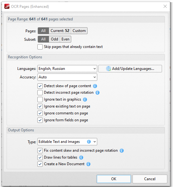

  • On the 'Convert' tab, click 'OCR Page(s)'.
  • Click 'Add/Update Languages...'.
  • Click 'Russian' then 'Proceed'.
  • It should be the default but make sure to select ‘Editable Text and Images’ as shown below. The other settings are optional. You might have to experiment with the accuracy if you find any problems.
  • Select 'All' pages then 'OK' to process the whole document.

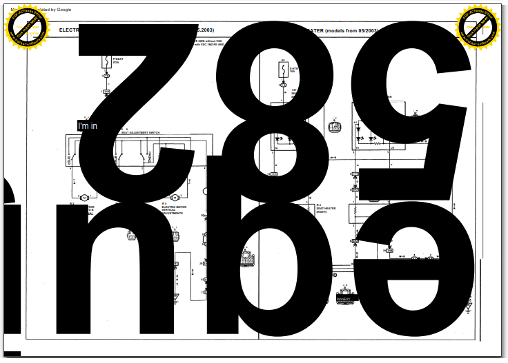

Some of the pages, especially wiring diagrams, may be screwed up. For example:
In this case:
  • Click the 'Home' tab -> 'Edit Text', click on the incorrect text and hit delete.
  • Save the document.
