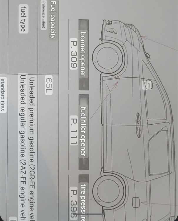

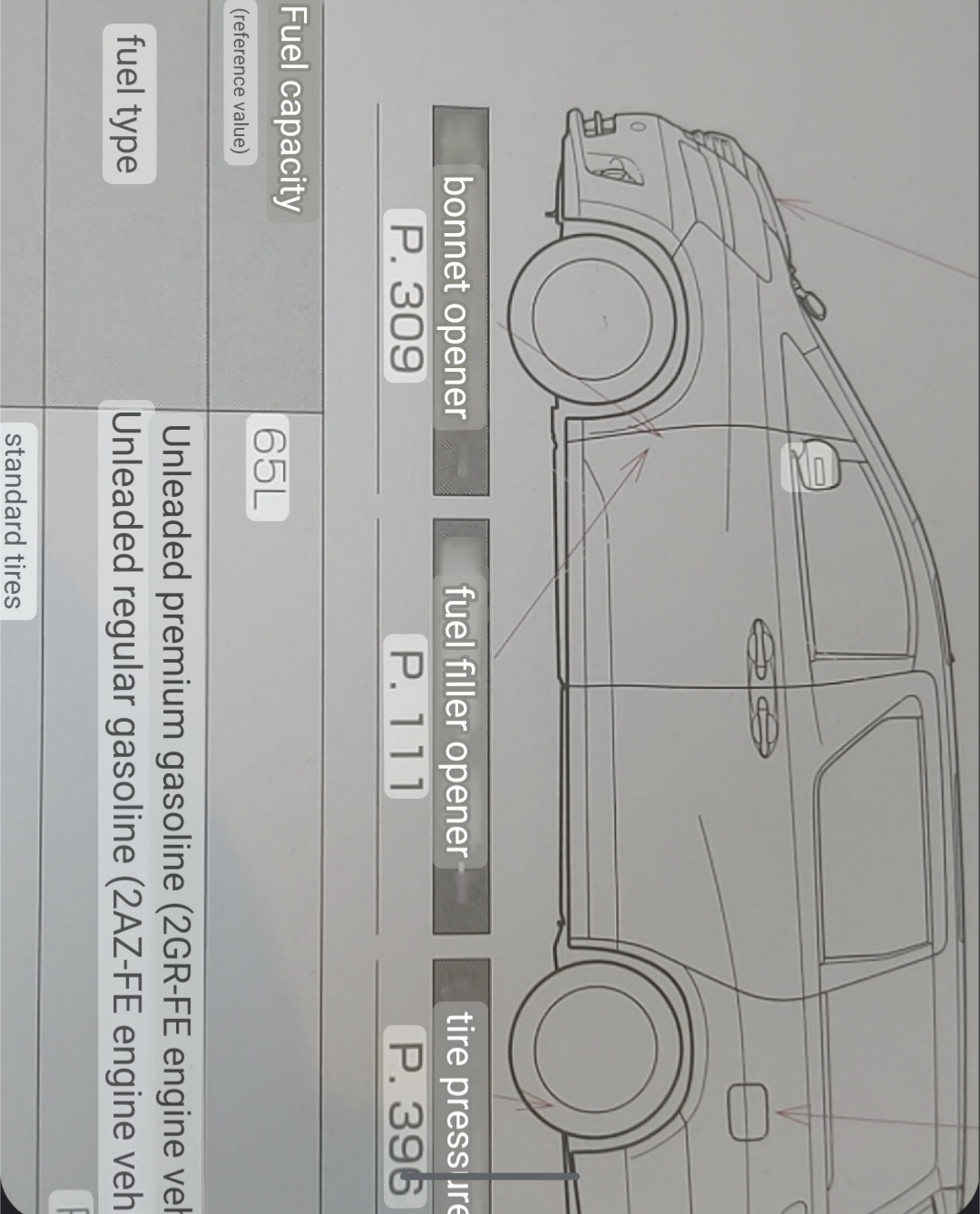

Just had a look in my owners manual and with the use of Google translate it's got a 65l tank..... that's 10l left when the dash said zero!
Also proves regular E10 fuel is ok!
