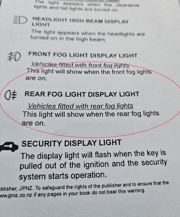

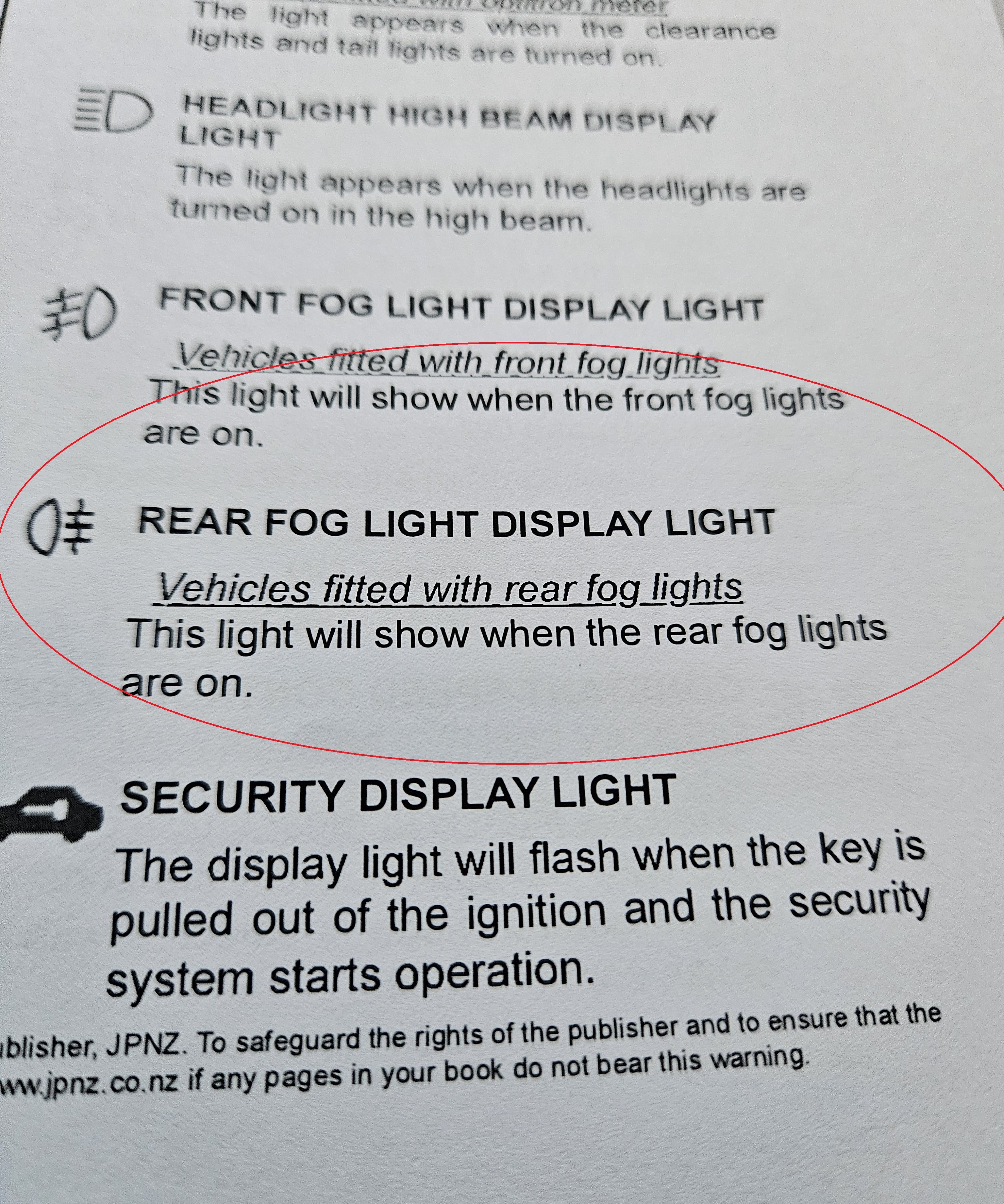

rear fog lamp warning light as you maybe aware alphards have a fog lamp fitted to meet iva regulations normally there is a switch added to work the fog lamp it seems yours has this light on dash mine dont just checked i think you got a bad earth some where or your importer has fitted fog lamp and some how triggard this light on your dash i have atatched a photo from my hand book and circled in red. what you need to do is get some one to stand behind your vehicle see if fog lamp comes on when they press the brake peddle
