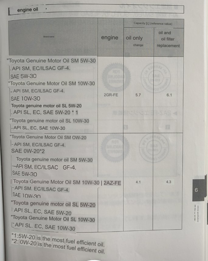

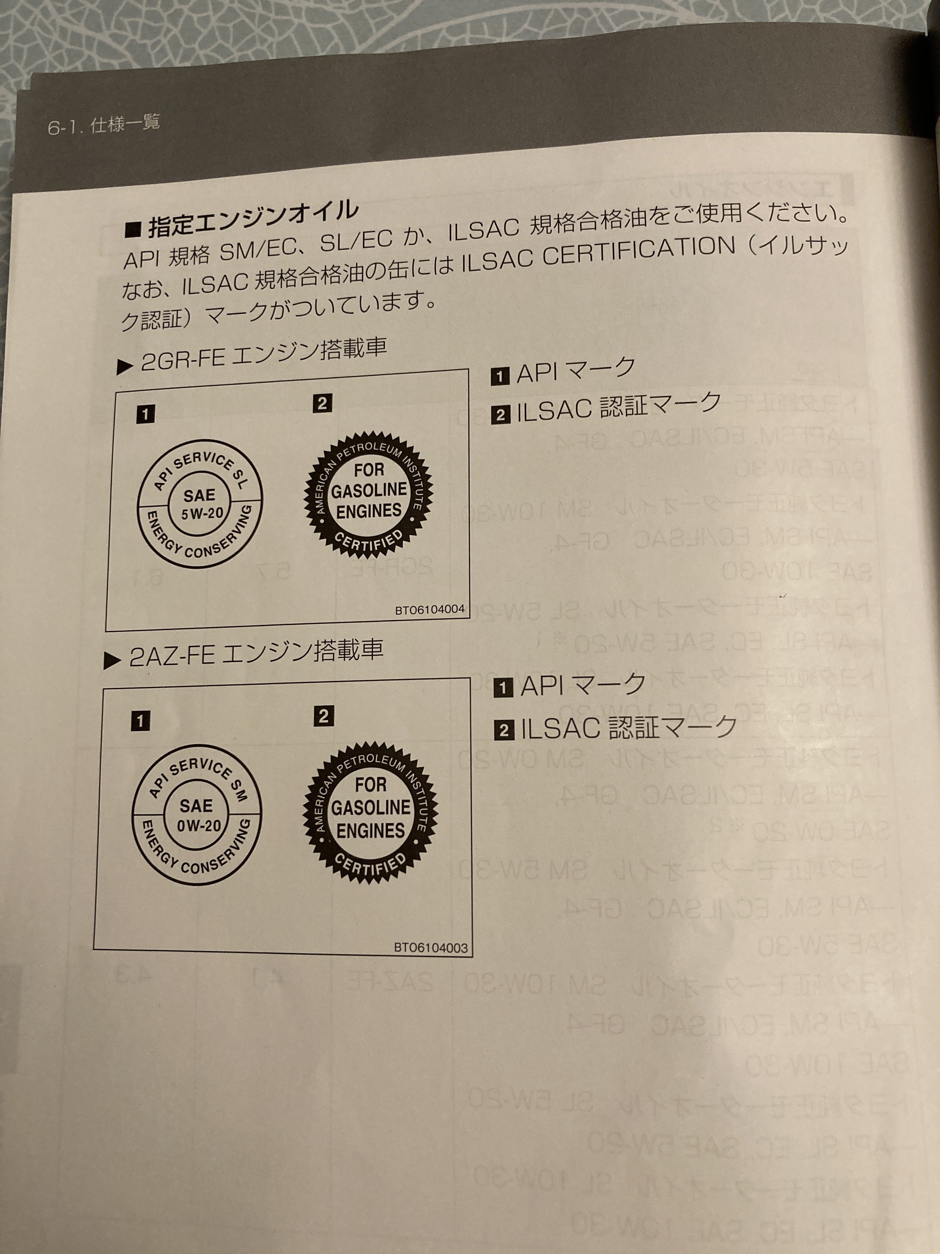

The manual mine came with recommends 5W-20 for the 2GR-FE (3.5 litre),
or,
0W-20 for the 2AZ-FE (2.4 litre).

I did some research on club here and only see recommendations to use 4.7 litres for 2.4l engine not the 3.5l engine. The Toyota club net website say it should be 6.1 litres with filter. I think the dip stick is not accurate. For bigger engine it should need more oil than the 2.4l.
The manual states 6.1 L with a filter change, but there will always be some oil left in the engine even after you’ve drained it. I only got 5 L in.

So long as the 5w30 oil for the Merc meets one of the specifications show in the manual above then it would be fine.
Oils, and engine design and emission control, have moved on quite a bit in the last 35 years. The weight of the oil is only one measure of the properties of that oil so I'm afraid that one 5w30 oil could be very different to another because of the additive mix, and whether it is mineral, semi-synthetic or fully synthetic. There is a specified standard that the oil needs to meet and this is what should compared in addition to the weight of the oil.
