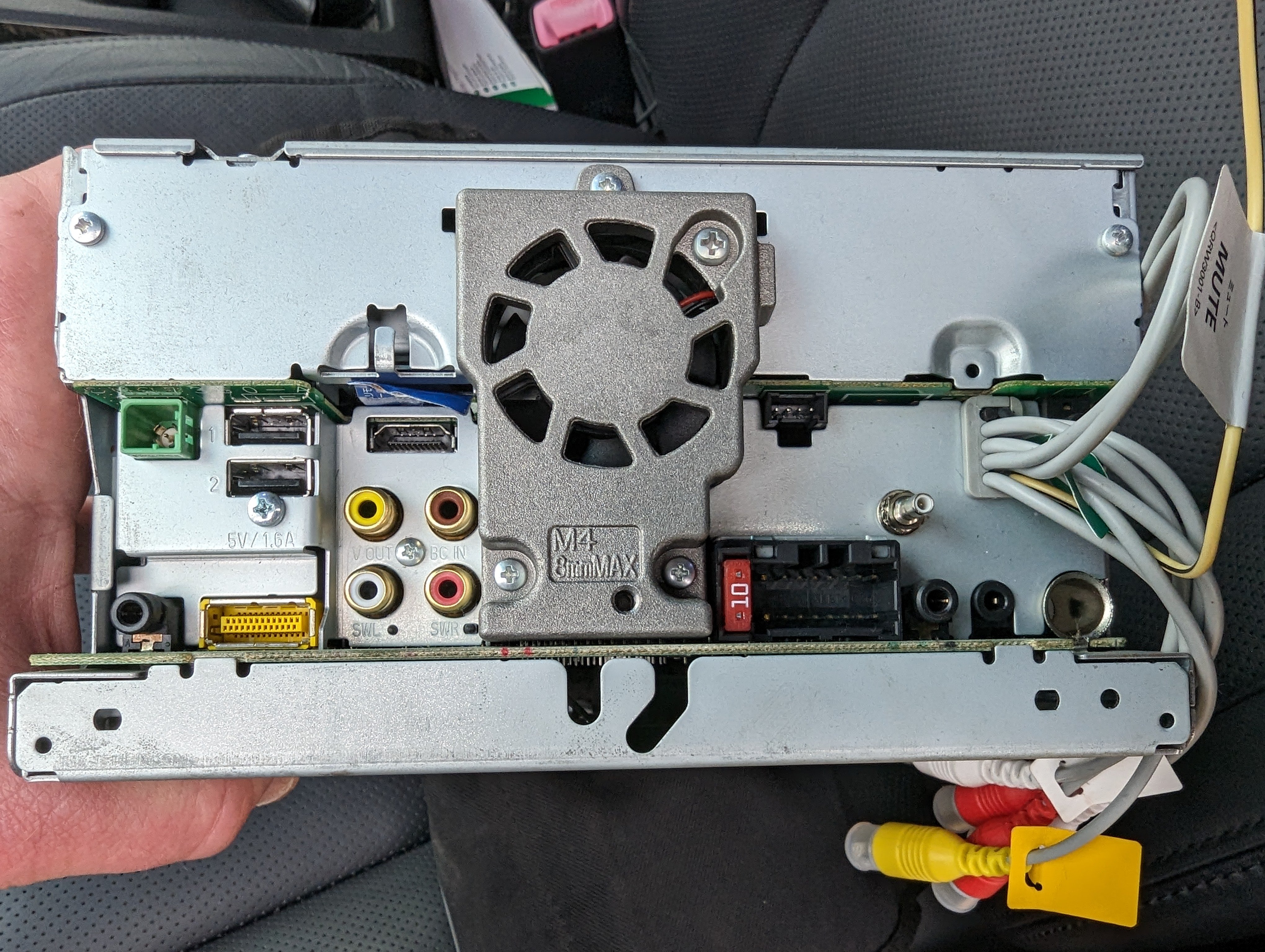

Steve81 Posted March 12 Share Posted March 12 I've recently taken delivery of a 2012 Vellfire which has the nhba-x62g head unit. I want to swap this for an aftermarket head unit. I've got a Pioneer AVIC F77DAB which I had in my old car which I'd like to use for now. Can anyone assist me in figuring out which adaptors I need to connect my Pioneer please? Pioneer... Original head unit Quote Link to comment Share on other sites More sharing options...

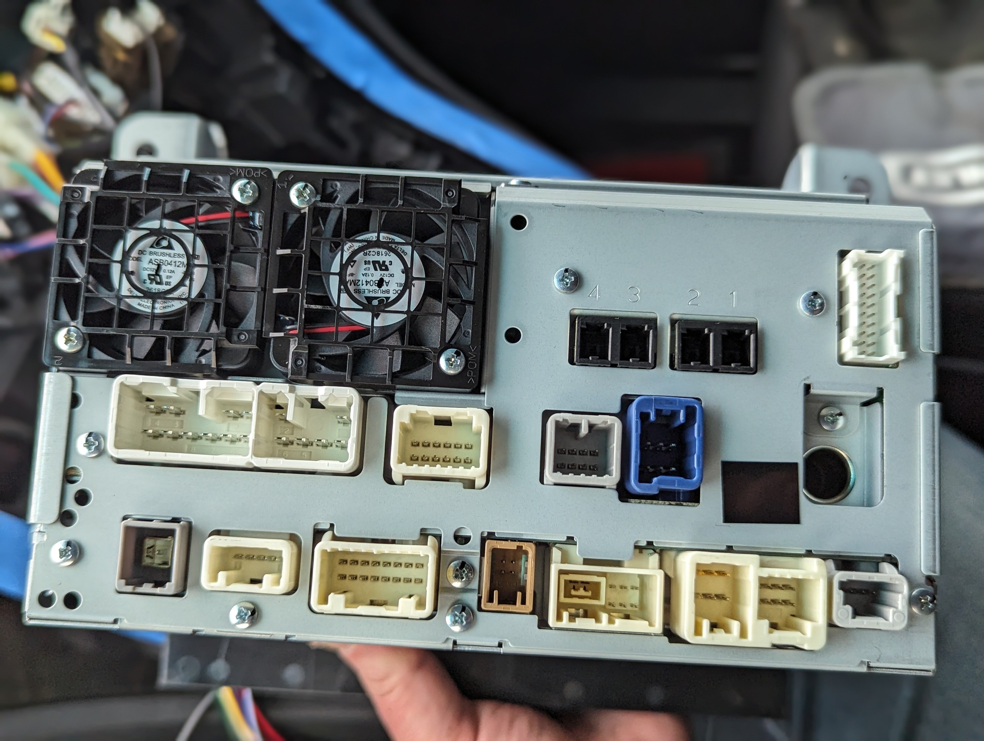

BilboJ Posted March 27 Share Posted March 27 Thanks for all replies. Having completley failed to interst ANYBODY in fitting this for me, I've concluded it's gonna have to be DIY. So... in good Systems Engineering fashion, rather than just buying looms and stuff, plugging 'em together and seeing if they work, I'll start by mapping out all the interfaces: does anybody out there have any diagrams for the rear of the NH3T-W56 Head unit - specifically the pin outs on each of the connectors? I've had a trawl online but can't find anything. (I can't be the first to encounter this problem....) Quote Link to comment Share on other sites More sharing options...
Sorin Posted March 29 Share Posted March 29 On 3/27/2024 at 7:01 PM, BilboJ said: Thanks for all replies. Having completley failed to interst ANYBODY in fitting this for me, I've concluded it's gonna have to be DIY. So... in good Systems Engineering fashion, rather than just buying looms and stuff, plugging 'em together and seeing if they work, I'll start by mapping out all the interfaces: does anybody out there have any diagrams for the rear of the NH3T-W56 Head unit - specifically the pin outs on each of the connectors? I've had a trawl online but can't find anything. (I can't be the first to encounter this problem....) Hi, I believe @Chris.ac might be able to help you with access to an online platform for this. Can you send a pic with the back of your pioneer? Quote Link to comment Share on other sites More sharing options...
Chris.ac Posted March 31 Share Posted March 31 You should probably post in the 10 series section of the forum. Some people there have copies of the wiring diagram books Online resource is there too, it's in Japanese, but anyone with the will to use Google translate can convert the pdf diagrams to English. 1 Quote Link to comment Share on other sites More sharing options...
