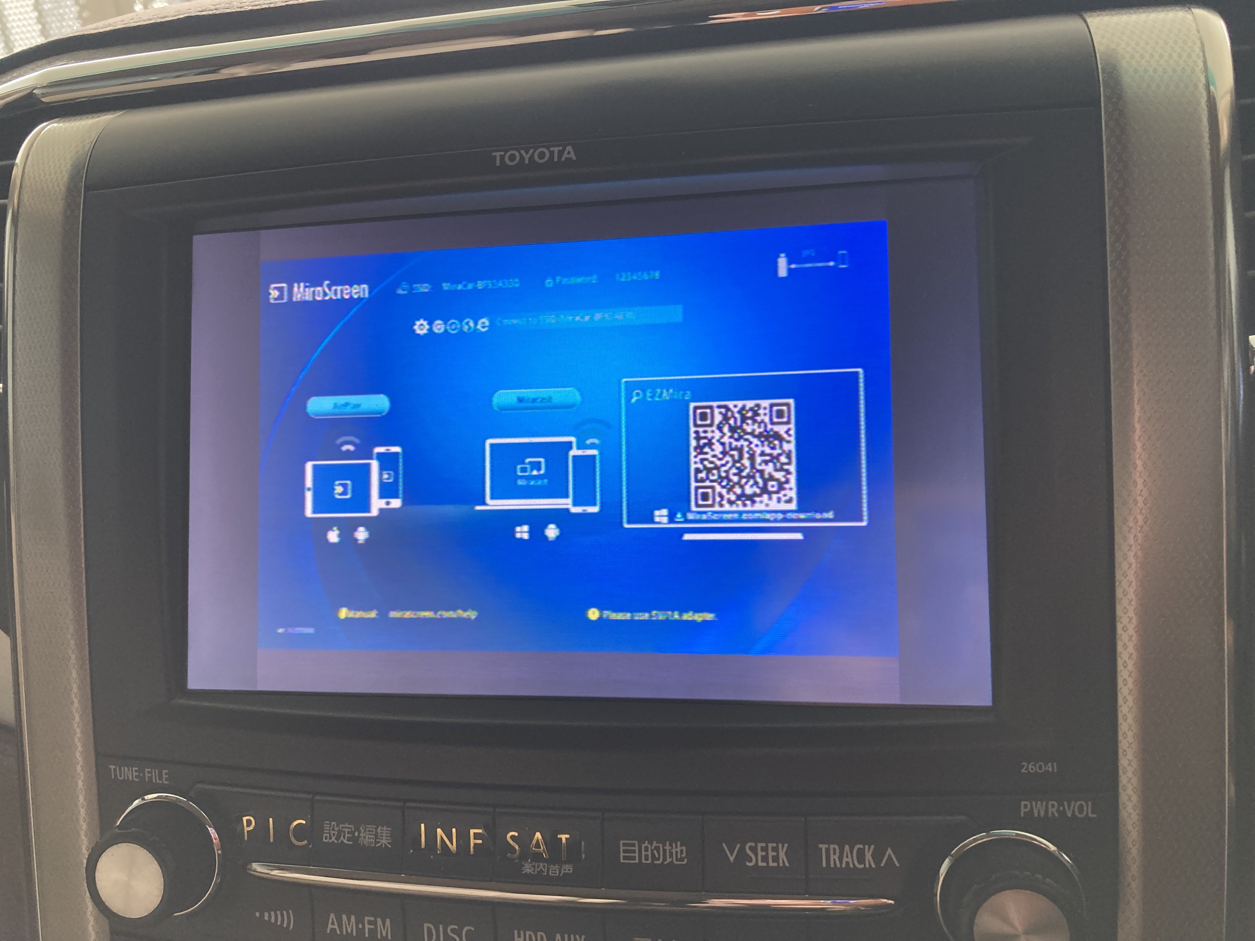

i have a mirror cast device with RCA output connected to the vans input sockets you can then steam everything from your mobile to both screens including sat nav youtube that way you can utilise the vans excellent sound system without the expense of changing the head unit with all the cost and loss of some functions that involves mine cost $35 Australian dollars from china works really had it 2years no trouble runs off USB socket.

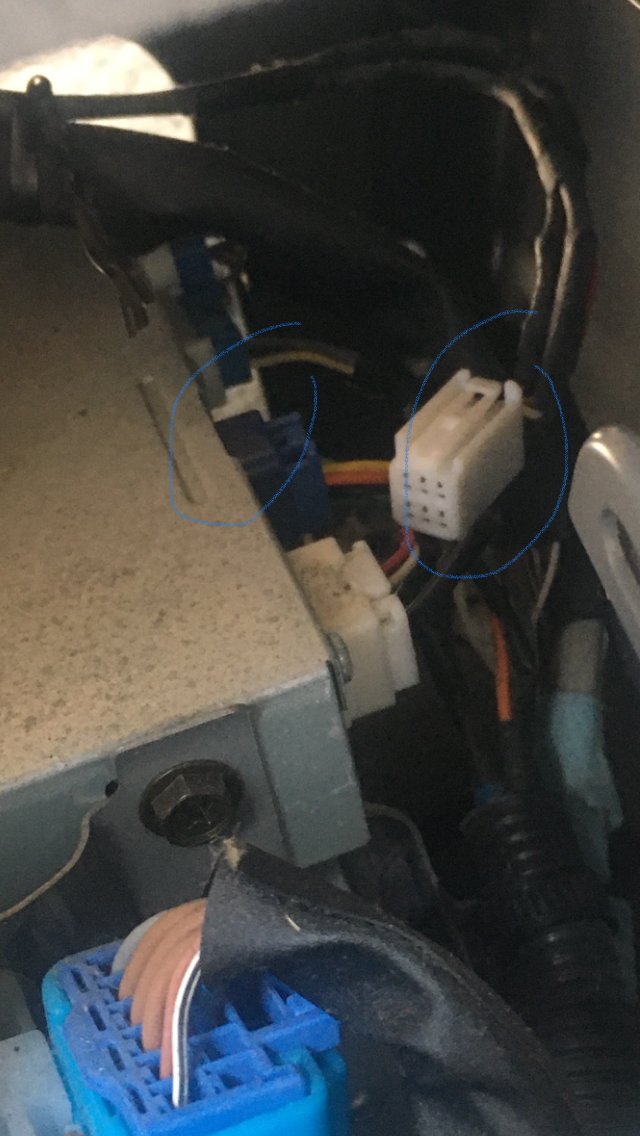

I’ve just got Alphard and was hoping to play music from my phone using the RCA inputs in the centre console. But I was getting an error message when selecting the Video input on the head unit. I swapped a couple of plugs around, under the passengers seat, the white one must have been for the old TV tuner and plugged the blue plug back into its place. The inputs are now working and I can play music from my phone and it sounds awesome!

Just look at my previous post and use a mirror cast device that outputs component then steam from you phone to the mirror cast device which you plug into the component sockets behind drivers seat works a treat on both screens.
