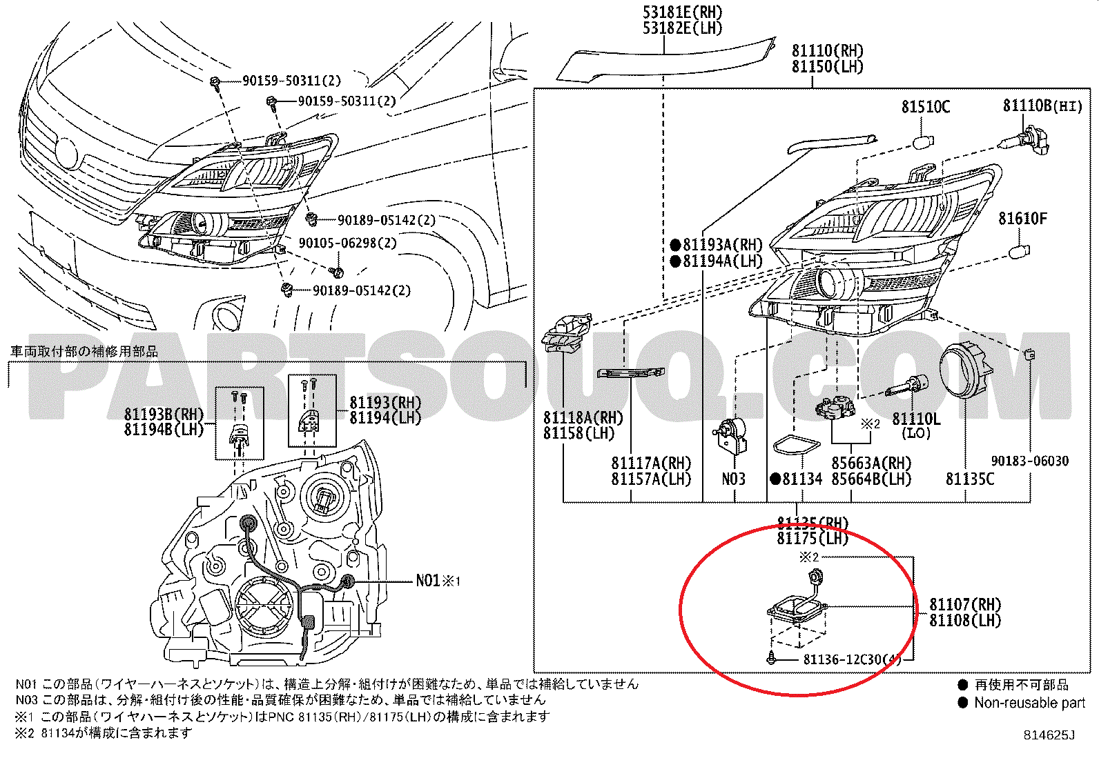

Thanks for your response. The lights work perfectly when initially switched on but as stated the nearside light goes off after a short while. The garage attempted to follow through the system but could not identify the ballast resistor to get an identification part number. So again any help in this direction would be gratefully received.

Update: Many thanks Lee, your assistance has proved invaluable as my garage is not use to imports and had difficulty in finding the ballast resistor. All fitted now and appears to be working but will monitor to see if the fault returns. Once again thank you.

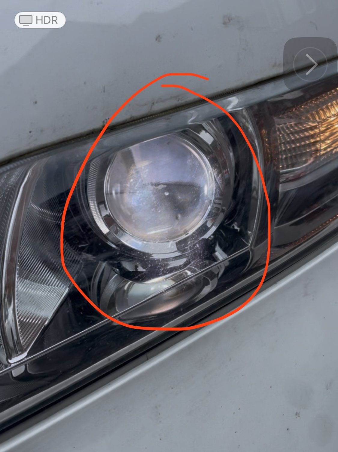

@NickC I've got a 2008 vellfire and I'm just having the exact same problem with my F/N/S headlight. Can I please ask you;

@Beds Vellfire Hi Mark, looking back in the records I could find, I purchased the ballast resistor from Auto Japanese Spares, Coventry for £131.10. My local garage charged £180 as they had problems and took longer than anticipated. If you either do it yourself or have a garage that may be familiar may lower that cost.
