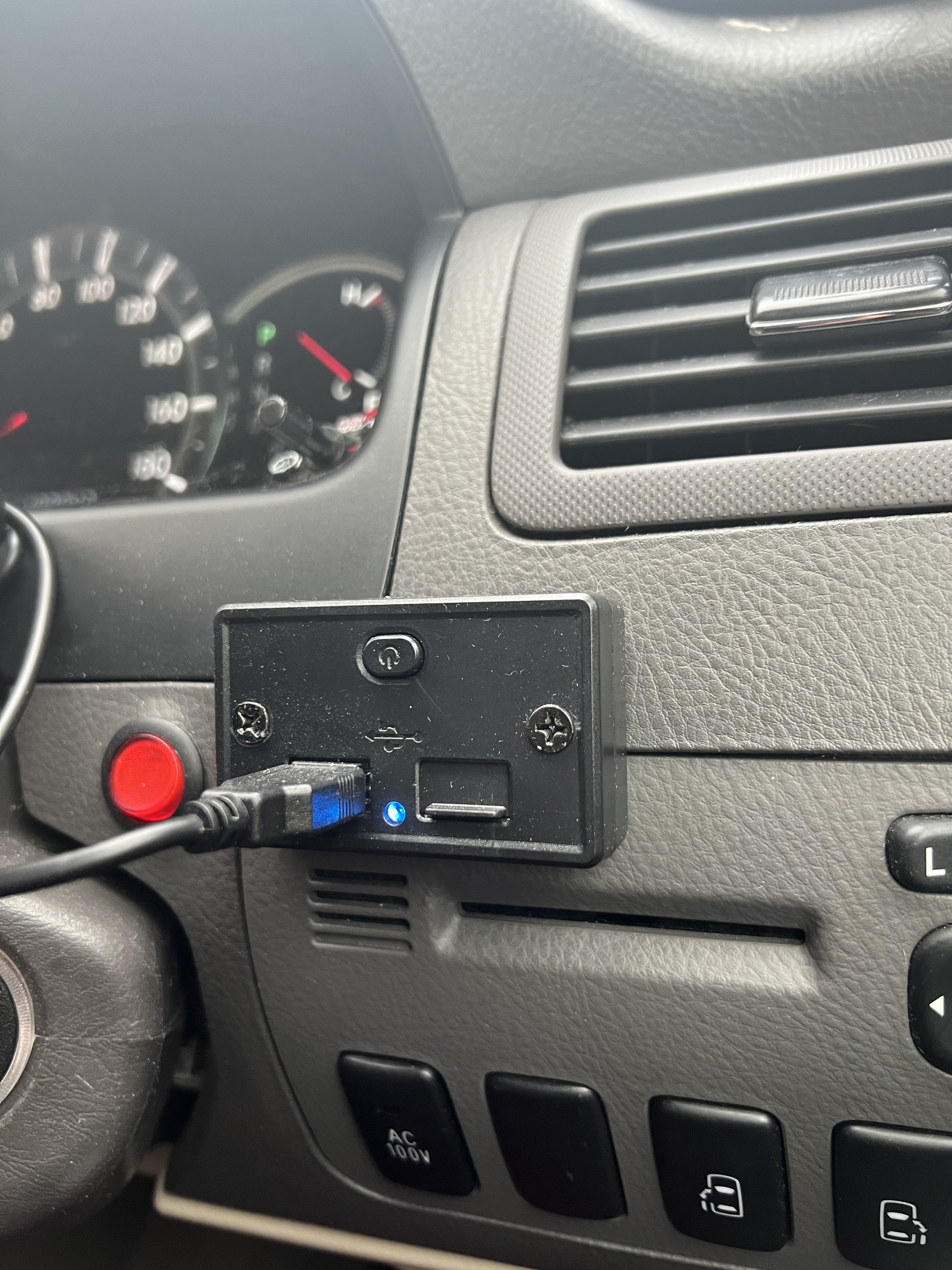

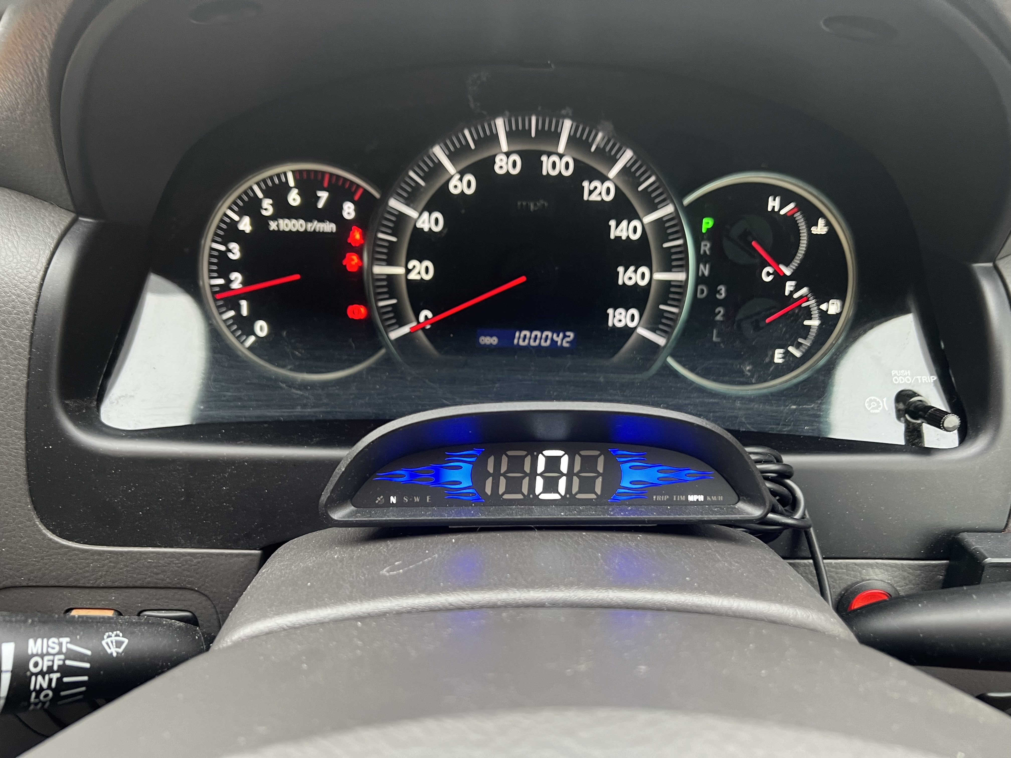

Good evening, I had a similar speedo fault on my 2007 2.4 Alphard and after changing several sensors found the fault to be the retrofit chip fitted to the speedo to convert Kph to Mph and so I reconnected the original wires which gave me Kph speed and Kilometre odometer. I used the power supply to the chip to power a new USB socket and fitted a GPS Mph speedo from Amazon. It works really well, easy to fit and everything cost less than 40quid.
Alternatively, you could fit a new chip, a few available from £30 to £90.
See the pictures, hope this helps.
