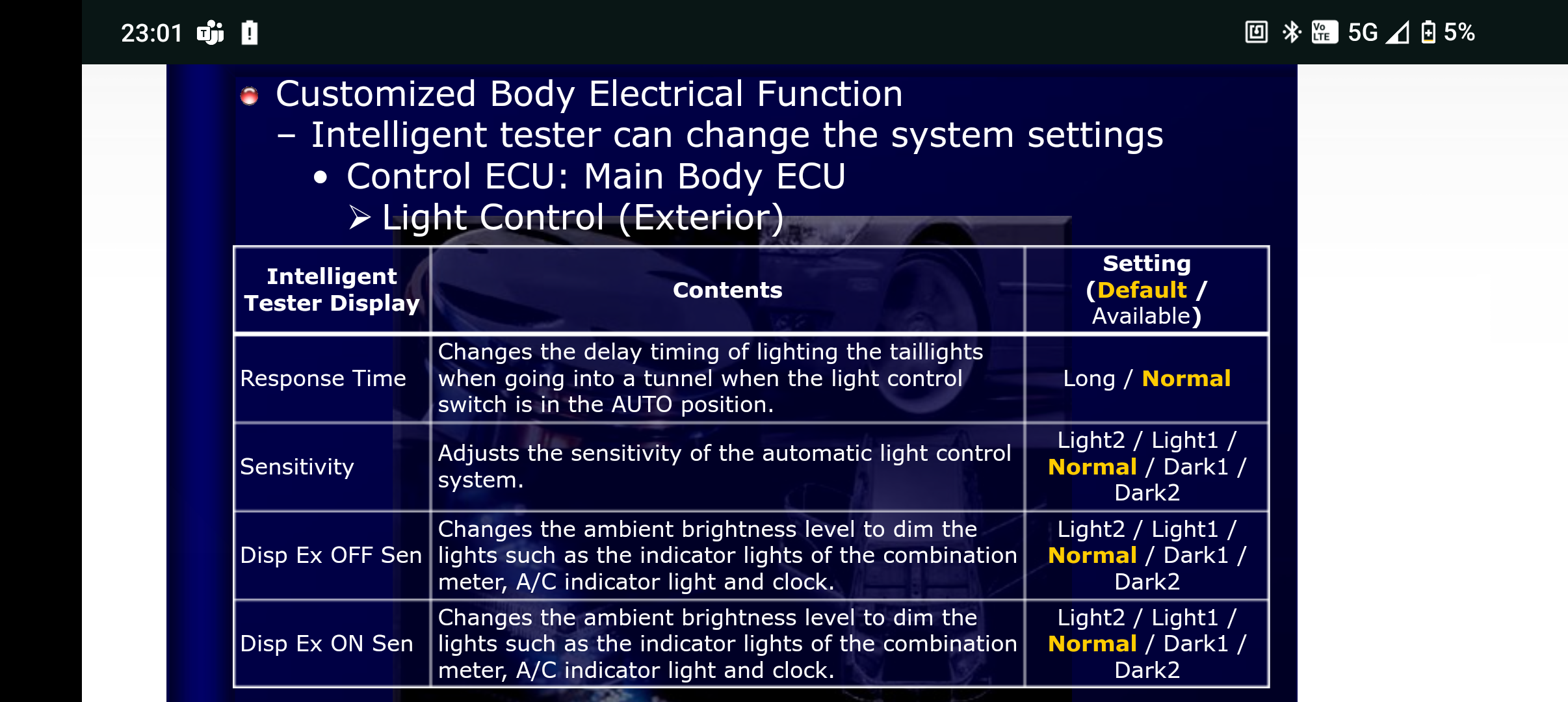

Techstream, or the Android/apple app 'car scanner' with a Bluetooth obd2 dongle will allow you to adjust the delay before lights turn on or off, there is also 5 sensitivity settings, although those seem to have very little effect.

Just wanted to say thanks, also to Picasso and Voodoo101, got the OBDll dongle today, plugged it in, downloaded Car Scanner which allows you up to 3 alterations for free, changed the sensitivity and delay timings, not bad for £3.70, saved me a small fortune I'm guessing on taking it into Toyota. Haven't tested it yet, waiting until it gets darker out but again wanted to say thanks and what a great community here 👍🏻

Just to confirm all changes are great, just been out and lights come on a lot sooner 👍
