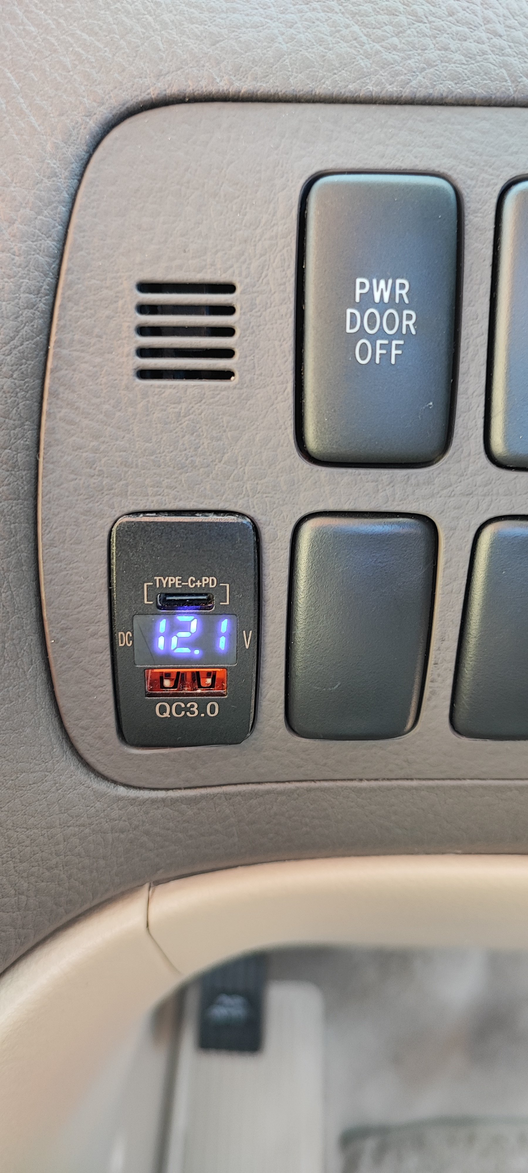

I fitted this usb/12v socket/ battery display (ebay) which works perfectly for us. As in the above post we have a separate power source when engine isn't running. You do have to cut holes in the cubby lid and tidy up wiring underneath but there are easy access live and earth wires to splice off. Just make sure you fit an online fuse. Passengers love having the usbs!  Just for info for anyone else and at the risk of hijacking the the thread,  the red & white phono plugs below have a usb c at the other end which allows me to play Spotifyfrom my android phone through the video function on the head unit..sounds20250313_094341.thumb.jpg.9e52bc9c639ceac2ff1e07c0f5516566.jpg great too!

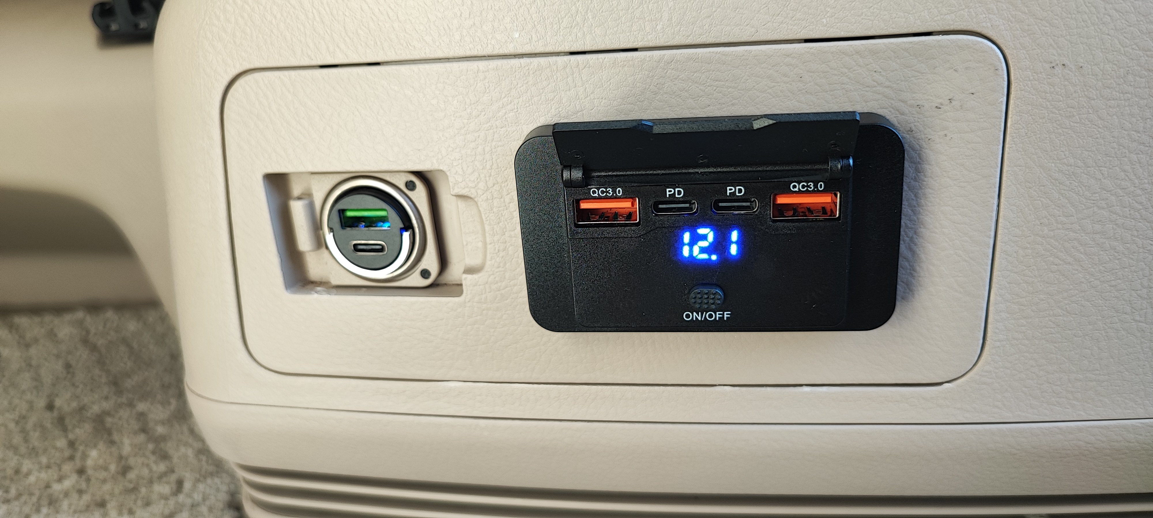

So during the week I got around to fitting the cigarette socket. I bought a cigarette socket extension and cut the plug off, wired into the unused heated seats fuse with a 15a fuse tap then ran the cable under the carpet after removing the plastic kick guards from both left hand  side doors. I then used strong double sided tape to secure it next to the cubby hole at the left rear hidden under the rear seat.
Works a treat, I may look into a more permanent fitting later on if I want to try routing the cable over the inside of the wheelarch.
I also connected the USB thingy taking a fused feed from the factory cigarette socket and running the cable under the carpet, sticking the module to the front of the centre console at floor level. This meant no drilling of holes anywhere to feel cables through.

I have done this with 4 outlet version - and also added a dual USB to a vacant switch position at the front.

I took a feed from the back of the cigarette lighter socket live and ground connections using an inline fuse and about a metre of cable suitable for about 5 amps of power.
Depending on where you want to place the module will determine the length of cable you need. I routed the wiring around the back of the glovebox and under the carpet to the centre console where I mounted the module with double sided tape.
