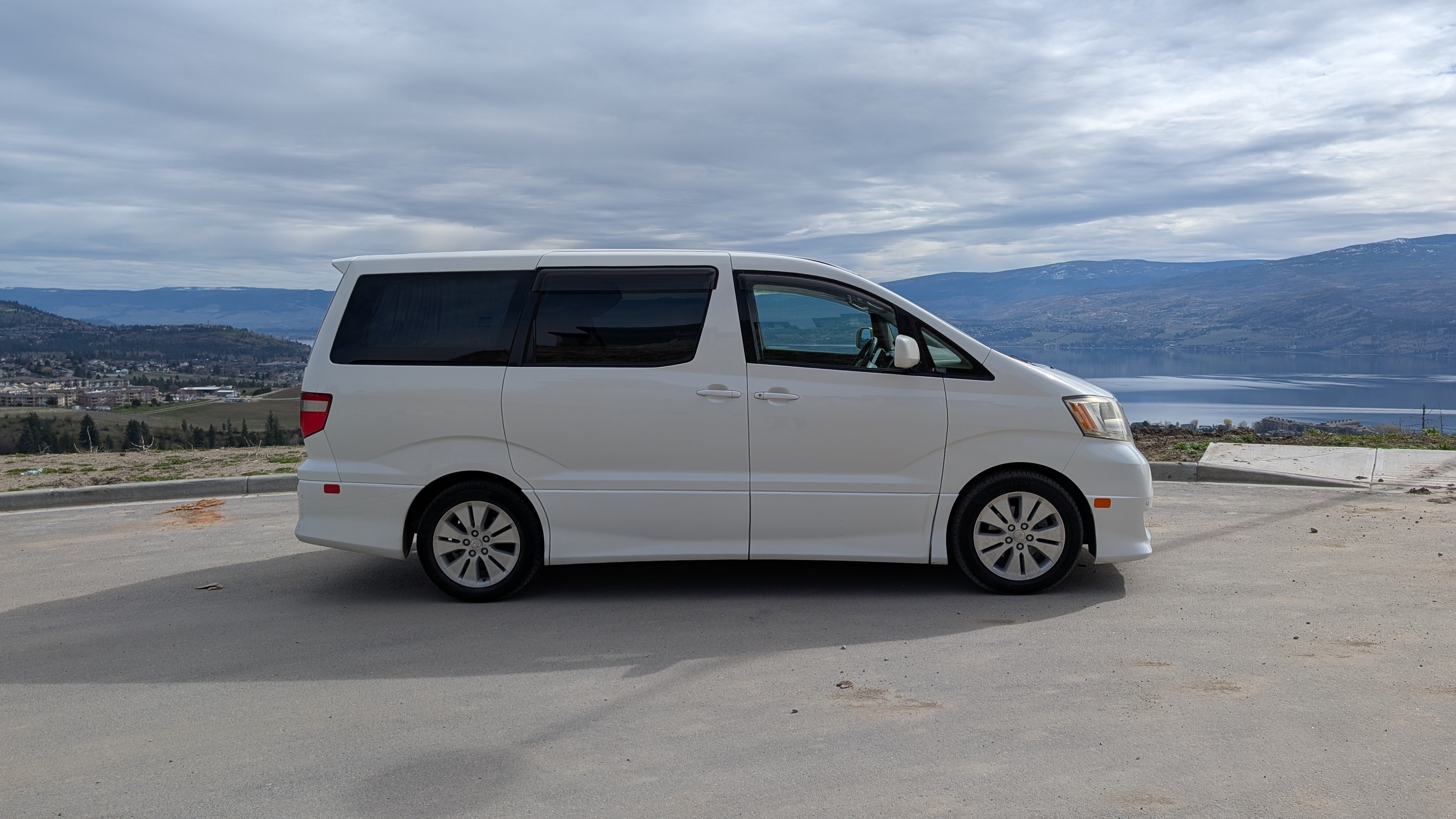

looking at your photo this Alphard has not been lowered so its standard suspension lot of owners in uk regret buying lowered Alphard's as we got lots of speed bumps and pot holes on our roads and to put a Alphard back to standard Hight your looking at £1200 British pounds
the kit on yours is a standard kit as with all Alphard's your Alphard has not been modified in any way its as it came out of the factory I personally leave as it is

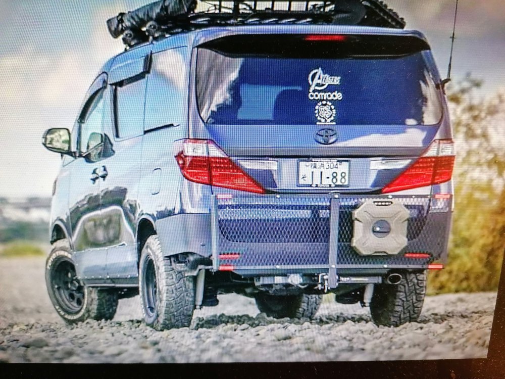

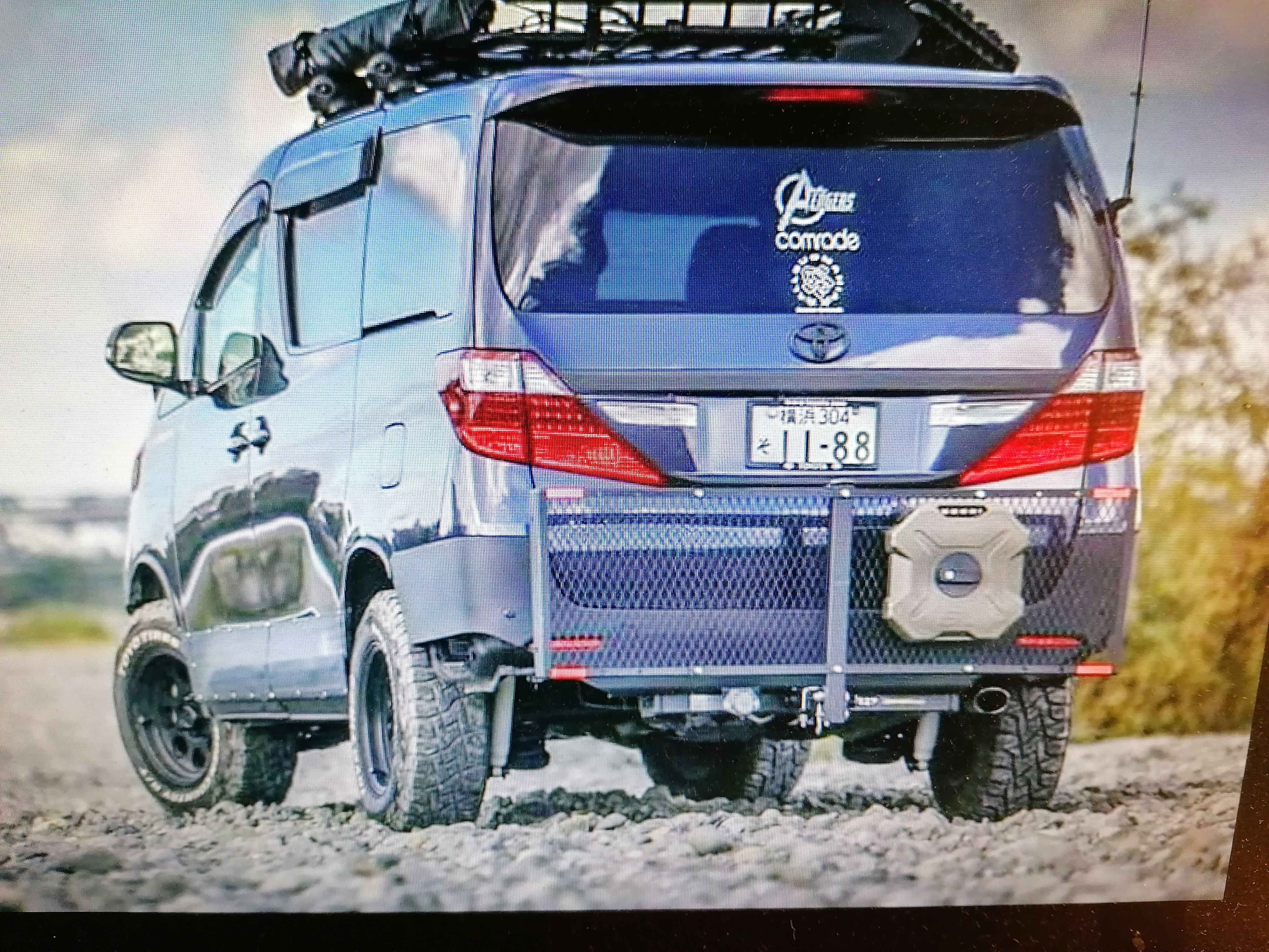

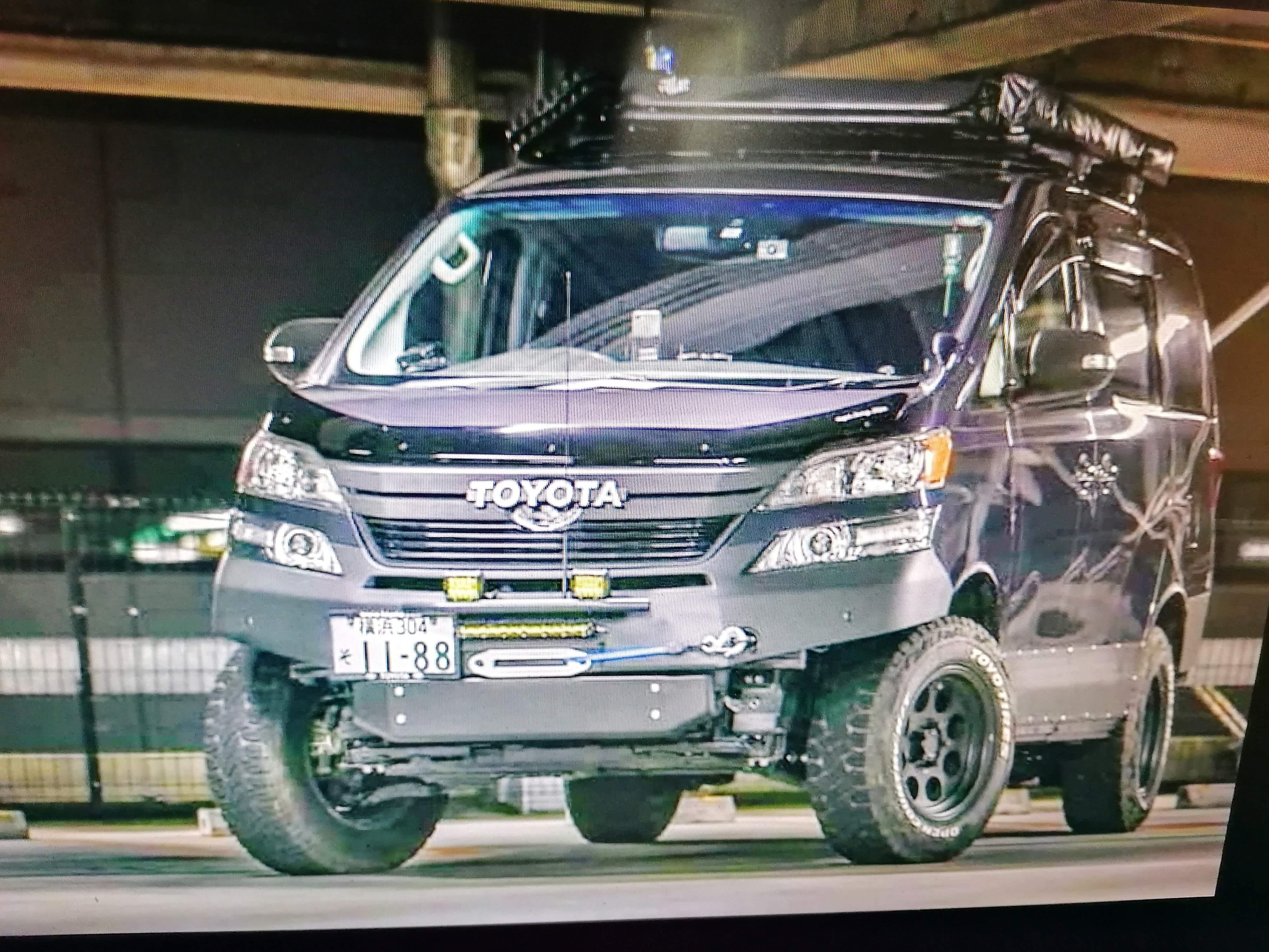

A person in russia has done it by removing the standard trim/bumpers, see pics. You can get lift kits on eBay, but the maximum is 40mm without putting undue strain on the driveshafts.

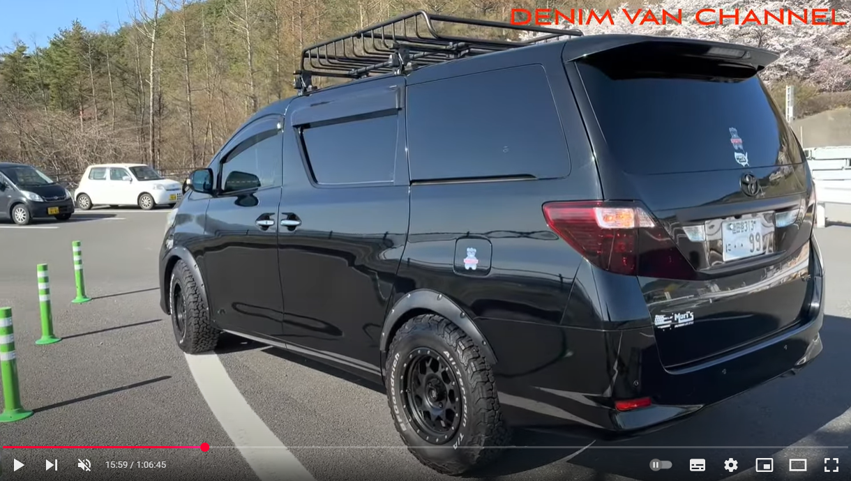

I am not interested in true off-roading but, instead, I'm interested in driving it on "good dirt tracks" like you describe. The outcome I'm looking for is that, because I live around the mountains and enjoy camping, I would prefer that this is able to go off road without breaking the trim.
I see this crazy Russian modification posted above and, while it's certainly pretty kick-ass, I wouldn't have anywhere to park that thing. There is a video I found on Youtube that reflects something a little more modest (attached), and better aligned with what I have in mind (an AH20 I believe, but nonetheless gives an idea of what I'm aiming for).

That looks like a standard body trim but seems to have been lifted slightly
