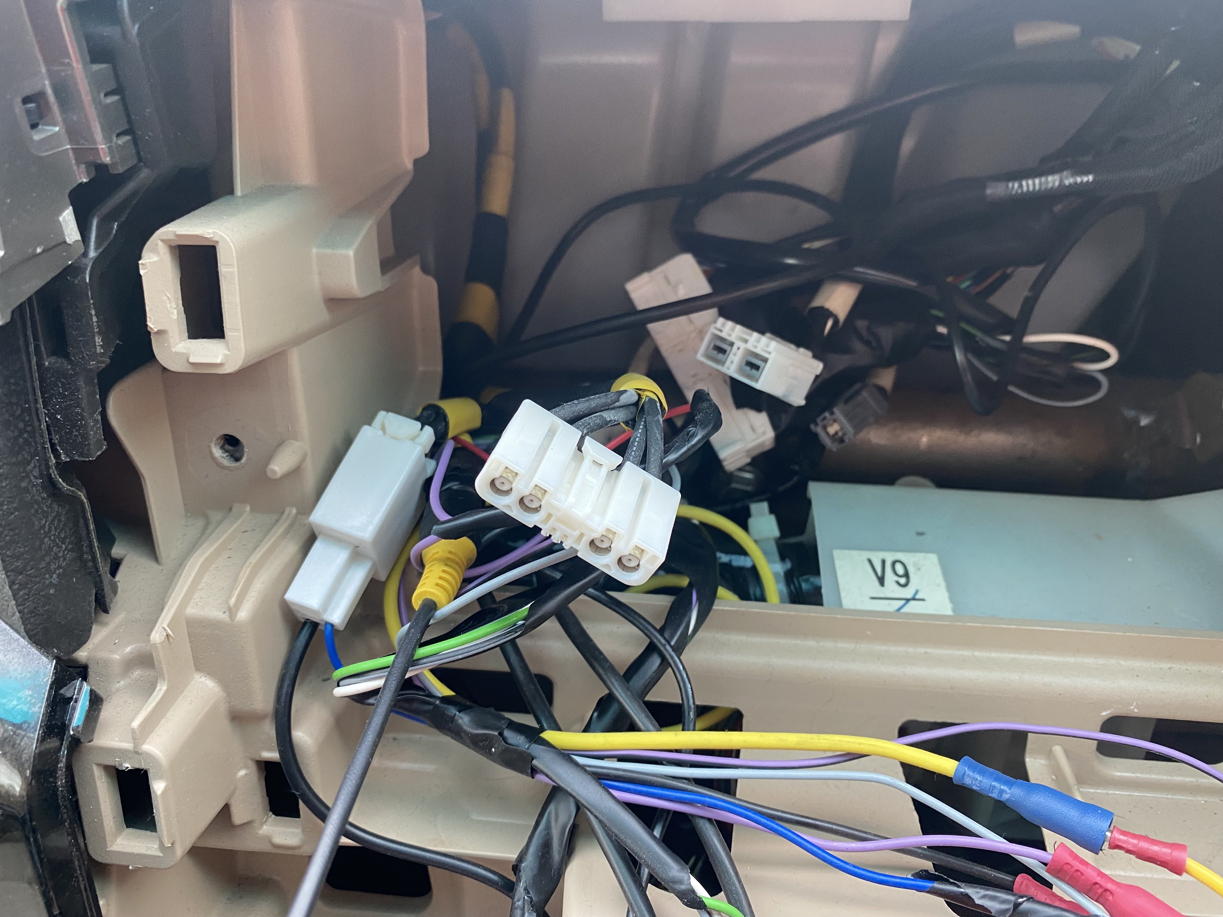

As the car had a replacement Android head unit in the ATH20 that wasn't working, I proceeded to swap it for one I had with carplay and looked around to see how it tapped into the speakers. Based on the info from this forum, I counted 17 speakers and a subwoofer under the drivers seat. I see the android head unit plug containing the speaker lines connected to a brown connector which I assume is part of a bypass cable leading to the area under the passenger seat. I haven't gone around testing what speakers emit sound although I have read the subwoofer is not used.

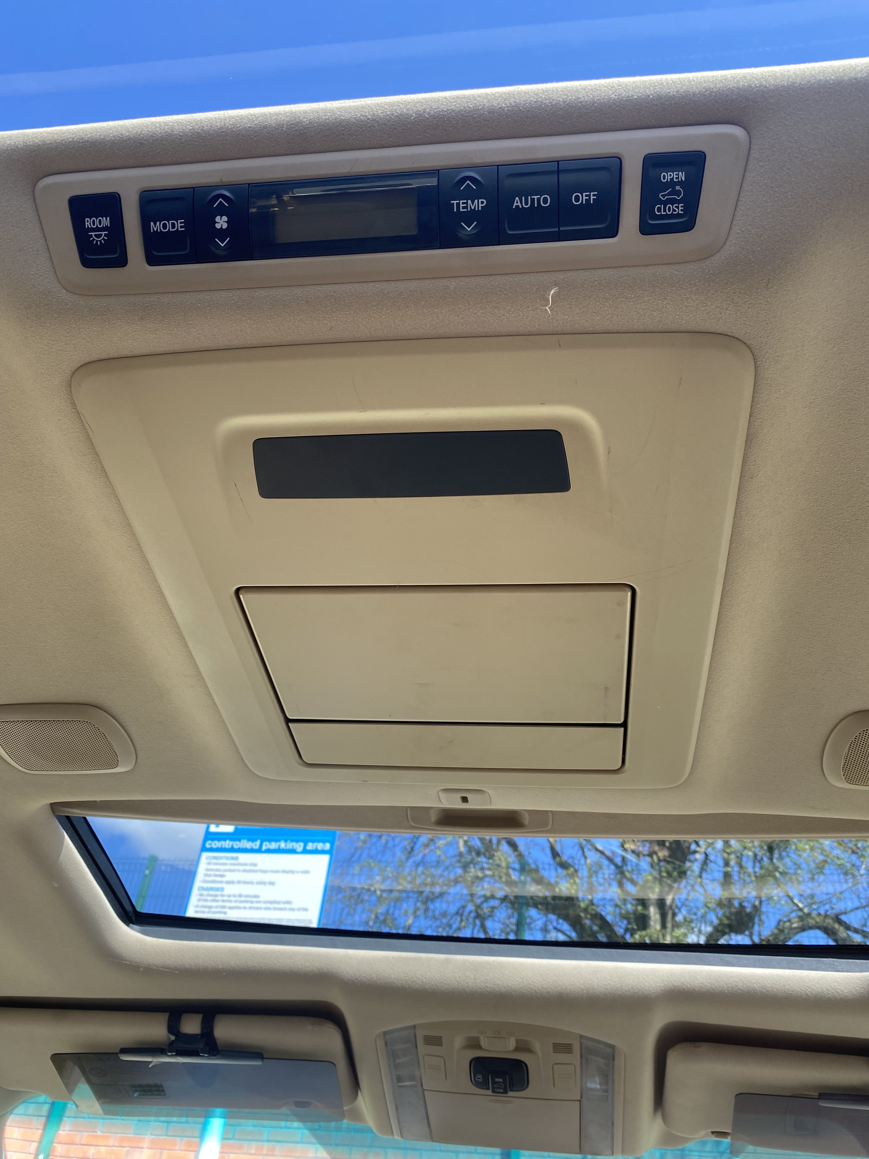

More investigation.. Piecing together the capability of this car and I suspect it has a screen mounted on the roof. I can't be sure as its flush and may just be a blanking plate. I'll try and post an image.

Yes - that is the original screen in the roof, but it won't work (assuming it's OK) without some wiring modifications. I haven't done this myself as yet but plan to.

Second thing - take a picture of the loom plugs for the original head unit and post it here: two variants exist, think yours will be the very long plug (so to determine which type of converter kit you will need).

I took a picture but in all honesty I may not have grabbed the wiring that was deeper inside, so may need to snap another better picture.
No canbus on my headunit, just a generic set of connectors as seen on many. The picture below is from the one that was playing up, replacement just had a few more additional connectors for 4G. Steering wheel controls worked.
