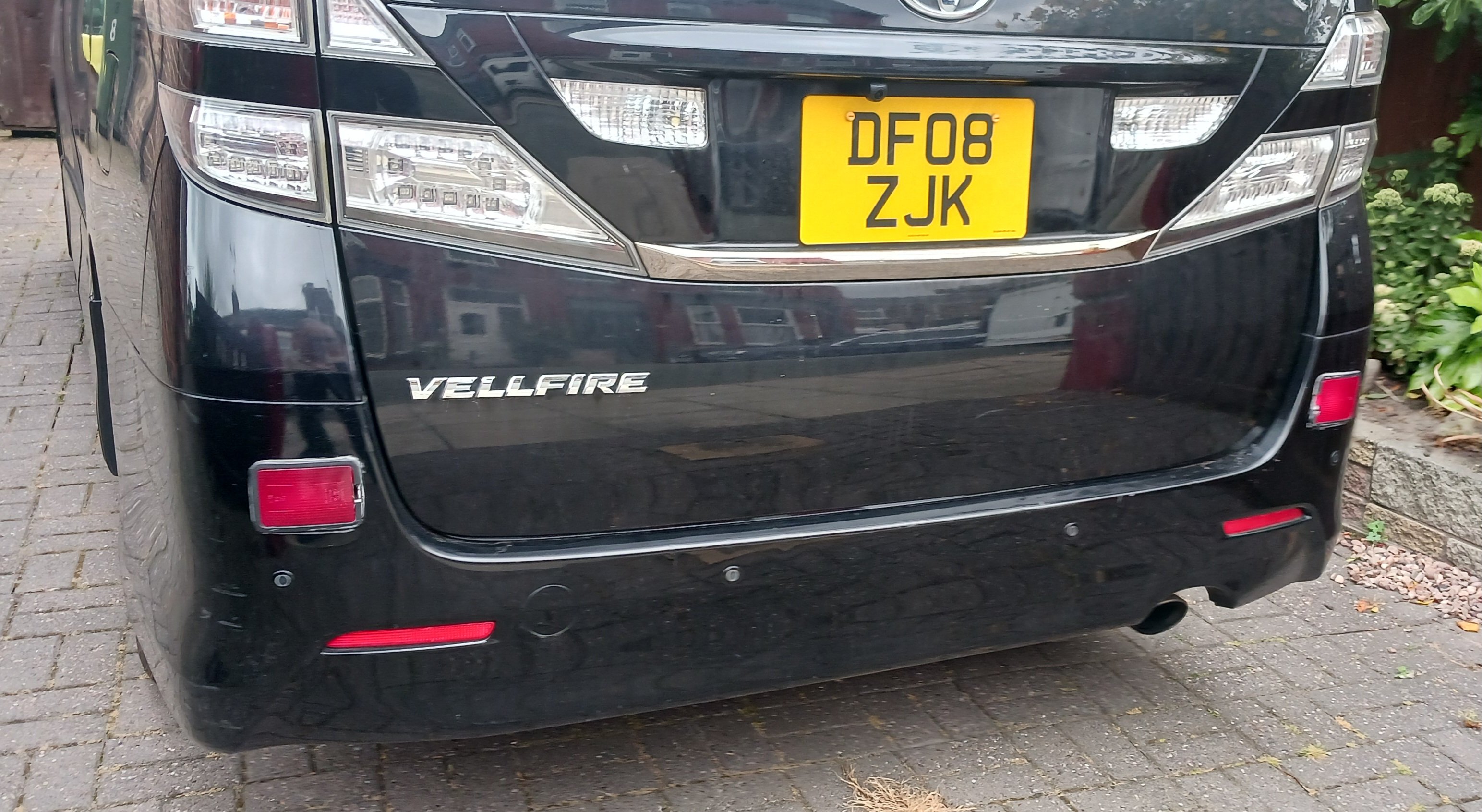

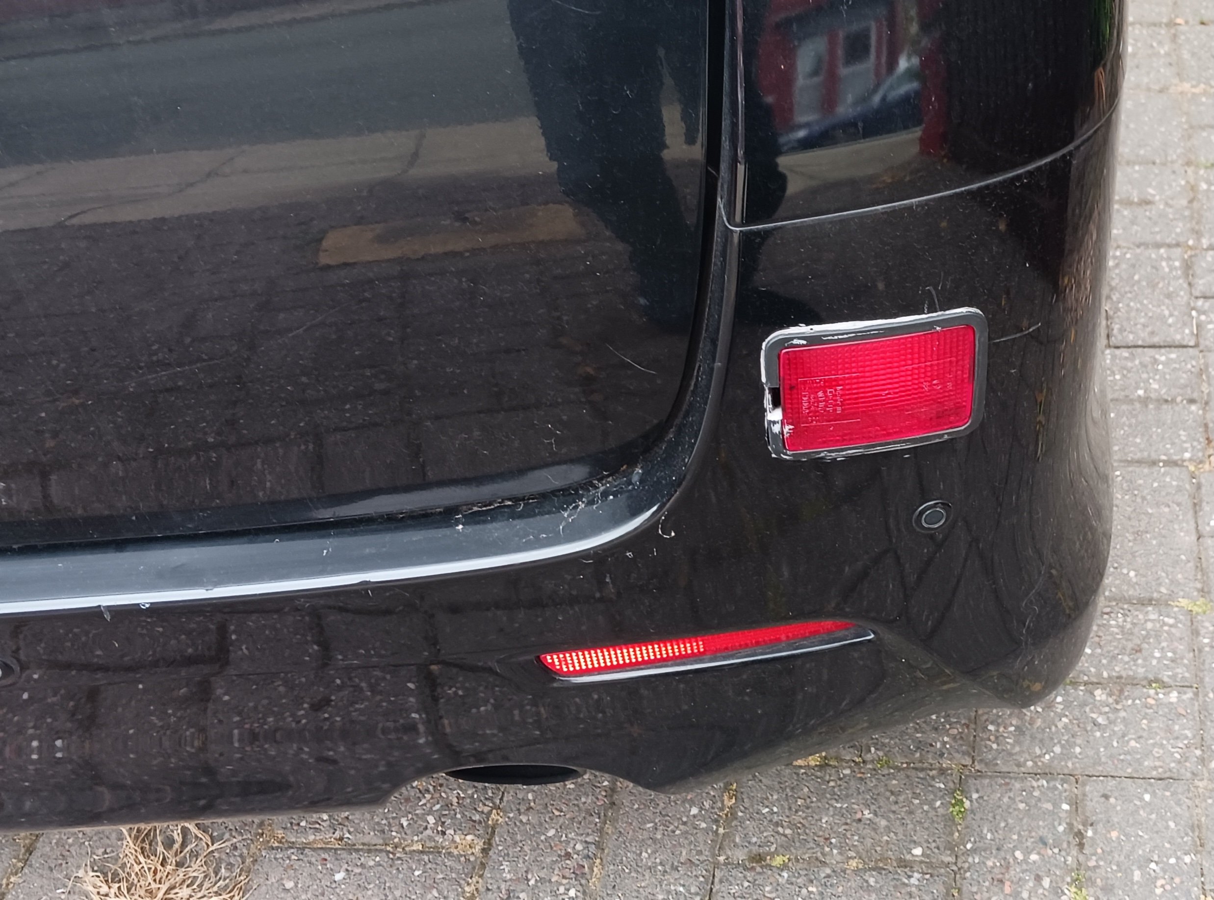

Hi. After having my 08 2.4 AH20 VELLFIRE for about six months, I heard a rattling and the rear. The bracket of the after market fog light had rotted off!
I decided flush fitted fog lights would be better. Trying to find them these days is awkward; not nzny people sell them.
Looking on Ebay I spotted 2 x VW Transporter rear fog lights for £11 + postage.
They looked just the job!
When they arrived I was a bit disappointed. They were flush fitting, but to change a bulb, I had to unclip the whole unit!
I thought to myself, how many times do yoj have to change a bulb in foglights???
I wanted them each side and fit them each side of the rear bumper. It was hard drilling into my Vellfire, so I made the holes smaller at first.
After cutting one hole, I tried the light in. SHOCK, HORROR!!! The light stuck out about 1/4"; it was hitting the body frame! I had a quick think and decided to tap a dent into the body frame. I tried the light in, wired up and tried. Perfect!
The only thing wrong was that water might get into the rear bumper where the lens clip was. I decided that if I wanted to change the bulb I could just peel the sealant off.
I fitted the other and tried; great!
I am very happy with thd job; after 3 years, no bulb change required, no leaks and a fairly good looking job!
Photos make them look a bit tatty, as the car is absolutely filthy at the moment, after a visit to Wales and 300+ miles!!! (As you do in our vans!)
I would recommend these light as a much better fix than the aftermarket bracket types. I don't think 2 x 1/4" dents and a bit of sealer is too much trouble to ask saving at least 40 quid for more expensive ones!!!

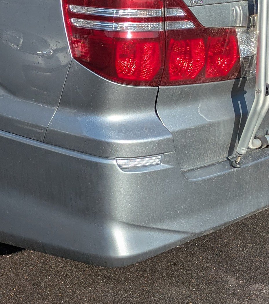

One alternative is to source some rear deflectors that double-up as fog lights - under £20 on eBay from what I remember
They have two sets of LEDs - one set are white and the other set are red - you just need to play with the connections until you get the colour you needed.

very nice but you could have saved yourself a lot of work if you had bought the led lights that fit in the bumper in place of the oblong reflectors
You can buy the red lights that replace the bumper reflectors
I did see these, but you lose the reflectors then
John H
Hi, interesting conversions. They look good. You must have 2 reflectors otherwise it will fail the next MOT.
