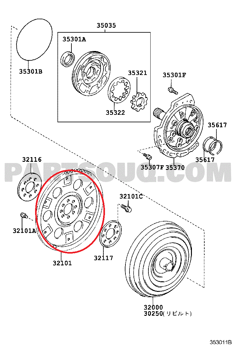

here is a picture atatched of the flywheel and a link to buy it from if you want to go down that route i personaly change the starter motor first for the cost of £90

Hi all , happy to report that I have found a local mechanic not afraid to tackle work on my Alphard.
He removed starter motor inspected Flywheel and found no significant wear, installed new starter motor and it started on the button whoopee.
