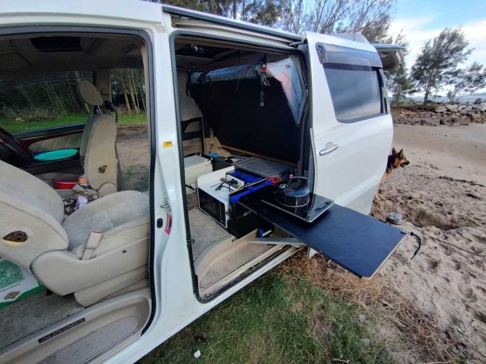

Got away this weekend for the first time in myself converted budget 2004 4wd v6 alphie.
Spent less than 1500 aud fitting ot out.
Flipped the passenger seat, installed a bed at the height of the rear seat side rails (32cm of clearance underneath) which hinges up into a forward or a rearward facing sofa (hooked up to what used to be the grab rails)
200ah lithium, 2k inverter, semi flexible roof solar, microwave, fridge, toilet, induction cooker.
Pretty happy so far.
Van has 85,000km.
Only complaint is the fuel economy.
Mine is a 4 speed and I gather the 5-speed Auto would have been more economical.
But the whole van including the build has cost me 11k Australian, which is 6500 pounds.
The 107 kph cruise control maximum is potentially annoying on the freeway but no freeway between my house and the beach ๐Ÿ˜Š
I have posted previously about rotating the passenger seat without a swivel.
I think this is the best way to do it. Because every time I sit in it I think if it was four centimeters higher I wouldn't be able to in either direction.
It's so easy to just undo the four 14 millimeter bolts holding in the passenger seat and flip it around.
You just need to drill two rivnuts into the seat base to secure the front tabs into what is now the rear of the seat base.
Maybe it takes 2 minutes but I think two minutes every time you need to flip the seat might be better than an extra inch and a half of seat height in both directions just for the convenience of a swivel.
Hoping this is the first of many weekend getaways in the Alfie ๐Ÿ˜ŠIMG_20251123_173710578_HDR.jpg
Looks great! Any more pictures of your conversion you can share??
Enjoy
Ingenious idea for the front seat, How old is the GSD?
