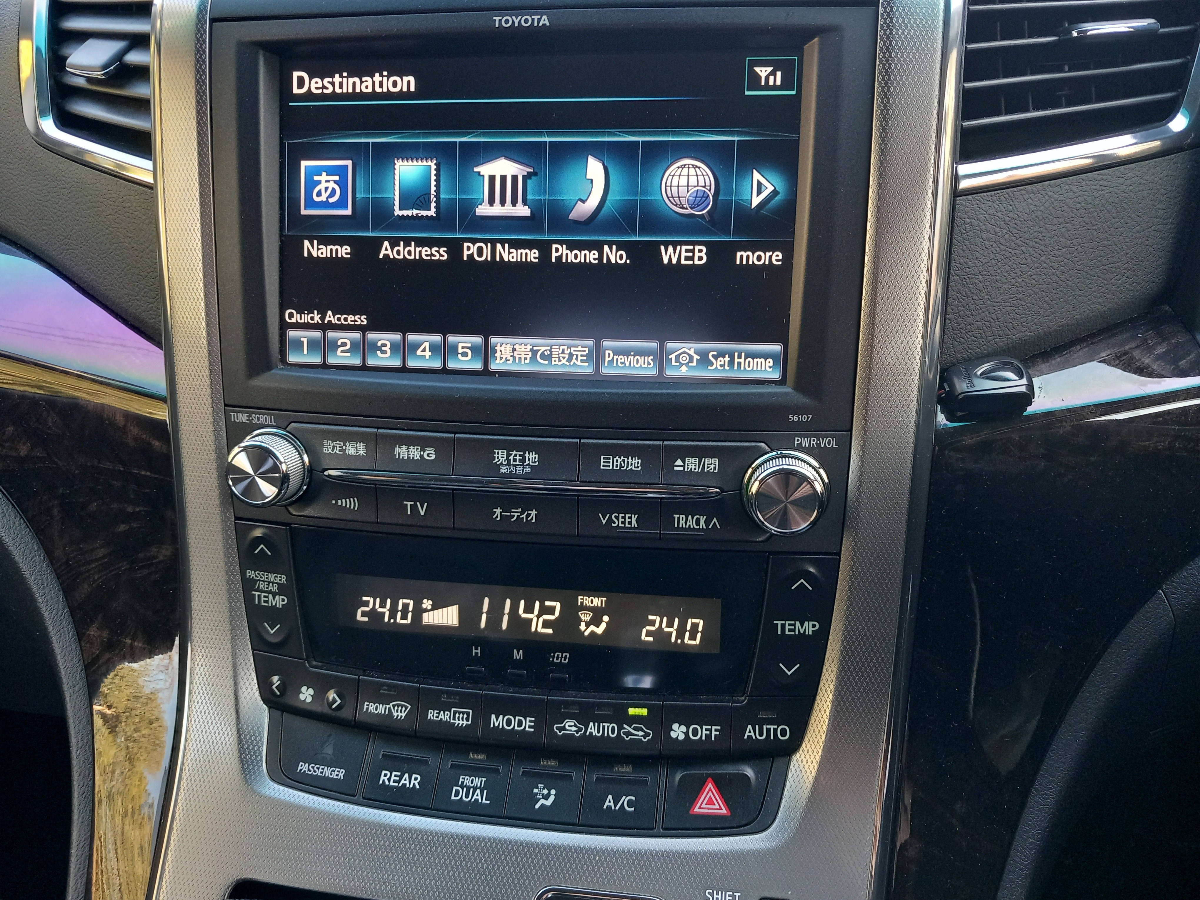

Looking for some advice had our alphard for a week or so getting my head arround the head unit
Can't get many radio stations
Navigation not working
It is a 2013 ggh20 alphard with 6 speakers in roof rear screen also 360 camera
Can I get more radio stations ever and will the nav ever work
If I change unit what will I loose
Thanks in advance for any input
The Japanese use a different upper and lower frequency band. You can buy an expander, that retunes UK into Japanese frequency.
They cost about £15.
The satnav will not work.
It is designed for the Japanese satellite orbits.
Your options are to use a mobile phone, connected via Bluetooth for audio, and use phone screen for satnav, and if you have unlimited data, a radio streaming app.
You could also use a carplay adaptor, again it will rely on a data plan on your phone.
Last is to replace headunit. You have choices of 'dumb' headunits that are just radio/cd, or full blown multimedia usually running on android.
I went the dirt cheap route of picking up a wireless car play screen from Aliexpress for £45. I didn't want to replace the head unit and wasn't comfortable getting the kit to add car play to it and didn't fancy spending 400 odd quid and the trip to get Ben to do it for me.
