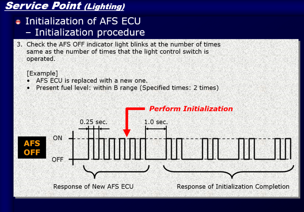

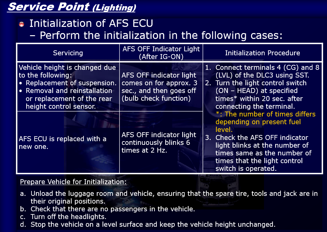

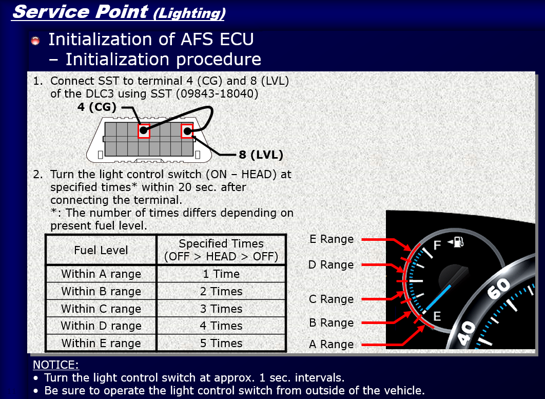

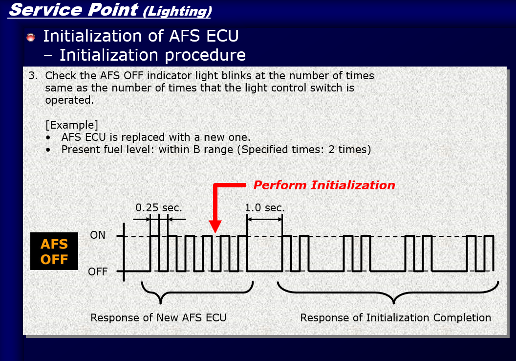

On 9/29/2021 at 10:13 AM, Chris.ac said:
Did you resolve this? if not, I have these instructions:
image.thumb.png.021ea7d1965b0ea9e96353cab136bdd1.pngimage.thumb.png.c1e99d9b52986c5e09b6ed8f33ffe6d8.png
Hey all, could anyone point me to where in the Alphard this service point is please? I had a look last night but couldn't find it in the drivers well. Any pointers please 🙏
You have a 20 series?
When I originally posted this, the forum was not split in to two sections for 10 and 20 series, so the instructions here may not be applicable to 10 series.
