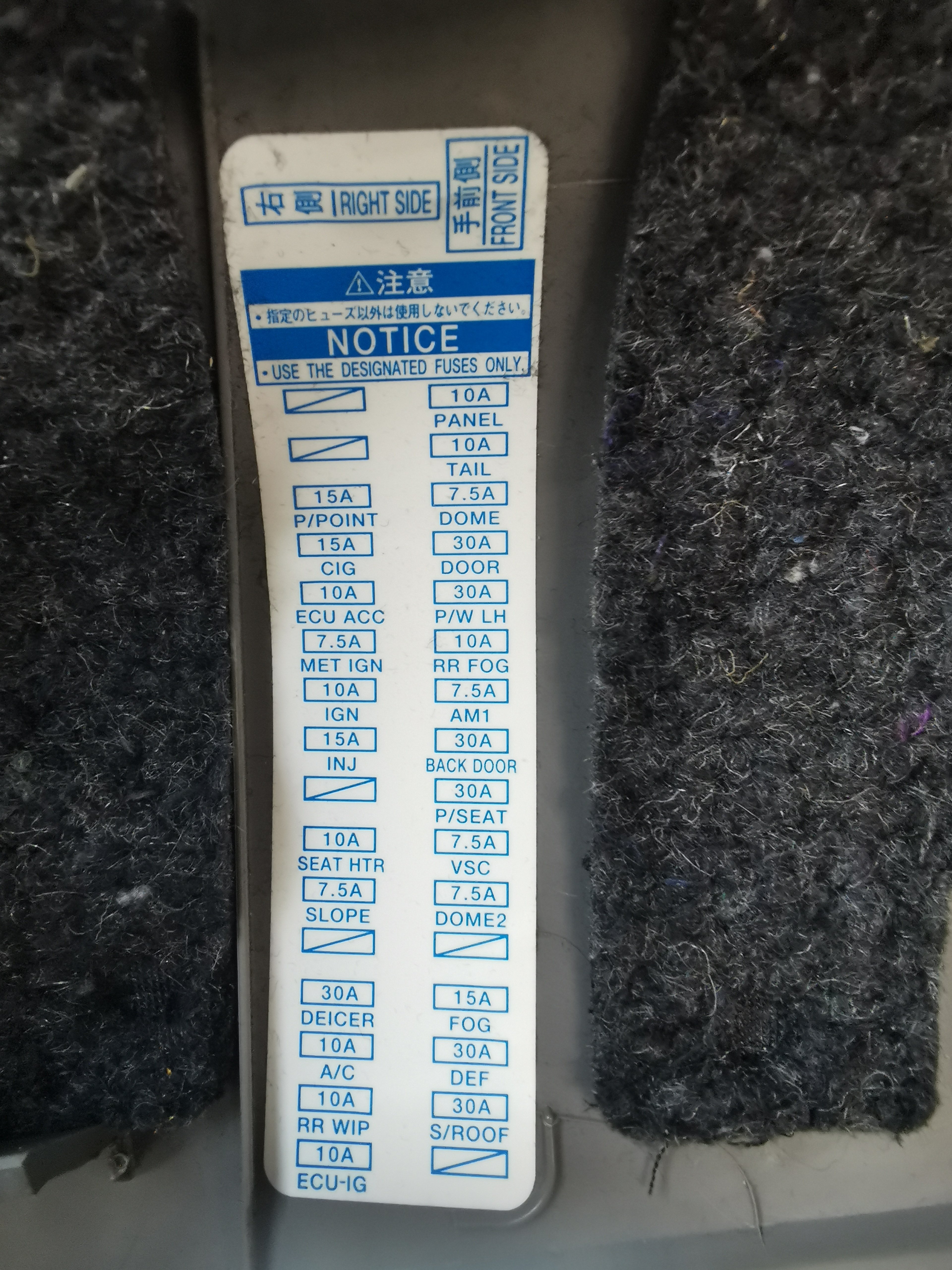

Can you upload a photo (of the whole fuse box, lid off) to help me tell you which is fuse 7 ?
I need to identify that my illustration is your fuse box.

According to my manual, it is the last of the photo above.

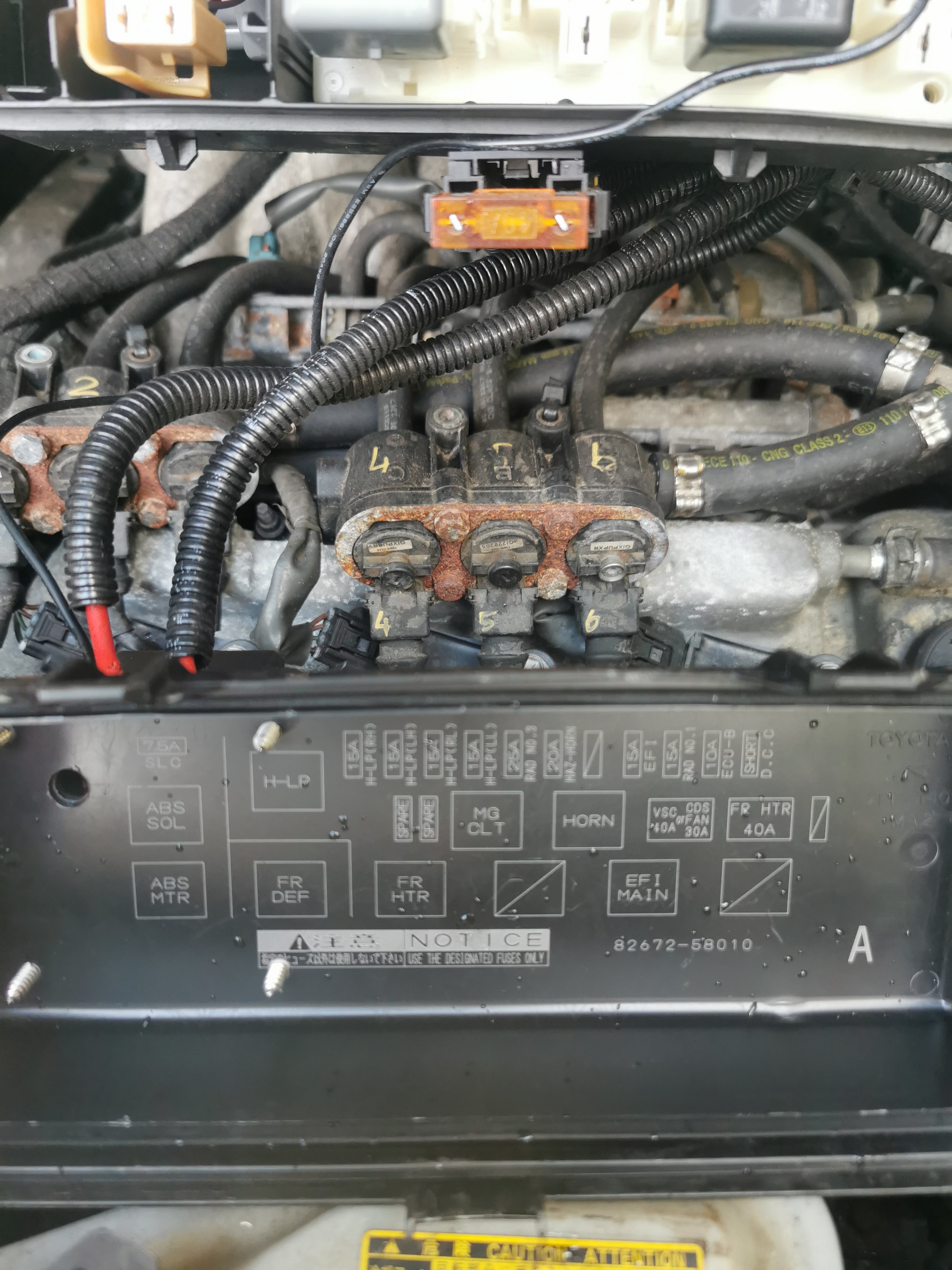

I have enlarged your photo and the fuse for the horn is the 6th from the right  on the top row.
Left of the EFI and left of the free space.
It is marked HRZ HORN.
So if it is a fuse, that's the one.
