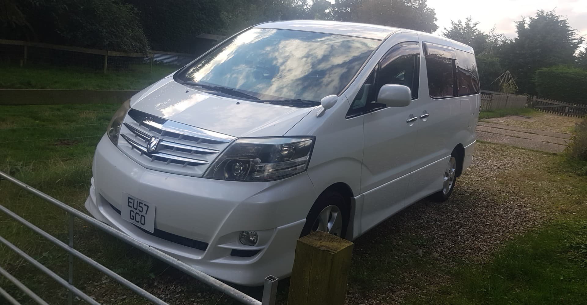

It's not an mz as the fog lights on the front are round. It is a V
Yeah the V on the back is the trim version, you have got g or v as options. V is more common.
These are two separate things! the japanese love different trim levels!
For example an mz V is different to an mz G
or an ms V is different to an ms G
You have an MS V
i was confused at first too haha. Couldn't tell the difference when i first heard of alphards
