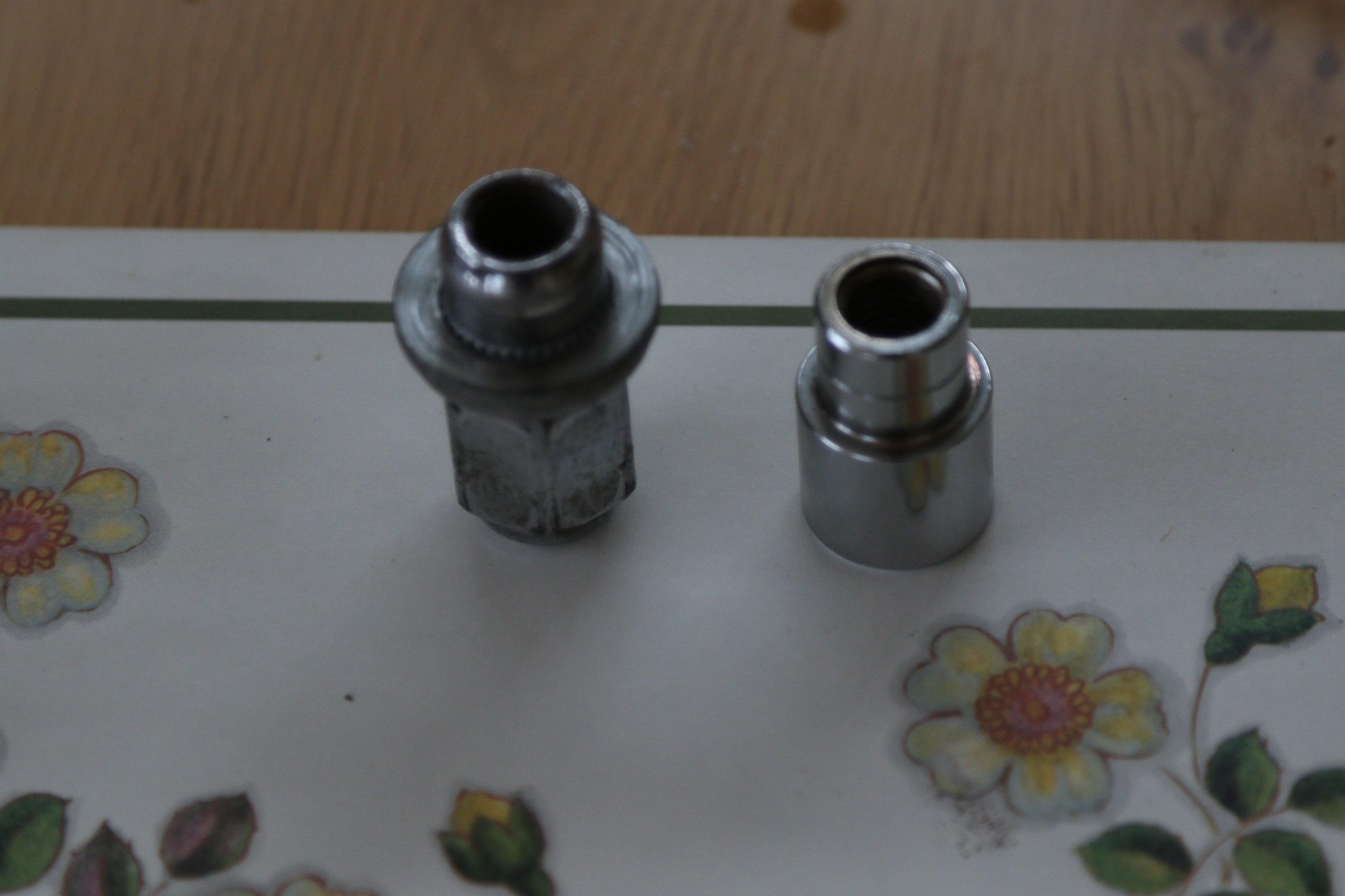

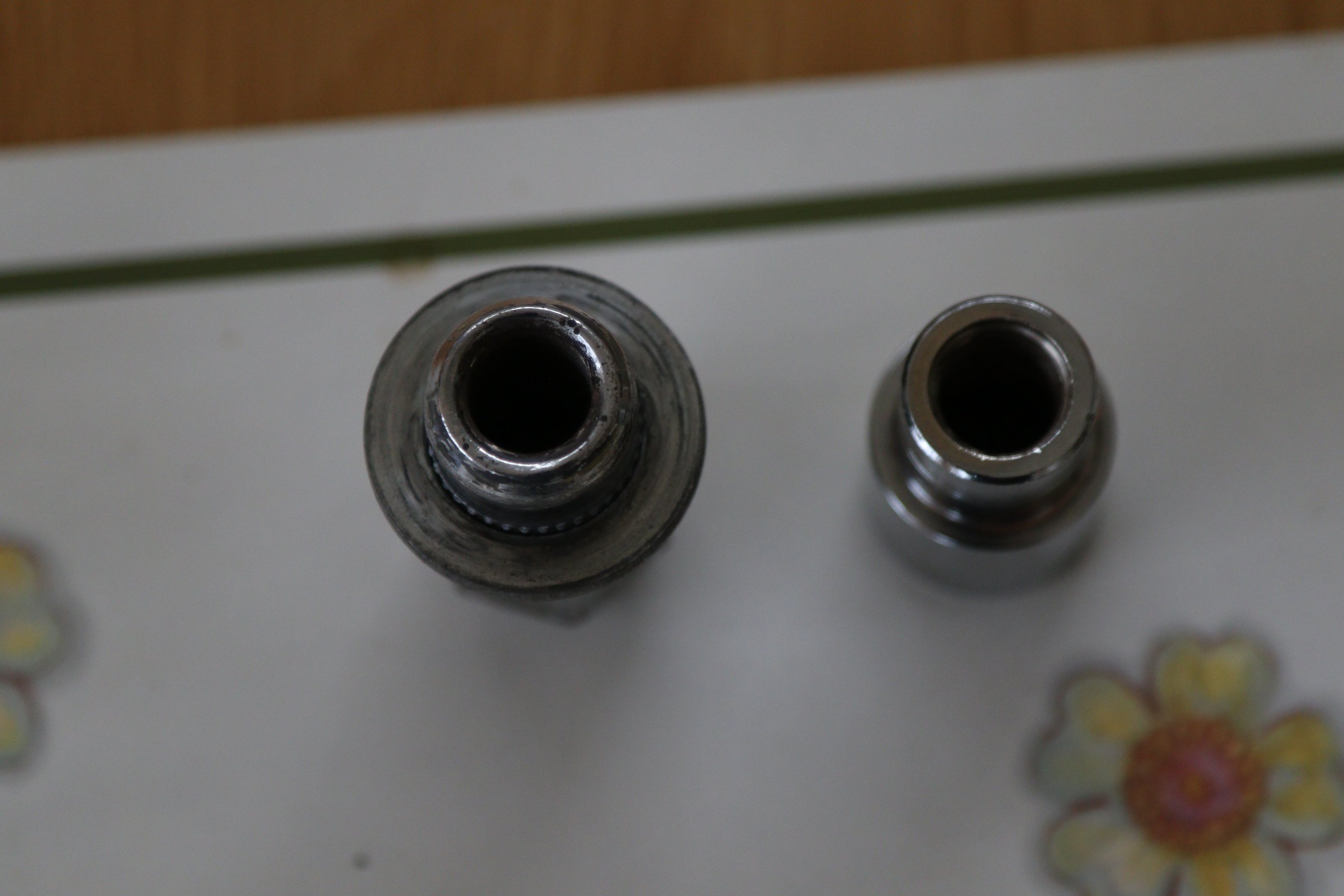

OK, so at the request of the seller, I have removed a wheel nut,
It is definitely different to the new security ones supplied.
Firstly the diameter of the security nut, where it passes through the wheel, is smaller; which explains why my mechanic said they were too loose !
It also has a tapered end, not flat as the new one does !
The new nut is quite a bit shorter than the original ! Which may not matter other than cosmetically.
It could even be an advantage as it makes the security nut noticeably different to the others on each wheel.
I am left wondering if the 'flat' reference is relevant to the shoulder of the nut, ie, where it presses the wheel to the wheel stud; or the end of the actual nut
Confused, I have checked the Alphard EPC.
The nut drawing definitely, imho, shows the end of the wheel nut to be tapered.
It may not make any difference, but I AM concerned.
I am sending photos off to the supplier and will post them here for awareness.
(Photos will be added later).
The leftmost nut is the original, the rightmost the new security nut.
Edited by Rojie
Addition of two photos

Hi Starrider, and fellow members,
If you are considering buying McGard locking wheel nuts for your beloved Alphie this will be of interest to you.
I have solved the mystery of why my mechanic could not fit the locking wheel nuts !
With my first set one of the washers would not pass over the new security nut,
I returned them, as agreed with the vendor, and await my refund.
The second set, sourced direct from Germany, could not, initially, be fitted either ! Why ?
If you refer to the photo above, the original nut (on the left) has a captive washer, the new security nut does not.
The lateral play on the original washer is almost zero.
The lateral play on the security nut is probably about a sixteenth of an inch.
When fitting the new nut, there is a distinct tendency for the washer to fall from the nut and drop onto the thread of the wheel bolt.
In such a position, it is impossible to tighten the new security nut ! You may be lucky as this does not happen every time, but when it does ....
So, while resting on your hands and knees you have to manually lift the washer (while the nut is in the way) and hold it in the correct position while you hand tighten the new nut. NOT particularly easy.
So, just imagine you have a flat tyre, on the offside, in the pouring rain, on a windy day, on a very busy A road, in the dark (holding a torch) !!!
Even one of the rescue services will not find the task easy !.
So, as Starider says, you MUST keep at least one of the original nuts which will fit perfectly, without hassle.
When safe, the original nut can be replaced with the security nut.
I suggest the security key and one original nut are kept in a very accessible place.
So, whilst I feel the product is actually quite good, I cannot recommend it as fitting it in an emergency situation could be very difficult.
