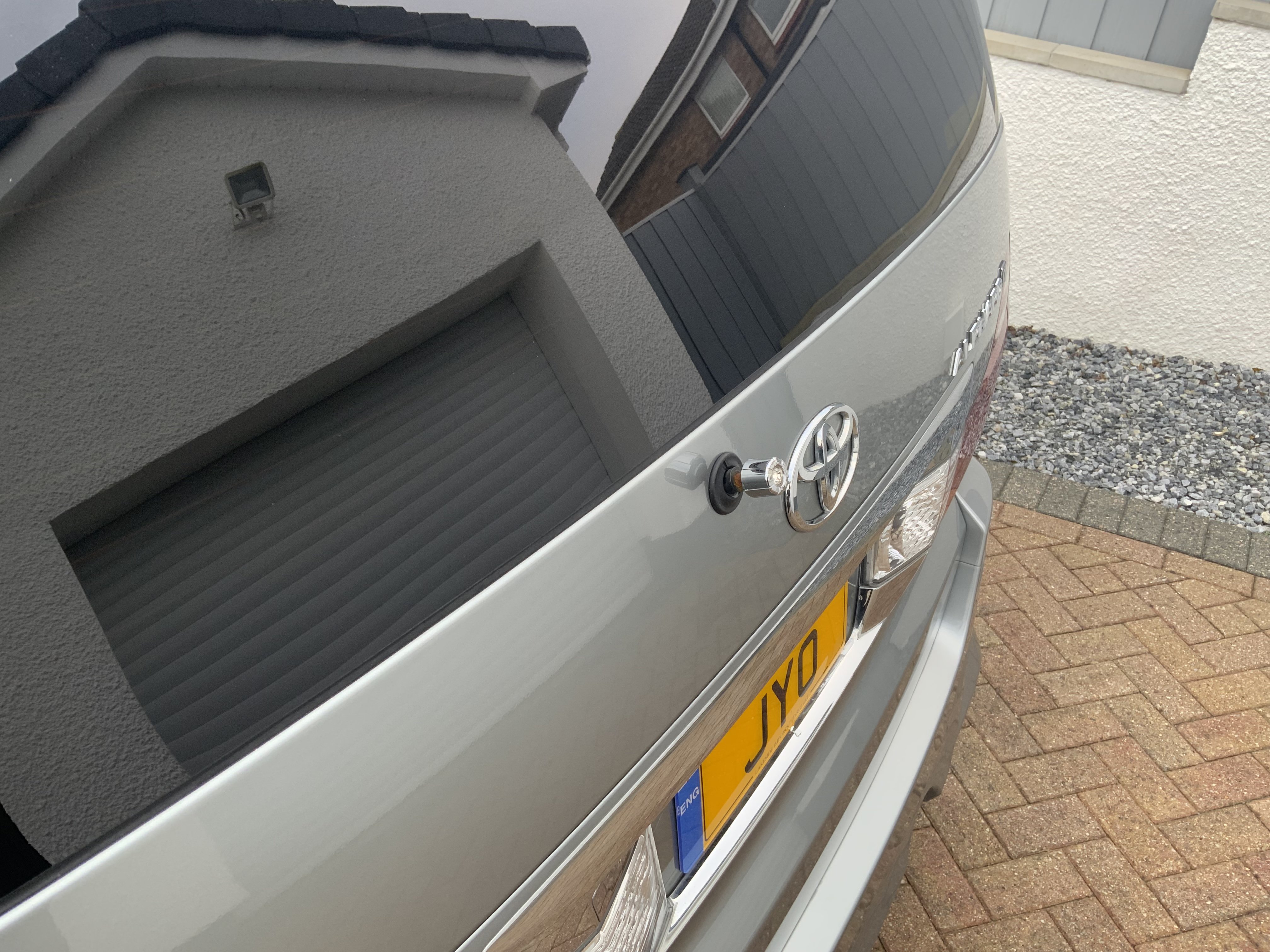

Hi Phil,
If your Alphie is Gen 1, as 2007 would suggest, you should have a wiper arm in the middle of the lower edge of the rear window.
Hi all
As promised here is a photo of the ‘decorative cover.’ I might have made it sound better than it is by mistake, it is only a plastic knob.
Thanks to you all for your advice and to you Rojie fo the info regarding spares.
Regards
Phil

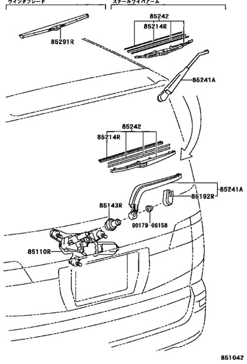

Question: is rear wiper arm fitted to taper splines? Mine is tight to come off, even after penetrant spray application, garage owner advised some have soft cotter pins which can shear easily!
Edited by Clutha
Spelling error
image.pngThis (from: https://www.amayama.com/en/genuine-catalogs/epc/toyota-japan/alphard/ANH10W/36377/electric/8502) is for my 2005 facelift version but doesn't show anything more than a nut holding it on. You could try a ball-joint splitter - tension it up and give the arm a sharp tap or two (after a dose of WD40 or penetrating oil) and it should come off.
Thanks Gamith!
Perfect info 😉
A top tip I was given to remove wiper arms -
loosen and remove the nut,
press DOWN firmly, but not hard, on the arm, near to the wiper end, to release the grip on the splines,
pull arm off!
It's worked for me many times, I hope it does for you!!
Wiper arm pullers are available quite cheaply if it does become difficult to remove. Link
