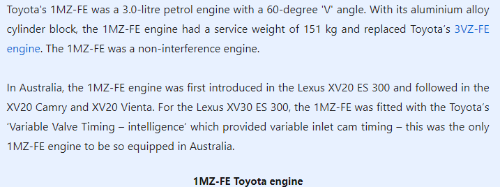

It's comforting to know that my 3L V6 engine is an non-interference engine, and if the inevitable ever happens to the Timing belt, and snaps, then the valve and pistons won't be harmed due to its robust design.
Has anyone ever had their timing belt break on this engine?
More Info here: http://australiancar.reviews/1MZ-FE-engine.php
