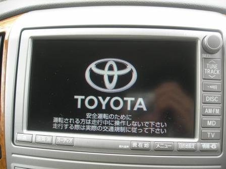

Has anyone explored this area? Before opening the consol up I just wondered if there was a possibility to use the audio leads that plug into the inbuild MD Disc unit? I'd rather have Aux In connector for my phone, and music etc!

I just want to connect my iPod or phone through the headphone connector to hear music through the headunit.

OK, after a bit of a play around with the Remote Control, I connected the red and white stereo phono plugs to the middle VCR console, and jack plug to my tiny robi DAB radio unit; then I switched it to 'VIDEO' mode, and hey presto, it worked perfectly, so connecting to VIDEO mode is the way into playing your own music/radio through the unit; hth you all!:)
