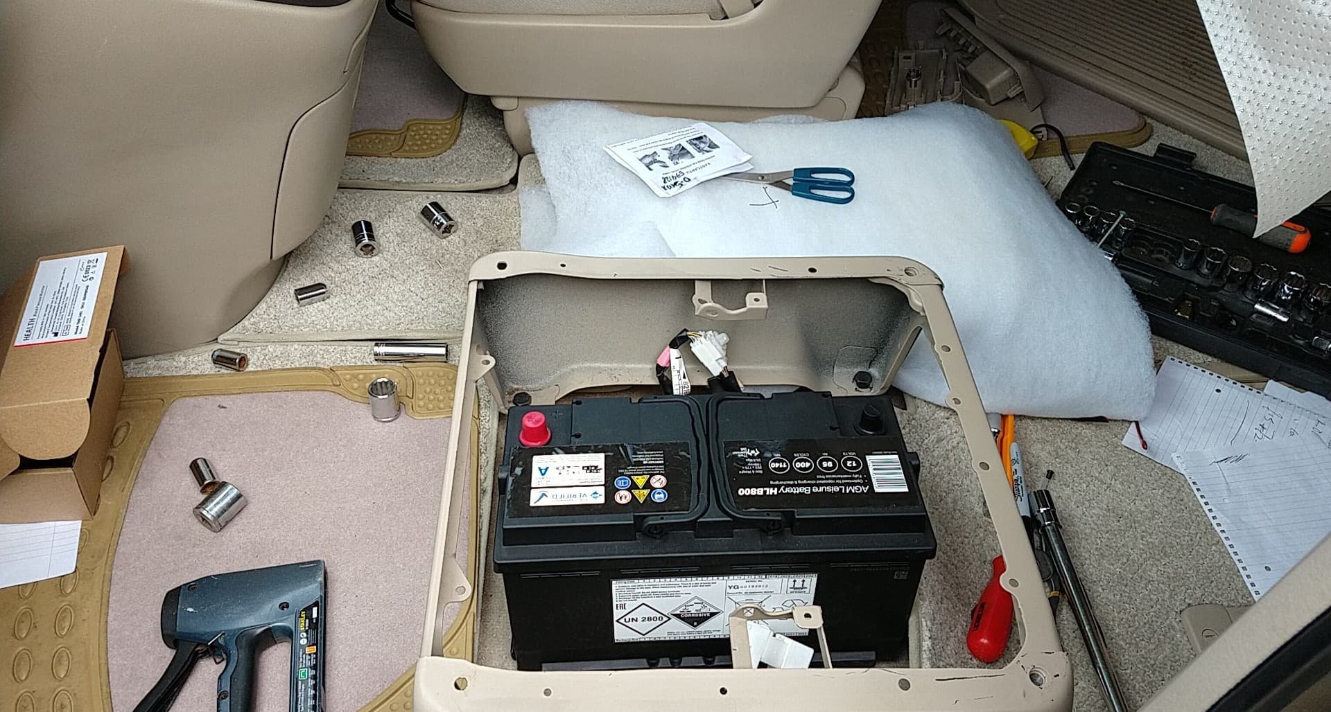

110amp Leisure Battery fitted with split charge system .12v 140amp Intelligent M-Power Relay

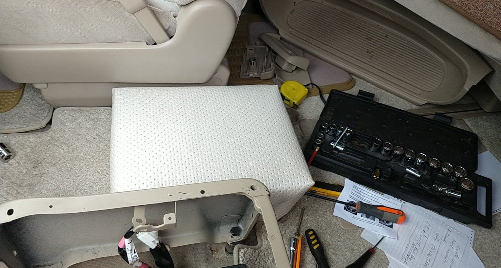

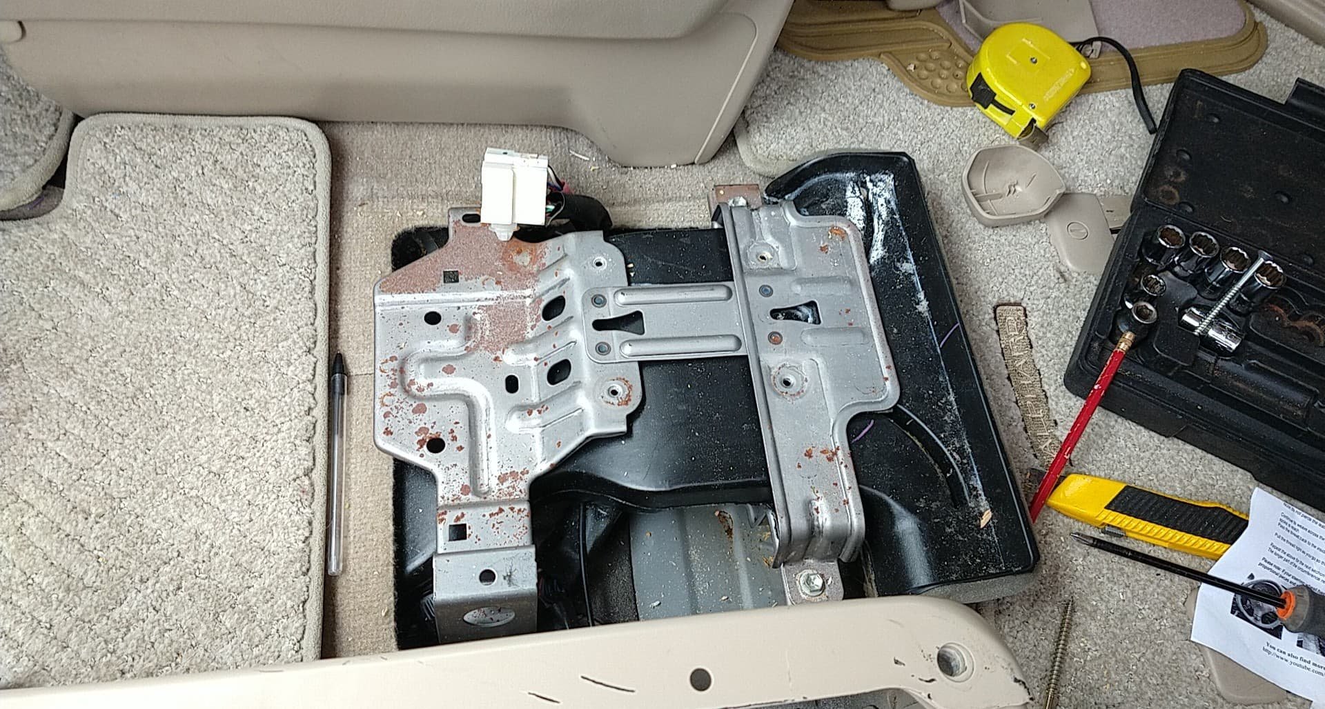

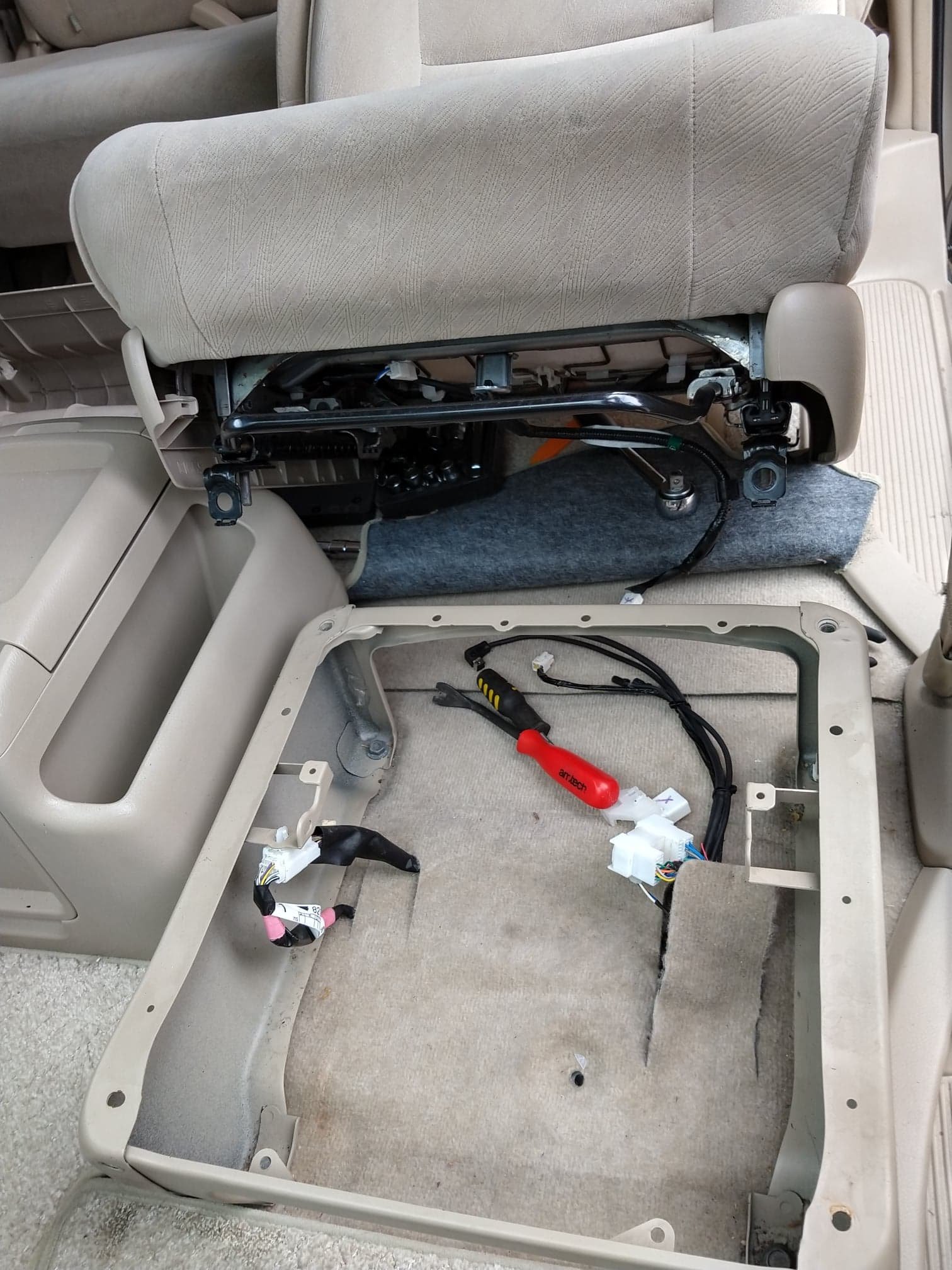

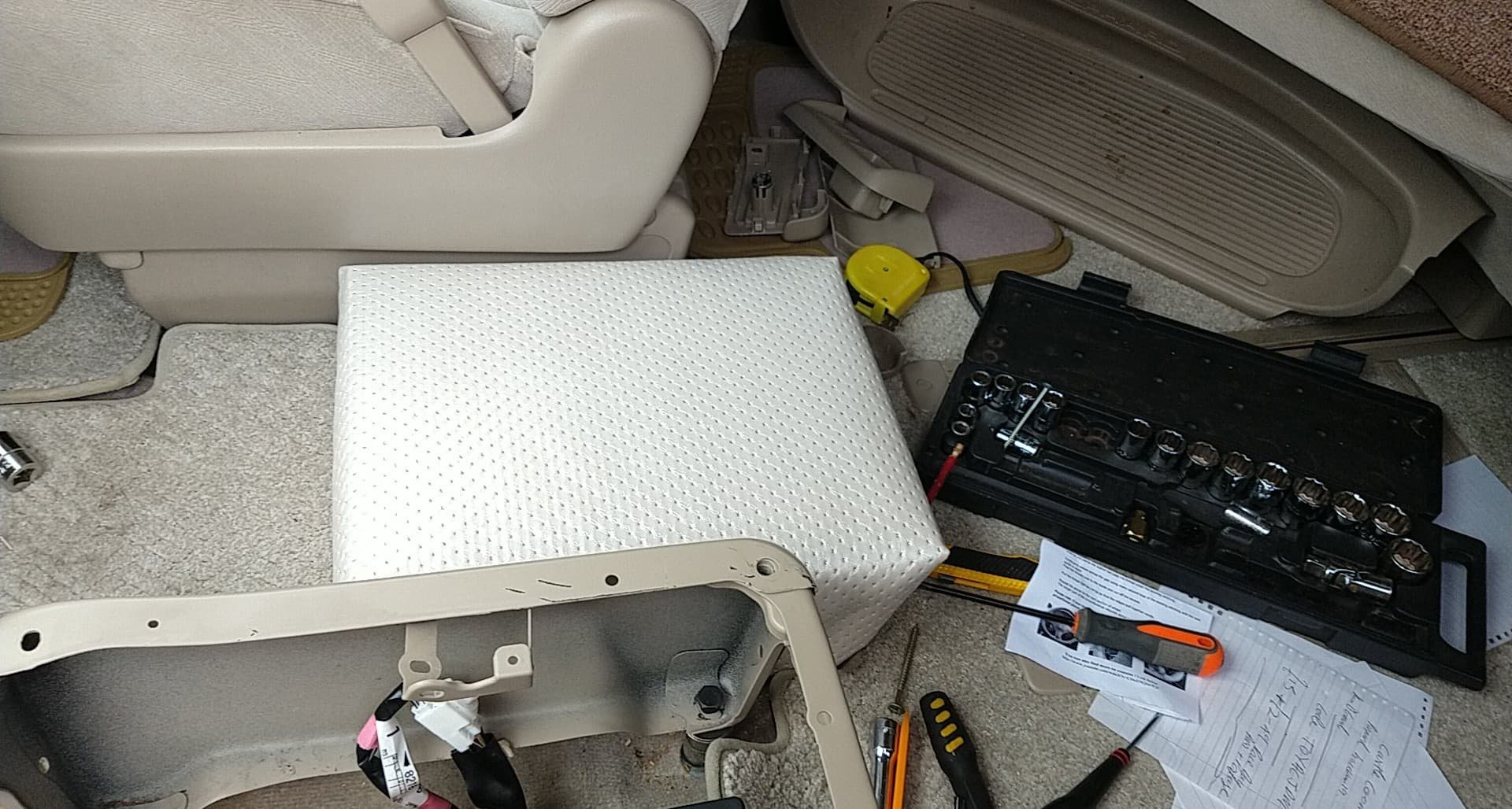

Front passenger seat swivel .. Now I know that if you fit a swivel you cannot fit a 110amp battery under the seat as well lol, wife's head on ceiling .

Hi can I ask where you got the swivel seat base from and the part make of the split charge relay ,thank you
https://www.simplysplitcharge.co.uk/
From them or eBay, get longer than you think you need as I had to buy extra cable to lengthen. Durite brand.
Seat base swivel I now believe they are not selling direct to the public but I know Paul at Newacre cars bought a job lot . Paul is the guy for ALL things Alphard  Inc conversions and LPG installations  I bought my last Van from him cannot recommend him enough. The place to see lots of vans in one place .  http://newacrecars.com/
