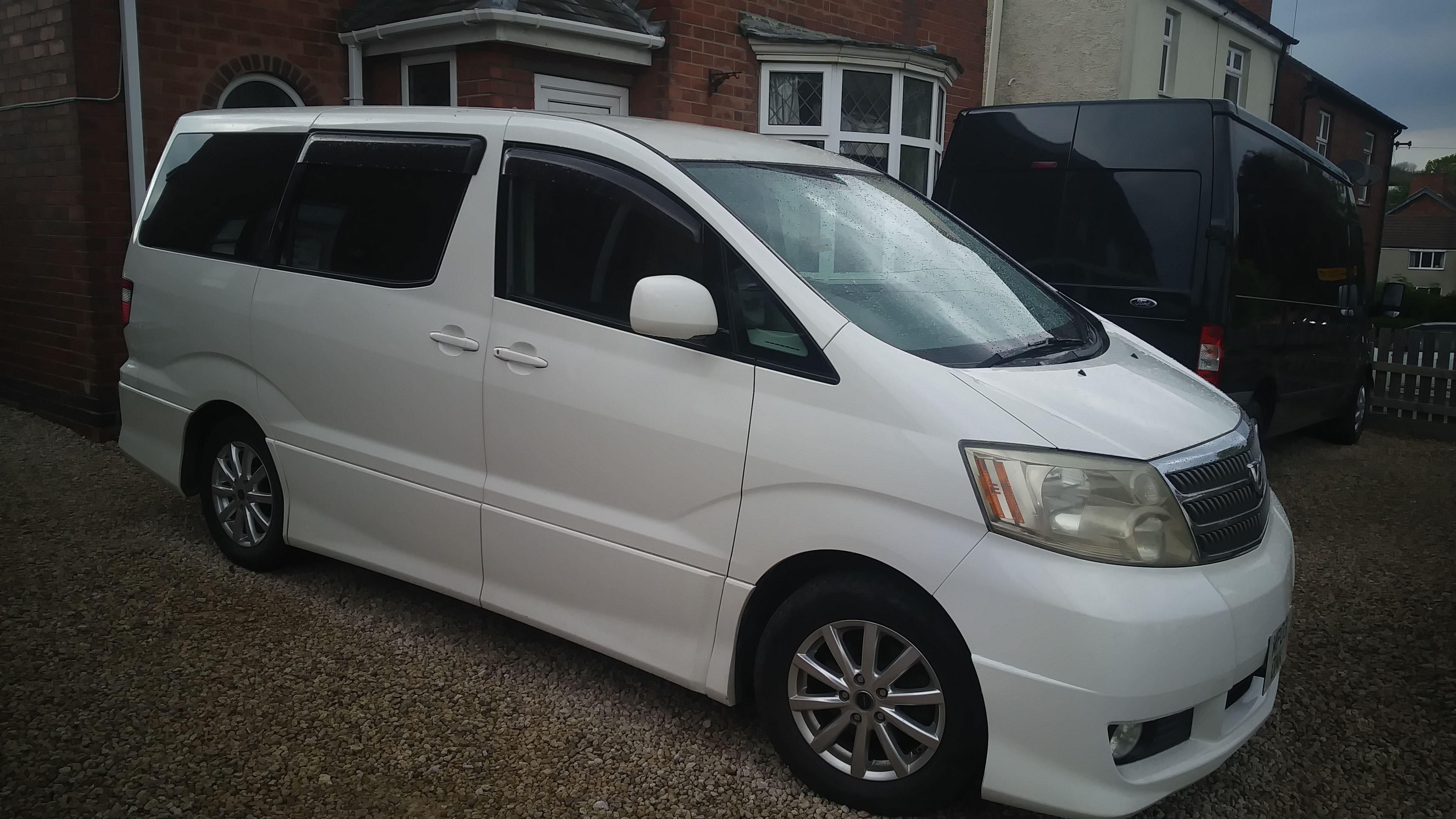

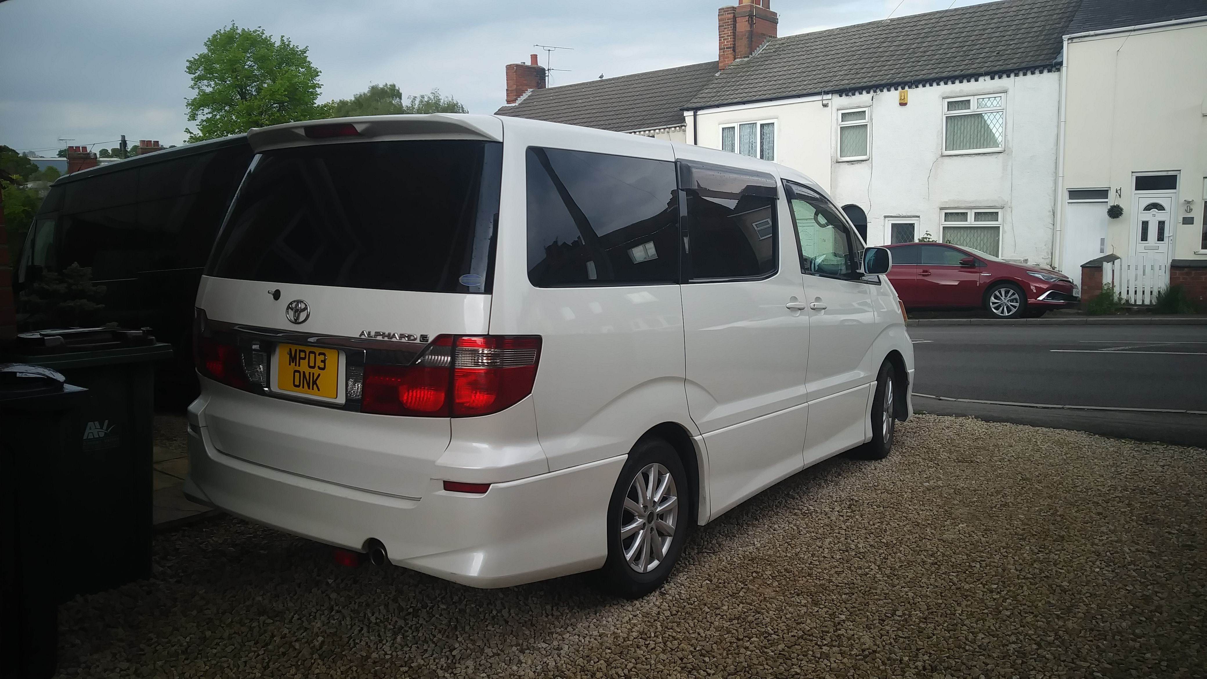

Going to see a 3.0l mzg tomorrow.
Hope it's as good in the flesh as the picture make it.
