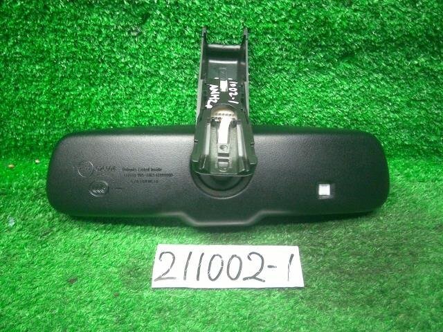

I'm looking to get an auto-dimming rear view mirror..
and came across different ones..
One with what looks like a sensor on the back of the mirror (or a camera??), and one without..
Can anyone tell me what is actually is please??
Thanks~

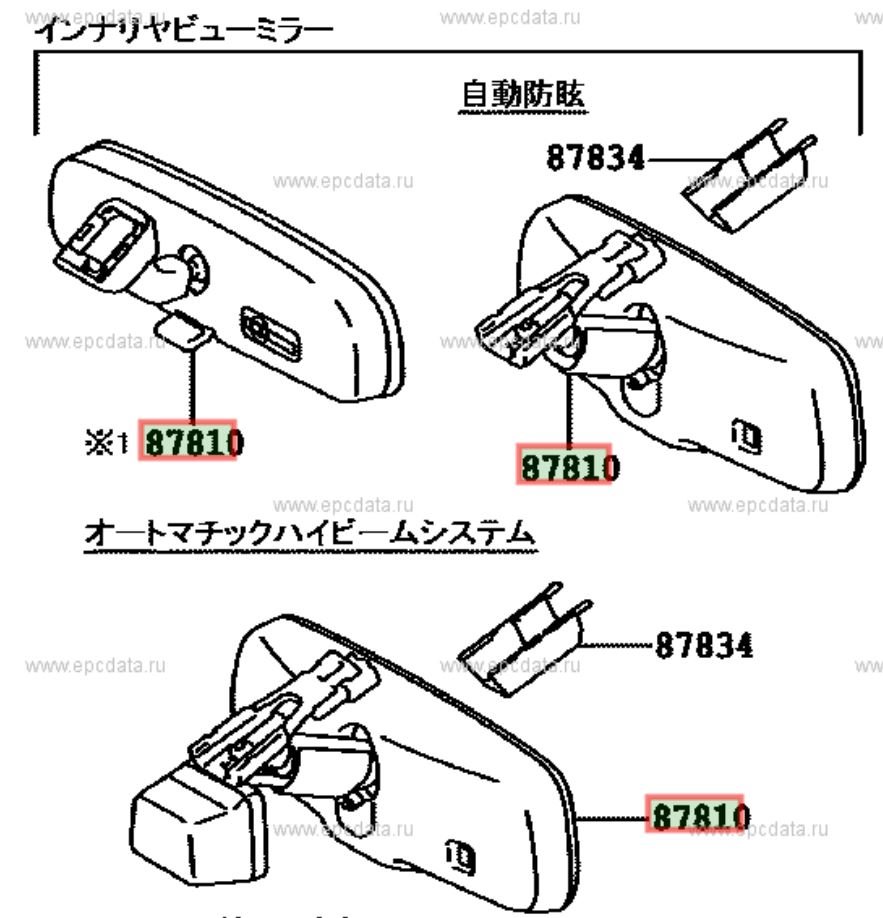

I found it an an obscure EPC drawing, but there is no description.
I am left wondering whether it is a sensor/camera for the pre collision system ?
I believe the PCS are rare, if that is what it is !

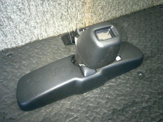

I found what it was
It's an 'Automatic High-beam System'
7 minutes ago, EaglEye said:
Ok
I found what it was
These are the drawings I found !
But didn't have the mrs. phone to translate.
Well done for finding it.
It helps that I can read Japanese

You are right, on the alphards exported to china, they had to have auto headlamp dipping fitted, that big Boi incorporates a filter/lens to detect oncoming traffic and when within a certain range, will turn off high beams, it is setup for driving on the right hand side carriage way, so not sure if the lens setup would work on UK roads.
There is an anti glare mirror that has a small sensor on the inside face, that will detect headlamps behind you and auto flip the mirror to cut glare.
