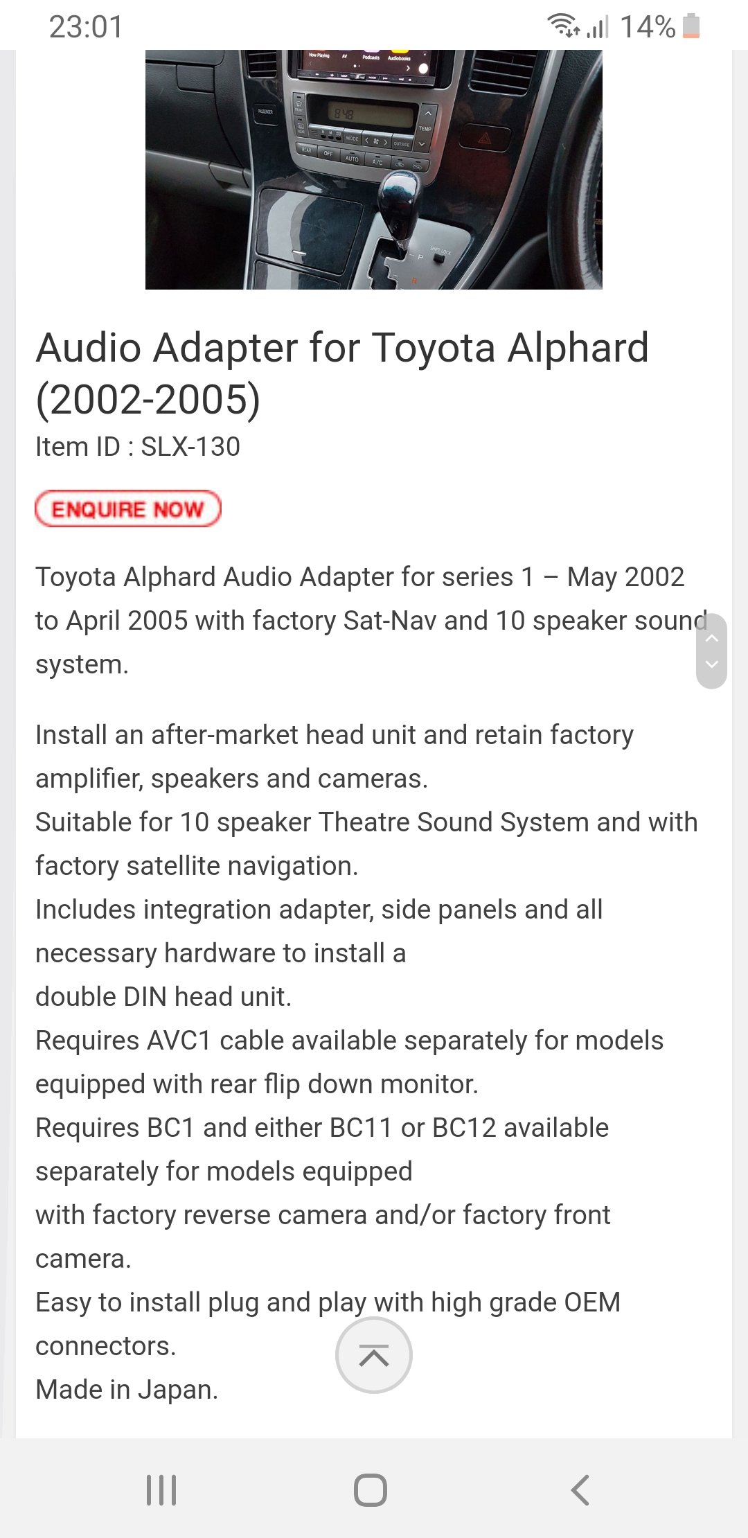

we have recently bought a  2005 Alphard Japanese import . We are looking at replacing the currently Japanese touch screen radio / DVD player with a UK equivalent but we are struggling to find anything that will be compatible with the import connections that we have ?
Has anyone found the same frustrations and or found a solution that will both connect to the original fittings but also the steering wheel functions and rear camera that we currently have ?
Those units you've listed, could you confirm that they keep all steering wheel and camera function?
Pioneer and Xtrons yes. with a bit of fidling. i.e. swapping wires around o nthe back of the unit untill they do the job. or you can find a cambus to translate the signals.

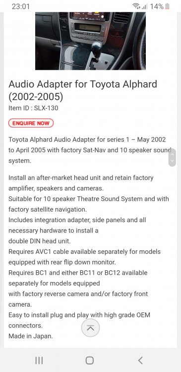

Already posted this in new members forum, worth a look, several conversion units to allow all standard functionality with an aftermarket head unit
