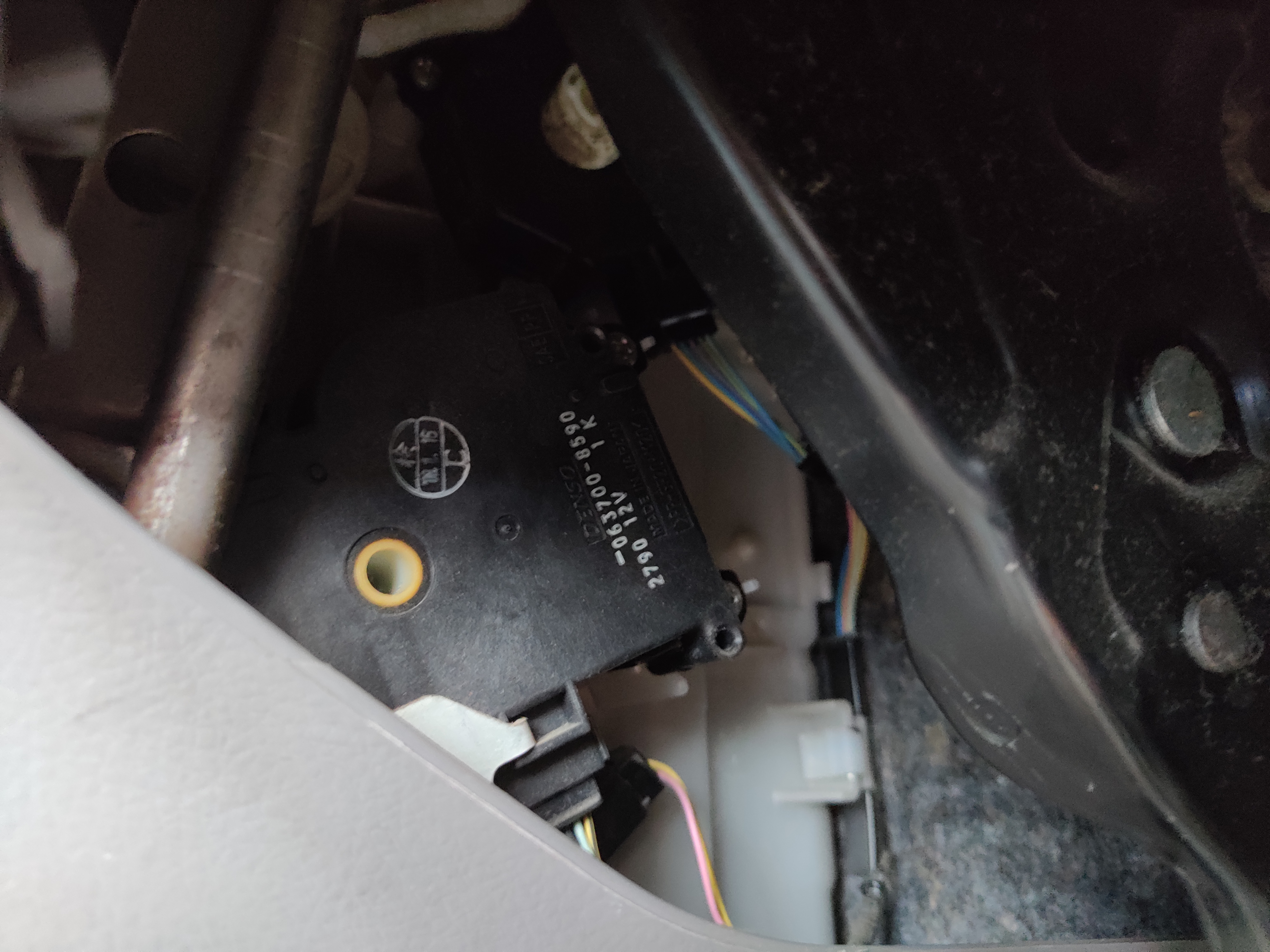

Waseem Posted October 25, 2022 Share Posted October 25, 2022 I think I may have the same issue. Constantly hearing a ticking sound from the actuator. Hot and cold temperatures do work but would have to set at approx 27 degrees with higher fan speed for the hot air to come through. I can partially see the flap actuator at the bottom of the centre console (just by the foot brake). Can you kindly advise the steps on how to access this and replace? Quote Link to comment Share on other sites More sharing options...

Waseem Posted October 27, 2022 Share Posted October 27, 2022 Thanks for this Martyn. Really useful video and top marks to Gold Star. I'm struggling to find the actual part number based on the one I already have in my 3.0 Alphard which is 063700-8590 (based on the pic) On eBay there are plenty of Avensis ones with part numbers ending in 8580 or 8610. Was hoping to do a swap of the whole part but not sure if I specifically need 8590. Quote Link to comment Share on other sites More sharing options...
Martyn Sweeney Posted October 27, 2022 Share Posted October 27, 2022 The Alphard ones (8590)are like gold dust . Couldn't find one anywhere. Was quoted £ 279 with delivery around end of November. Decided to get the Avensis one off e bay and swap the worn part over. It was from an 06 Avensis cost me 20 quid.This is it Quote Link to comment Share on other sites More sharing options...
Waseem Posted October 27, 2022 Share Posted October 27, 2022 I'll probably have to get an Avensis one and swap the disc over as well. Got a quote from Toyota and they quoted £239. Didn't realise they're so expensive Quote Link to comment Share on other sites More sharing options...
