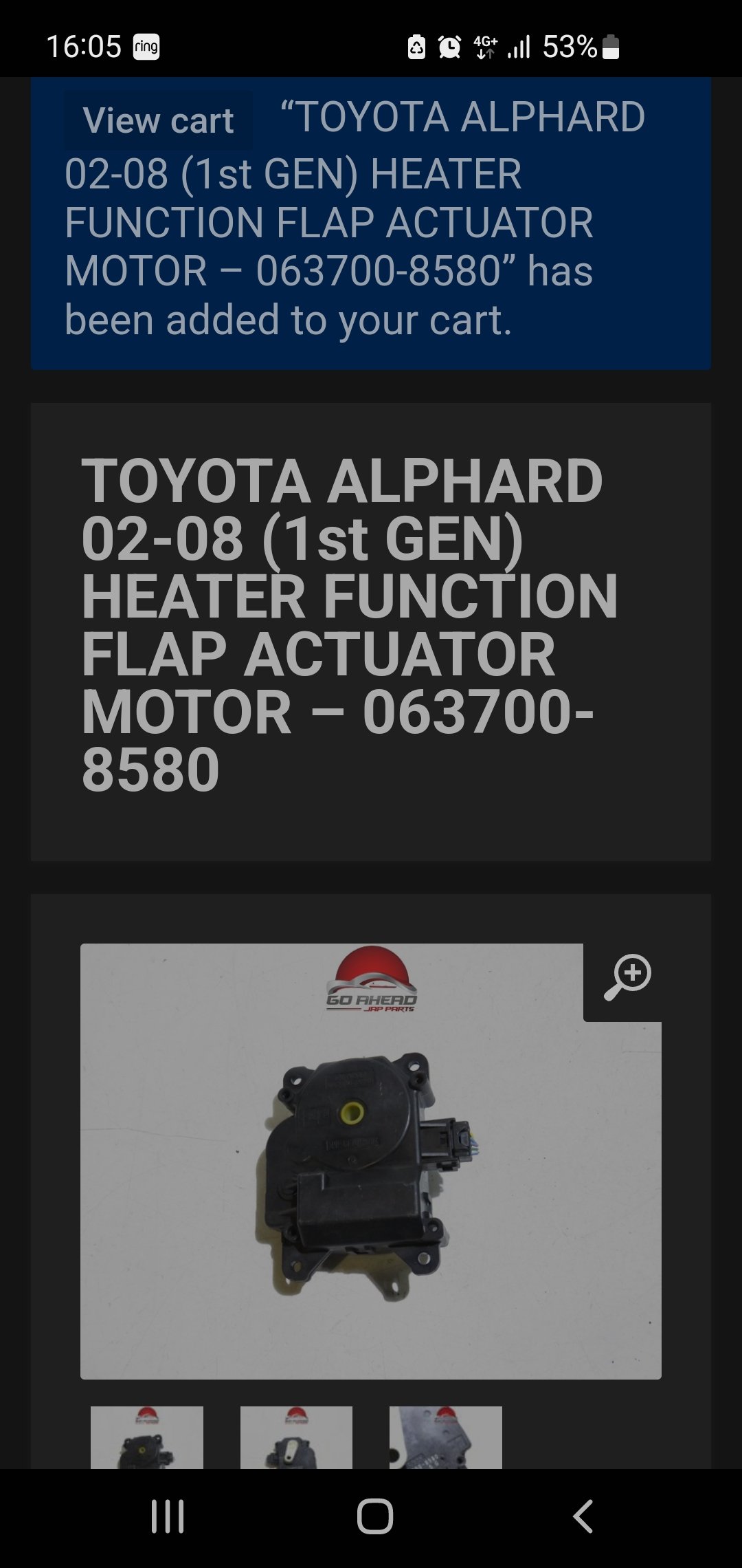

Hi air con is off water temp level normal o have narrowed it down to this part

Hi I have done this to no avail I have narrowed it down to this part as its not moving when changing temp from hot to cold but it's a nightmare getting to it 1419329721_Screenshot_20220629-160501_SamsungInternet.thumb.jpg.c70b5ede4bc176ac98d156368503b7e9.jpg

I have bled the system still no change narrowed it down to this part but very oukward getting to it

No luck by doing this have narrowed it down to.this part

Hi can anyone help my alphard 3.0 has started blowing cold air from heaters I have just got a lpg conversion done few days ago yesterday I put heating on and it's only blowing cold air out Temp is going up on dash any body no  what it could be I got a feeling its this part

Come to think of it, my actuator used to make noises on my ANH10 Alphard. So this could be the option too. But i do wonder if the rear heating is run from the same actuator??

i still had heat, so left it, but unless i had it right down or all the way up it would make a juddering noise.
I stuck my head underneath  centre consol and looked up to the heat controller to see it moving, so maybe you can try and see if you can see it moving if you adjust the temperature. But you see the rear ones may have their own... not sure, if the rear gets warm them it could be the front actuator.

I thought of that but even rear is blowing cold air but then also the heat will come from front first then will get circulated to rear im looking for someone who can do this job for me now I will keep everyone informed not to bad at the moment as its the summer season

Took my Alphard in to my usual repair shop with same problem. They tried all usual stuff and came to same conclusion. Heater flap actuator. They are struggling to find a replacement part. Second hand ones on internet seem to be different part number from the one on here. Anyone know of a dependable part supplier?
I think you might find that this is the same part number for the same item that belongs to a Toyota Avensis 2003. Have you taken the old unit out of the Alphard yet, if you have it might be a good idea to open it up and check it out. The reason I say this is that it might just need the contacts cleaning. Hopefully this is of some help.
