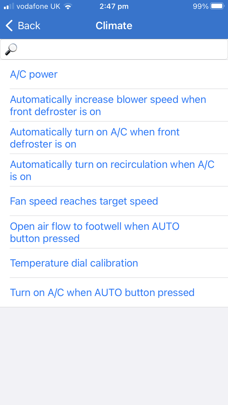

    I spent a bit of time going though the screens today in the car scanner app.    I’ll attach some screenshots of the various options.    This is what I see when I’ve got the app paired to

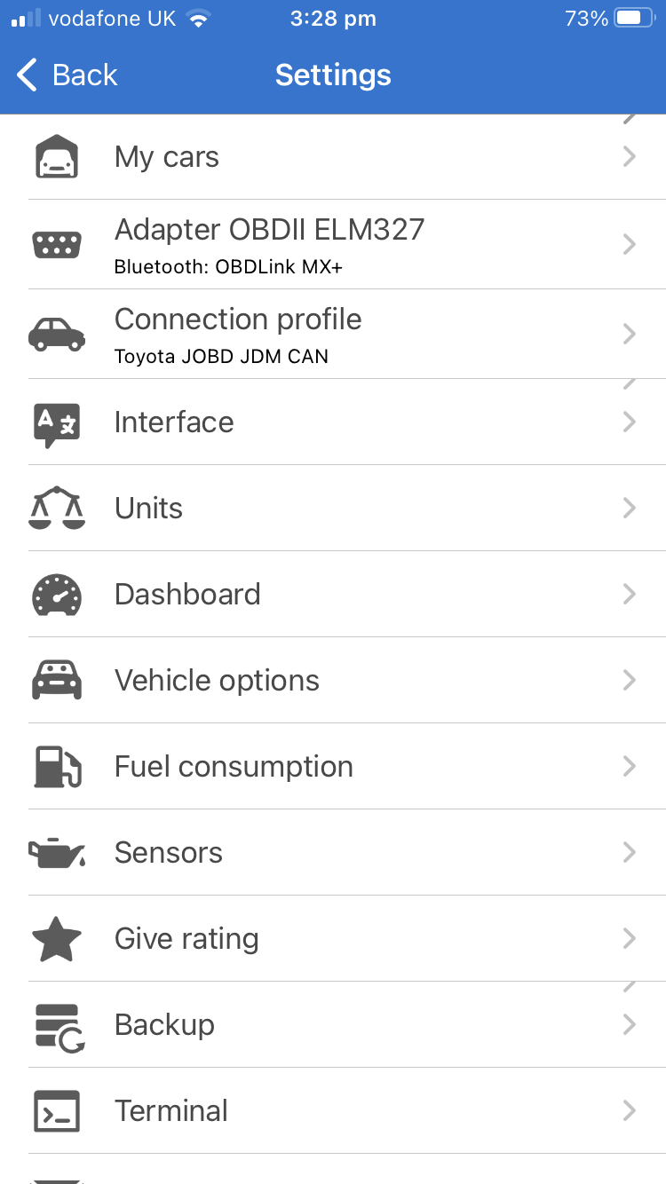

I should of added:
In the Car Scanner app the connection profile I selected was “Toyota JOBD JDM CAN”.

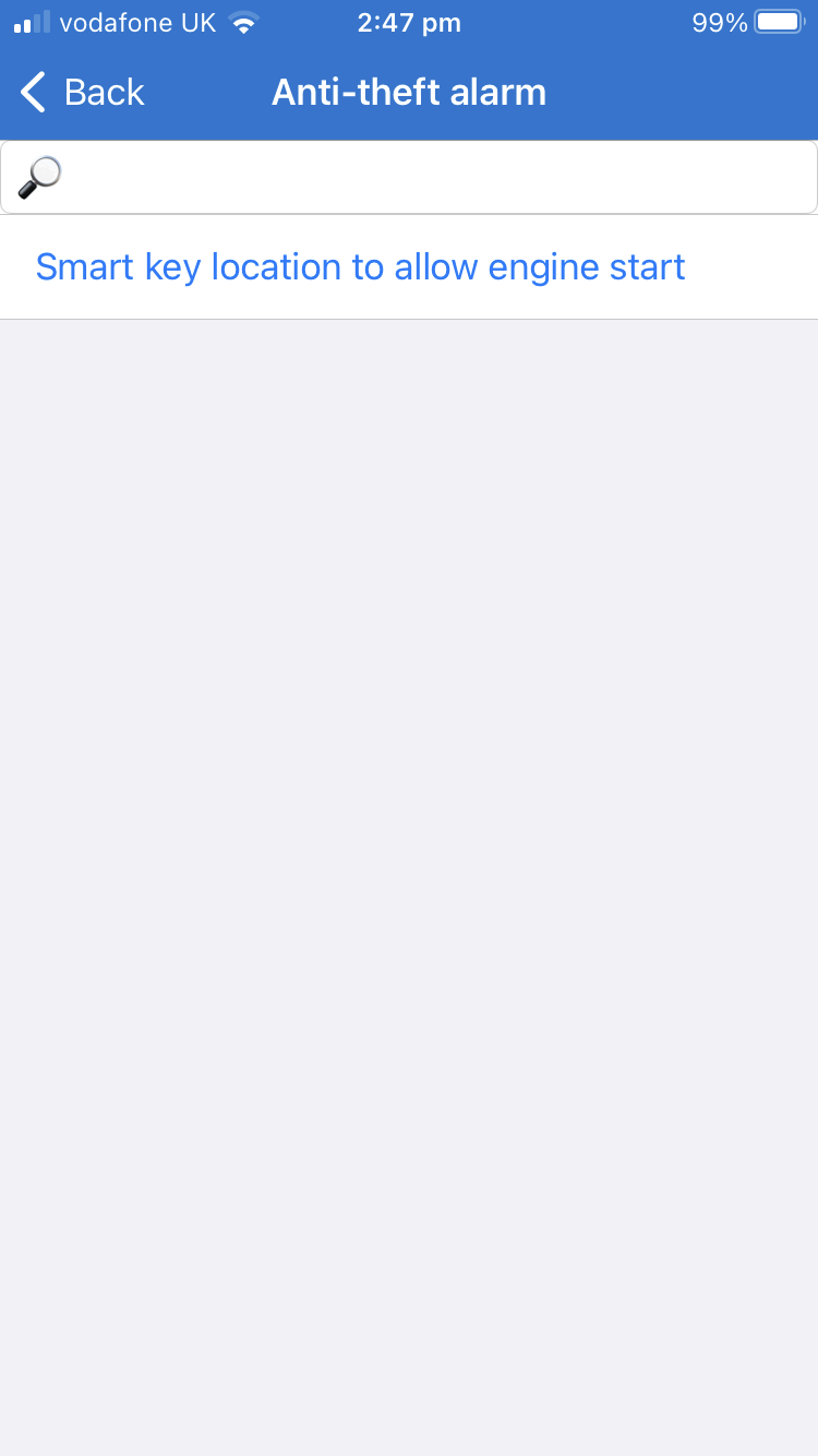

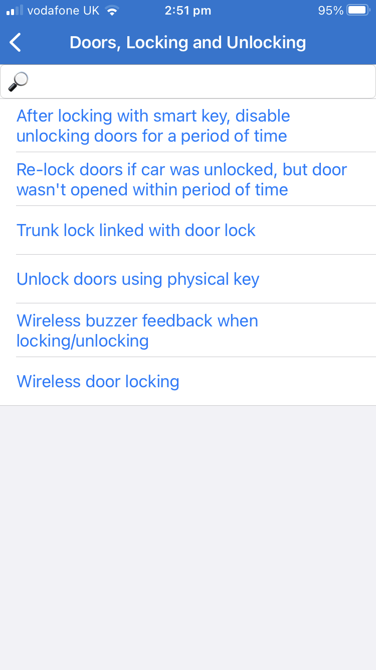

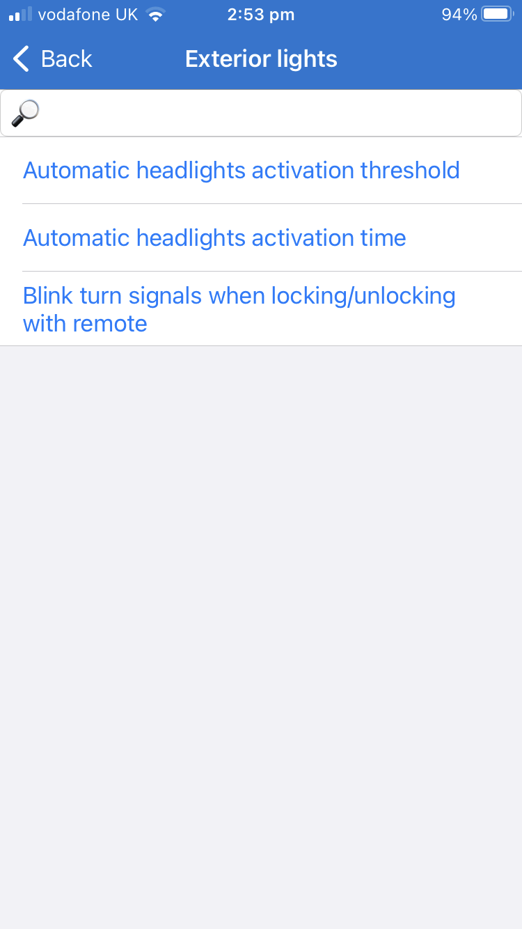

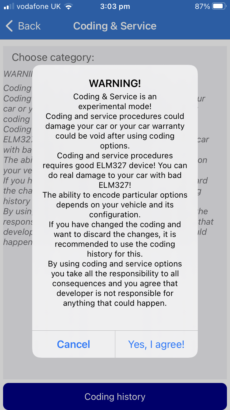

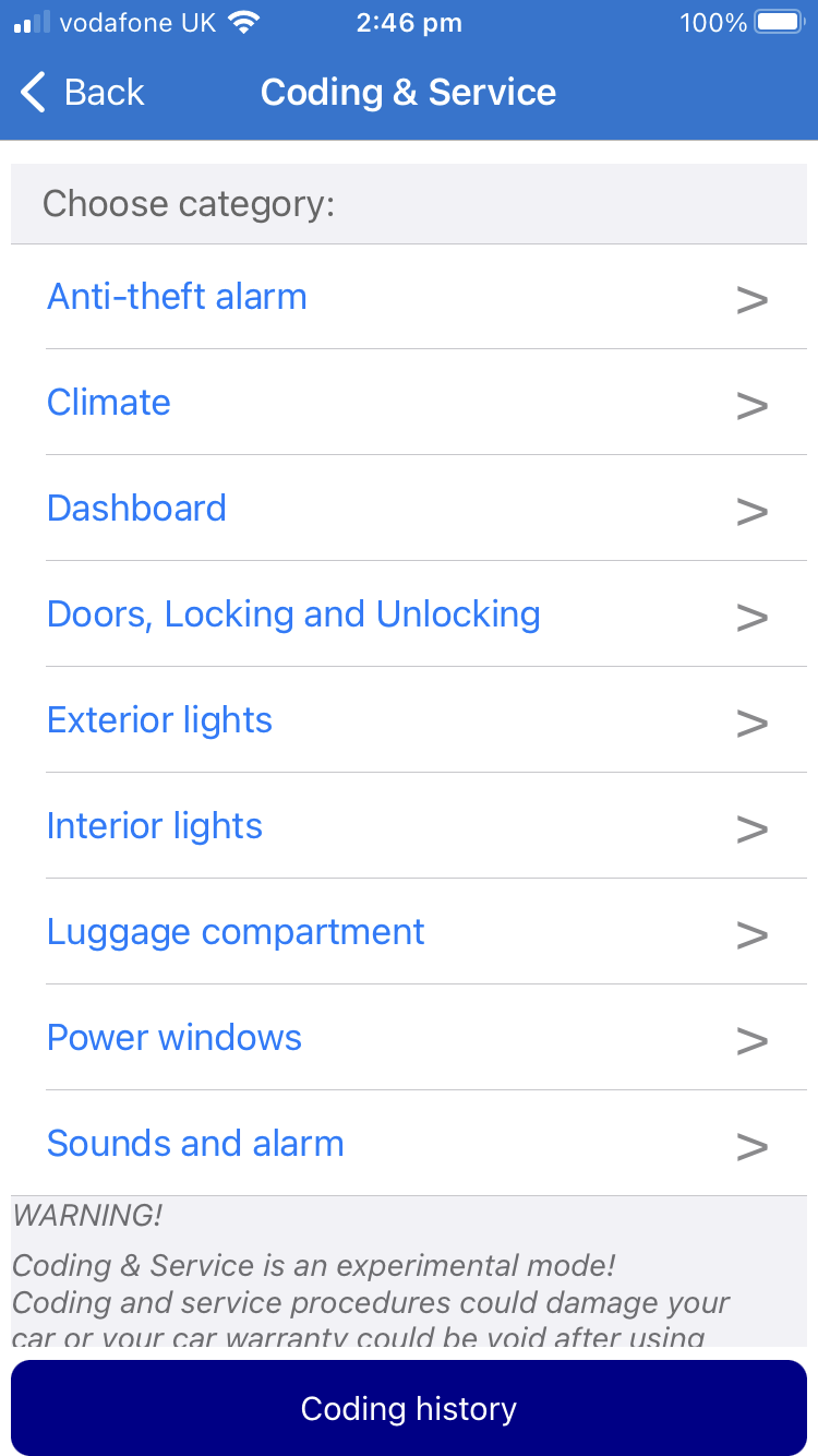

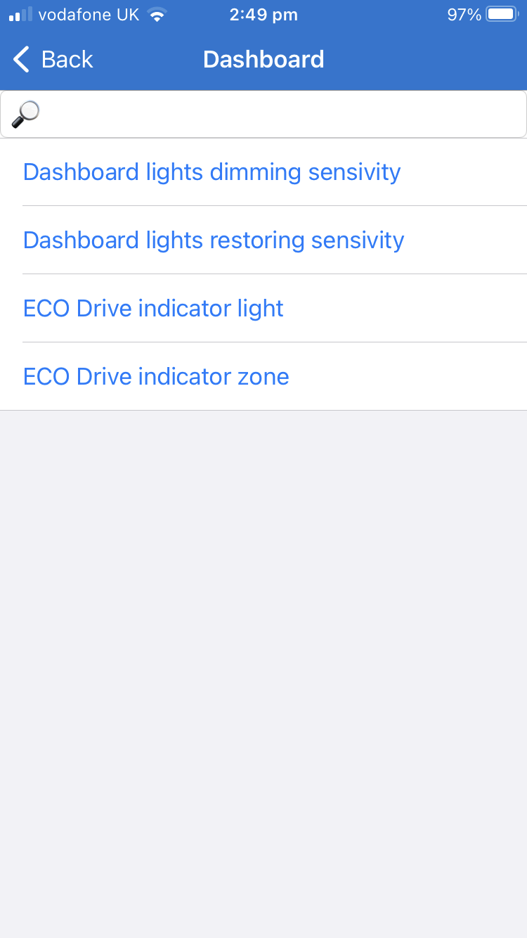

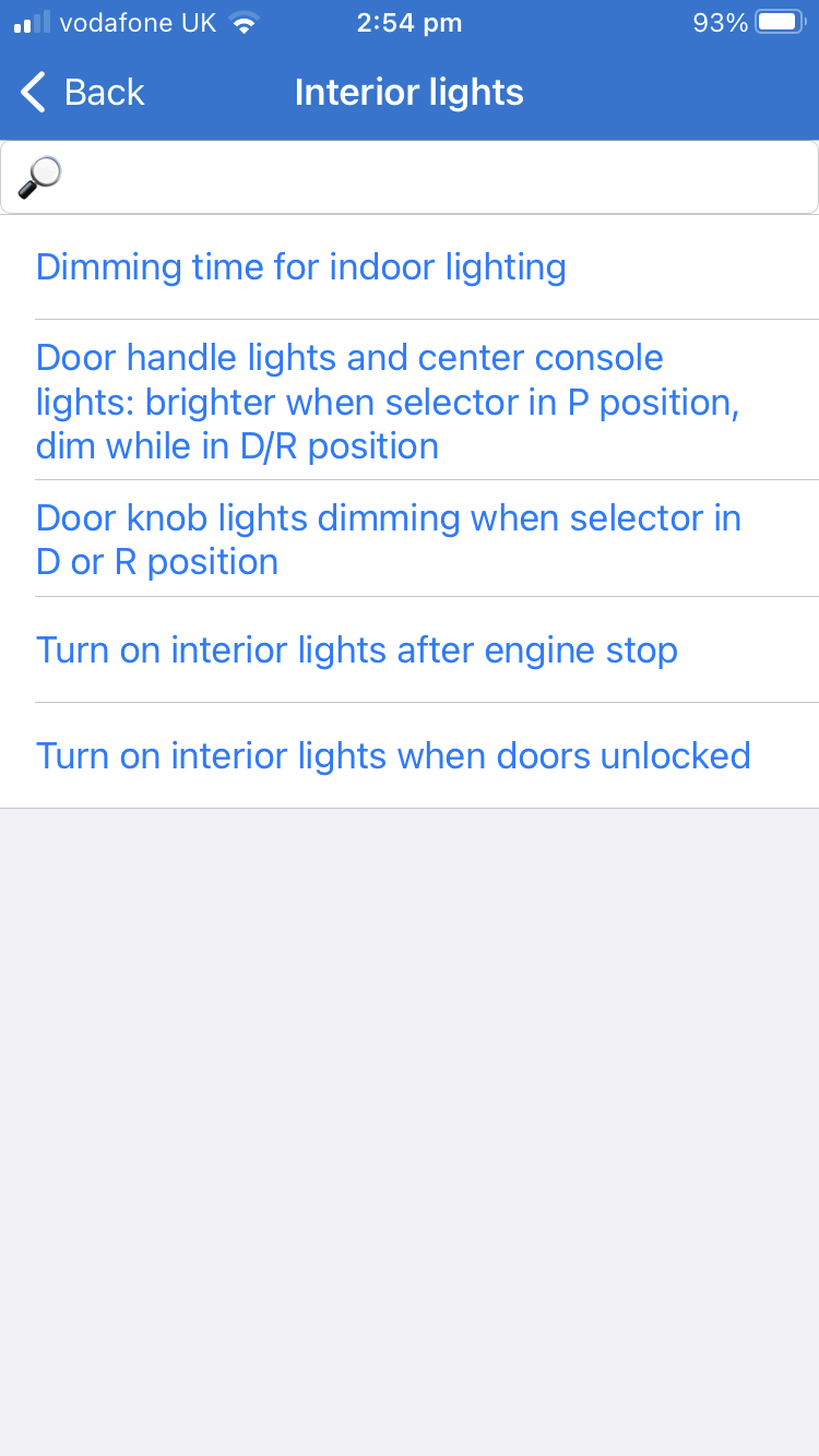

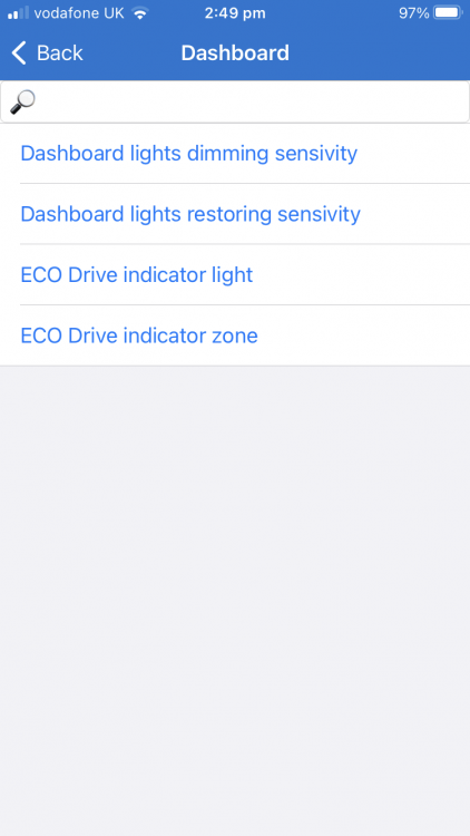

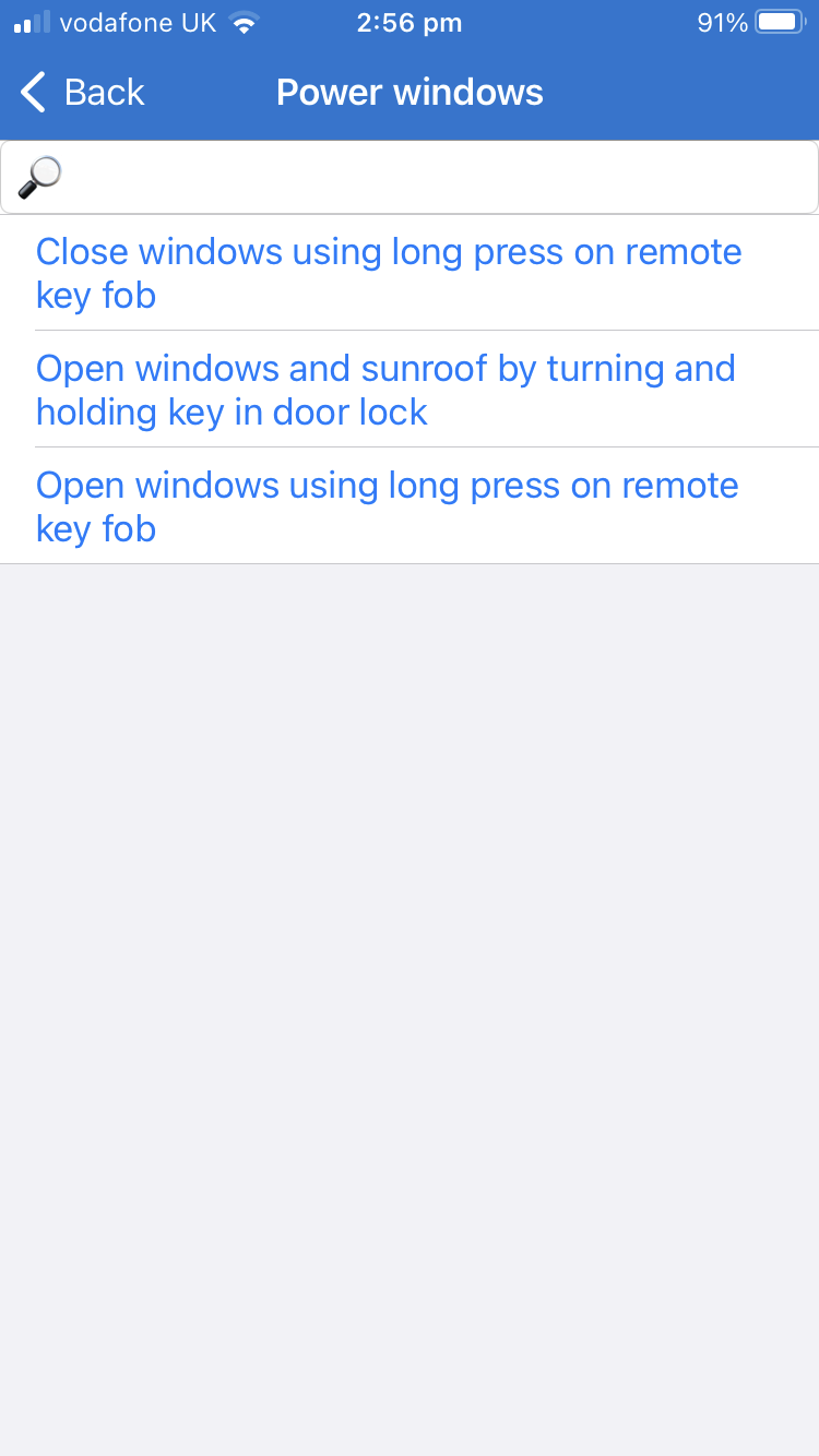

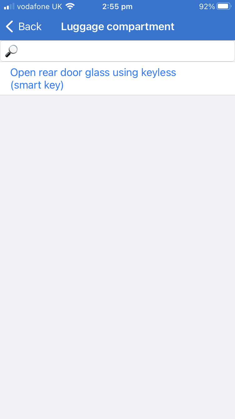

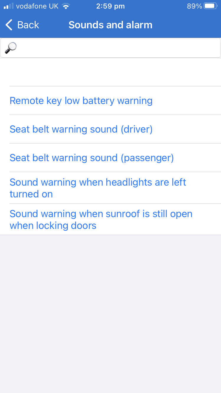

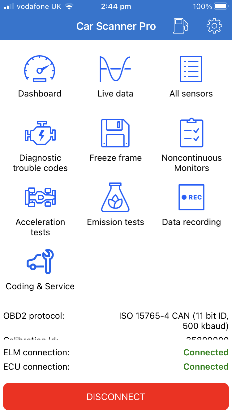

This is what I see when I’ve got the app paired to the car.
I click coding and service and get this warning.
Click yes and I get this.
Then within these options are the following.
Obviously, it will be different for other models but that is what I see for mine.
I can now open and shut all the windows remotely from the key fob, which is nice.

This looks excellent. Thanks for the time taking the screen shots. There are a few options on their that I think should have been done already, but maybe Toyota Japan sells them as options.
Some of them don’t make sense for my car.
Such as, I don’t have a sun roof but I can be warned if it’s left open. I guess it’s a standard list for the model.
I don’t have door handle lights or doorknob lights, whatever they are.
Door handle lights are actually behind the pull handles, I have seen these sold on aliexpress, so may have been an option of the 's' model (that had lots of LED lighting under consoles etc.
