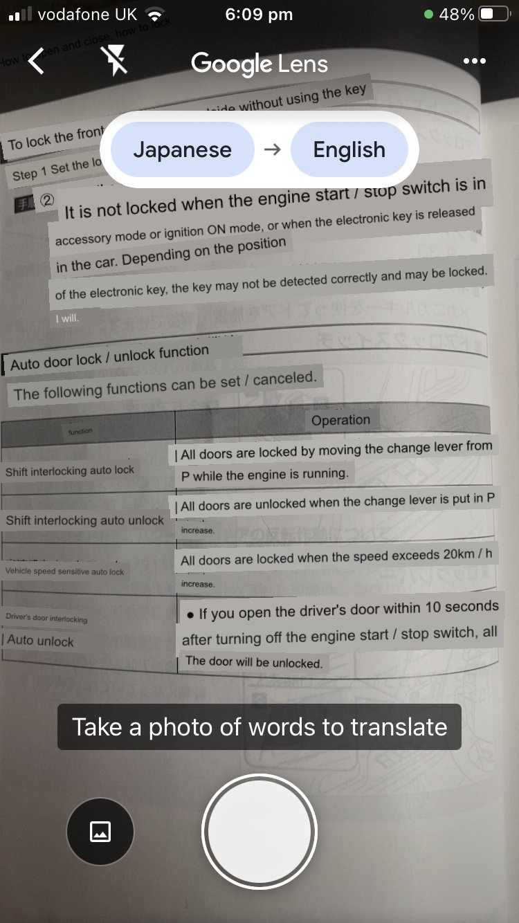

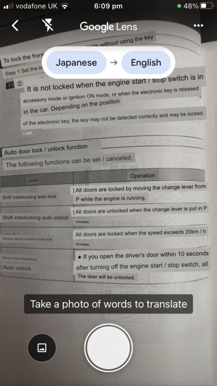

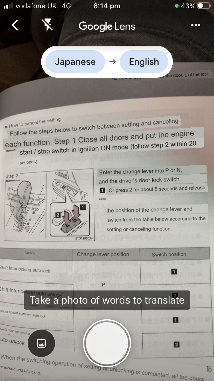

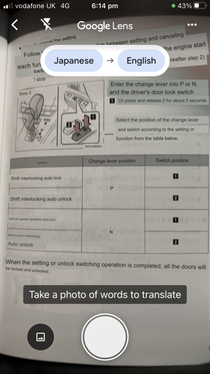

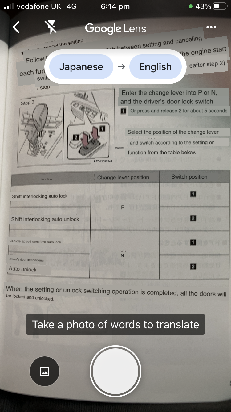

On 7/22/2022 at 7:46 PM, Voodoo101 said:
I was hoping that there was an option on car scanner to stop the central locking activating when you start driving, but no option for that either.
Apologies for not getting back sooner, this weekend has been unexpectedly hectic. Back to work tomorrow for a rest though.
Anyway, my car locks the doors when I get up to a certain speed, I think this is what you want to turn off?
My manual calls it “Vehicle speed sensitive auto lock”.
Here are the other options you can set or cancel.
And the procedure is here:
So I think it’s like this.
Get in car
Shut door
Press engine start switch twice without touching brake pedal
Shift to neutral
Press lock button on drivers door for 5 seconds
Locks should operate to confirm you have set or cancelled the auto speed locking.
Test drive to see if it’s worked.
