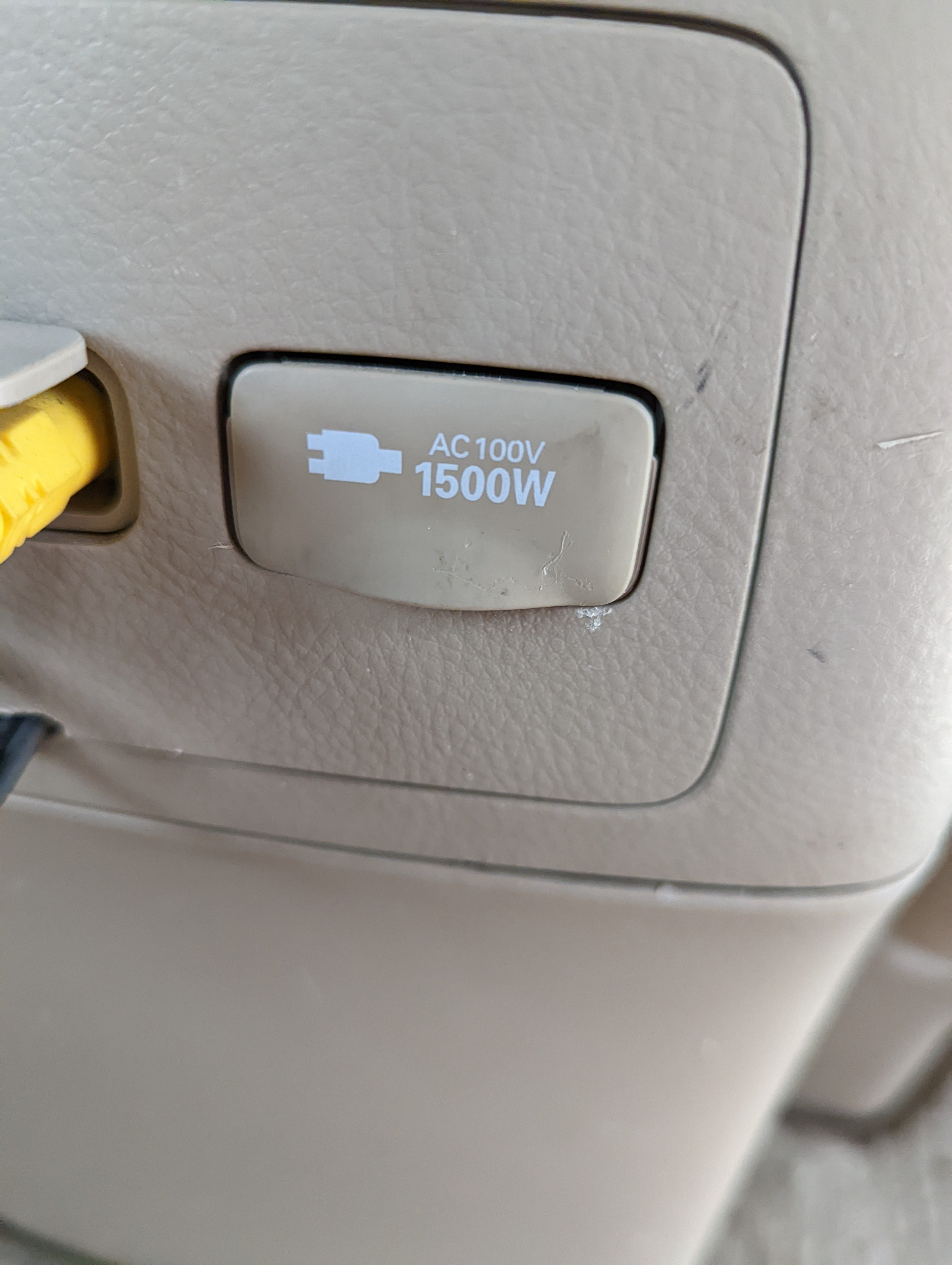

new owner and just picked up my 07 Alphard today. Lots of stuff for me to get stuck into (not least of which language setup) but I'm really impressed with all the gadgets and toys.
one thing I want to understand is the 1500W power connections I have a couple of. Does anyone know if I can somehow by an adaptor so I can get them to a USB female? Essentially for all the kids devices.
thanks

Hello Rich,
Welcome to the Forum, and Alphie ownership.
The 100v outlets are 100w, not 1500w.
The 100v outlets can be modified for USB.
Keep searching, it's on here somewhere.

Hmmm. Mine definitely say 1500w. Is it the same thing? Apologies if I'm being stupid.
Apologies.
I have no experience with these later vehicles.
Despite what it says, I wouldn't try to pull 1500 watts
If P equals I times V, that Power, Current, Volts. Then I equals P/V.
1500 watts is 15 amps. Where is that 15 amps coming from ?
I guess it can only be coming from your Hybrid battery !
Proceed with care.
Earlier Alphards/Vellfires do have 100w 100V outlets as noted by the photo above.
