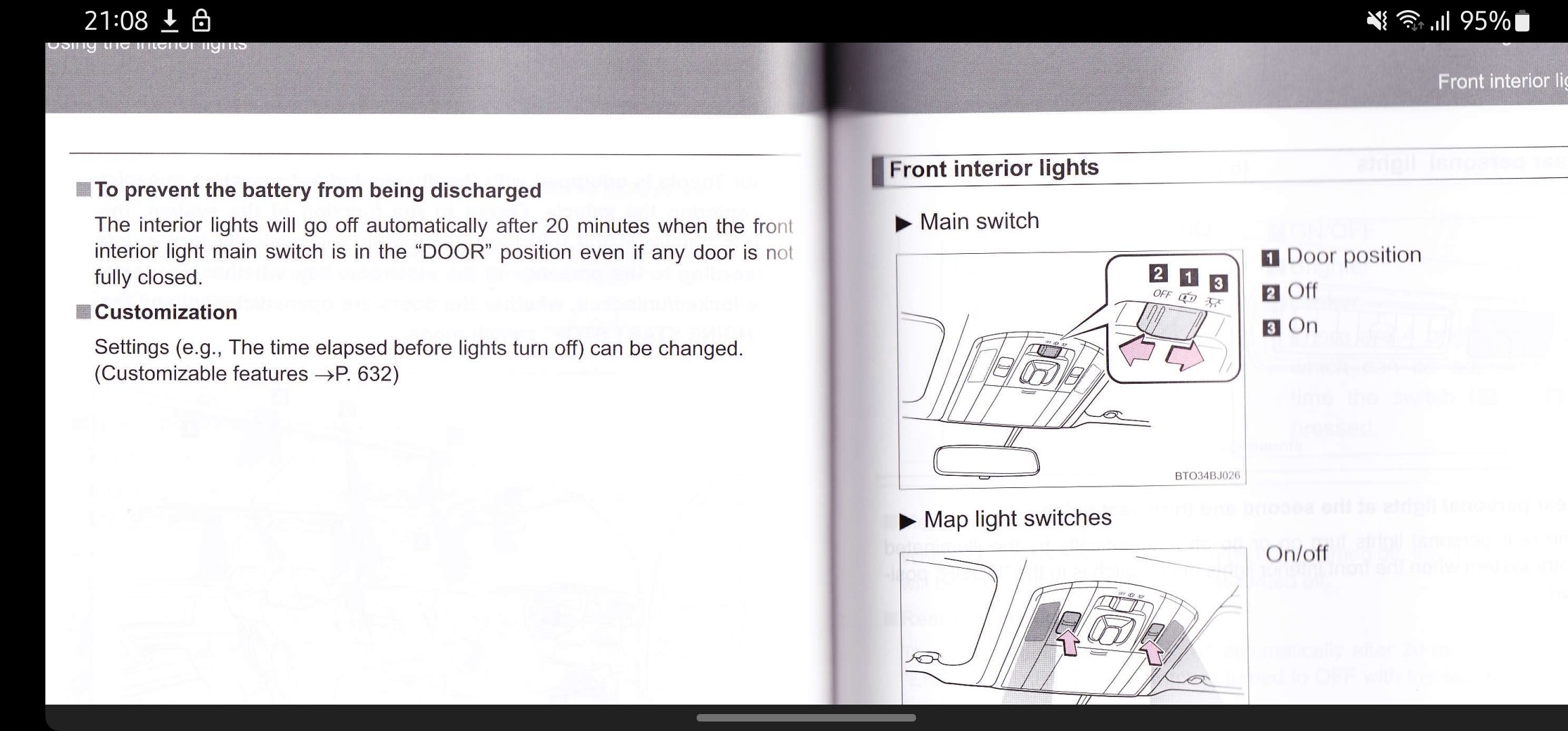

Will they turn off after a certain time after the door being opened,  not tried it myself but interested too see as where looking too camp in ours soon.
