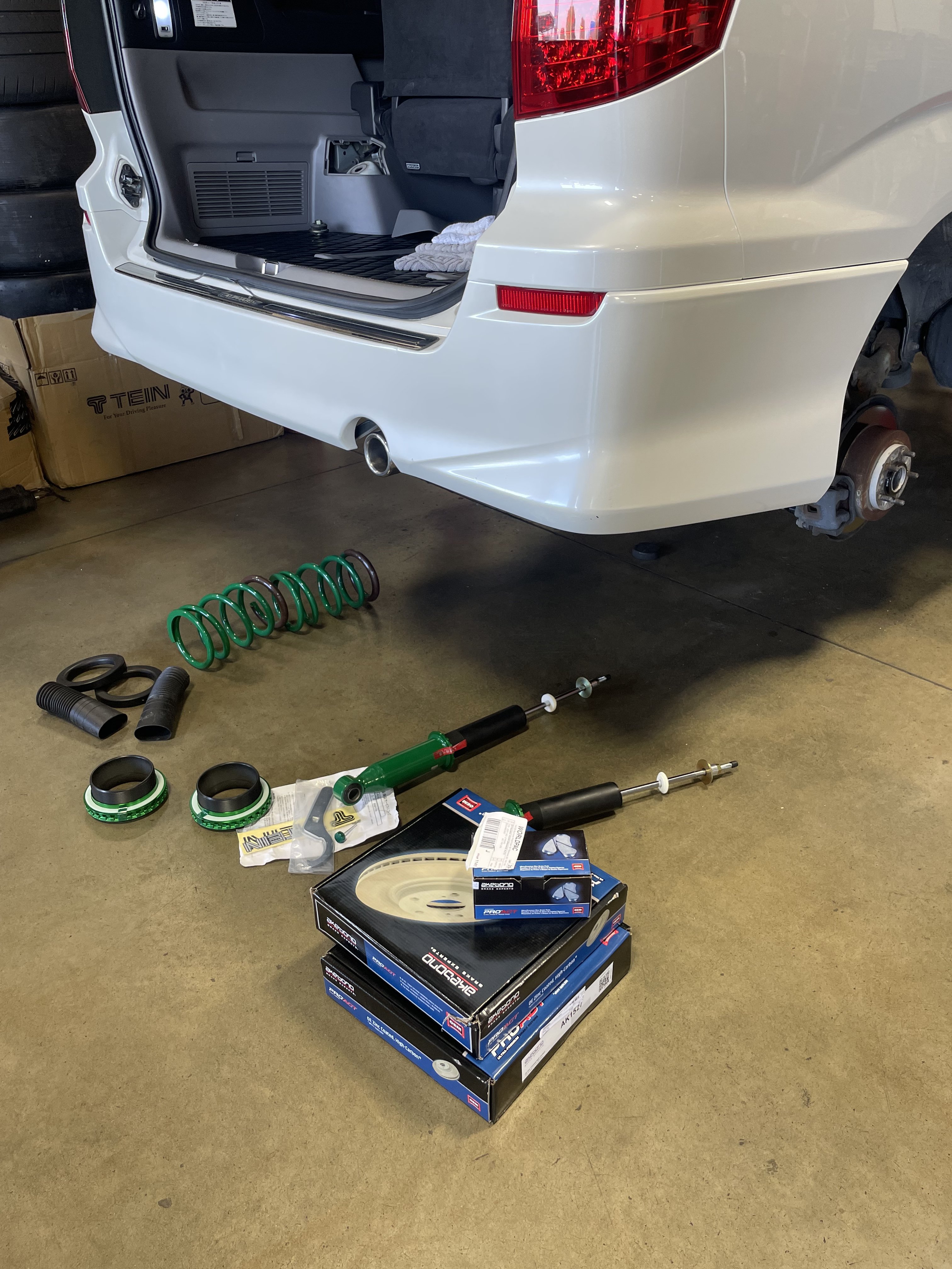

I change all the rotors and pads last fall to Akebono in Canada here.
I’m located bc, canada. So what excatly you have used? akebono is being sell in lordco right?
Cool! I’m in Vancouver. Call Dynamic Performance in Richmond ask for Edwin. Their service and prices are great.  If you are DIY they can order the parts only.
