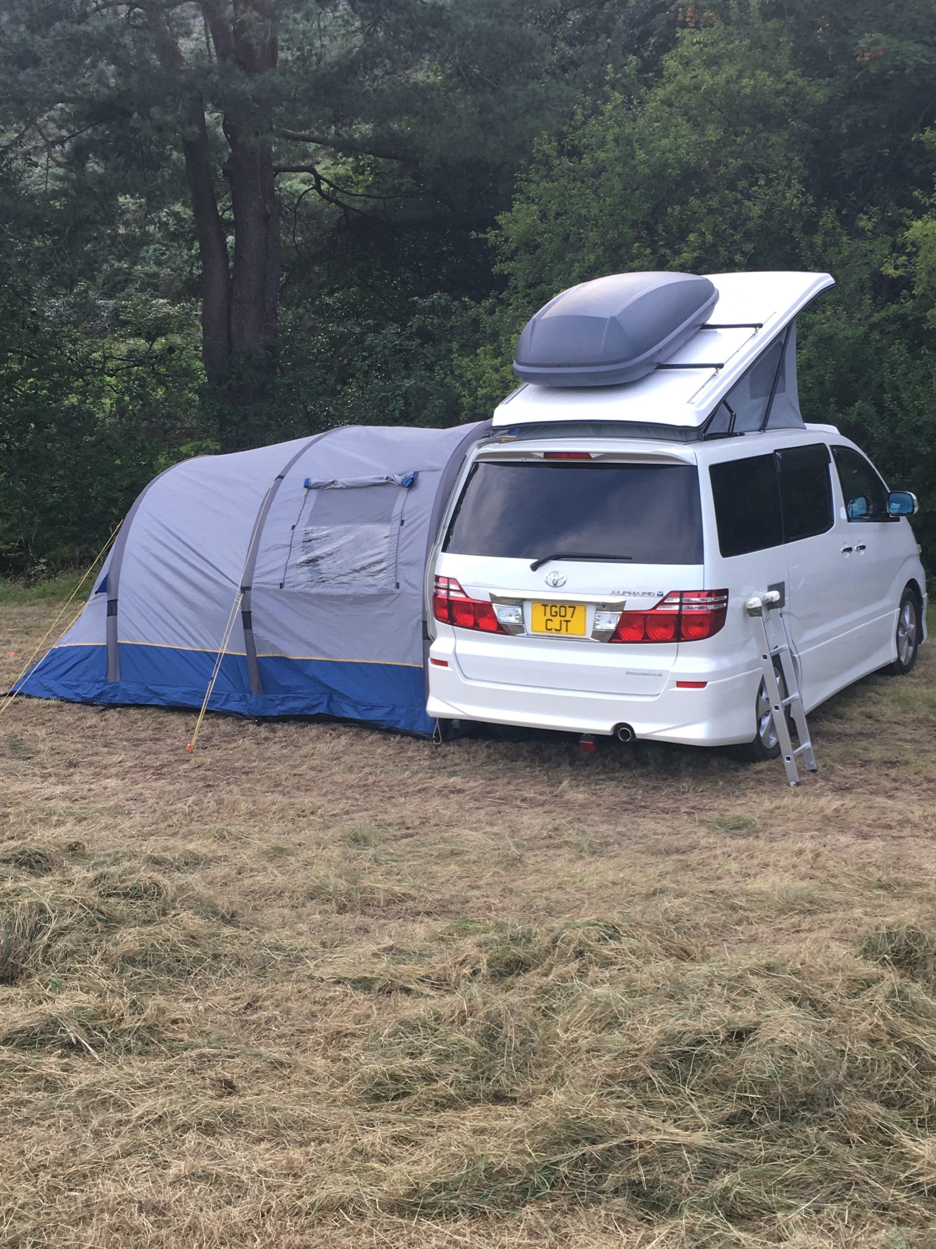

Yes I did!
I used 2 aluminium airline lashing rails 2.0 mts long and 4 single screw fittings.
I got them on Amazon From a company called NTG in Europe.
I fixed them using the existing bolts for the pop up roof.
Mir was fiddly as I hadn’t done this before but works really well.

I’ve successfully managed to fit roof rails to my pop up roof using existing bolts as per the attached photo.
let me know if this helps?

we have an Alphard camper conversion and notice that you have an awnin attached in your picture. How did you attach and what kit did you use please?
Hi Bartie
We bought a 4 man tent an Airgo Horizon 4 just prior to getting the van.
Not wanting to throw it out, we decided to make it work as an awning.
we bought some tent fabric and Velcro and with a lot of measuring and sewing, managed to make an attachment which separates the tent from the van, but is wide enough so that the door can be opened and closed.
We used heavy duty tool magnets from Lidl which cost about £3.00 each to hold the fabric on the van roof.  Even a hurricane won’t lift this off!
Sorry if you thought it was a bespoke awning, but if your handy you too could make this.

thanks for your swift reply. Sounds good. We actually have a driveaway air awning and have purchased a magnetic strip with Kador and figure of 8 strips to hold awning on but seems flimsy! The tool magnets sound a good idea- would you be able to send us a close up pic please? Many thanks.
Hi Bartie
we bought one of those but it was useless and wouldn’t work efficiently especially in windy conditions.
it’s called Lidl magnetic strip. I saw some in our store today so they are still available.
I meant the Kador kit was useless. The magnet strips are fantastic. I use 4 but it’s a bit overkill. They’re mych easier to fix and remove.

we sewed some fabric pockets on the edge of our awning so that we could just slide the strip magnets into. Works a treat!
