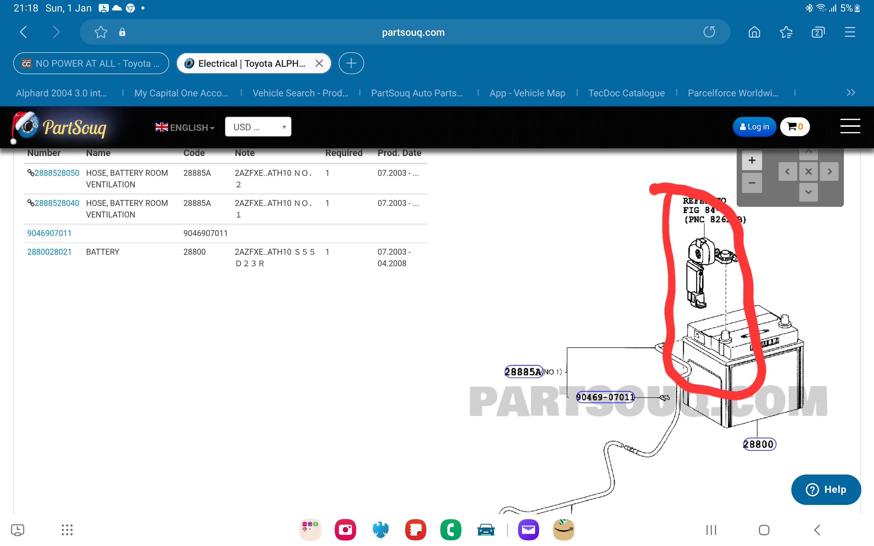

Have you bought correct battery meaning is it a standard battery of the shelf normal motor factor's or is it a genuine one from toyota what's the part no. Of the battery or if you don't mind tell how much you pay for it .
It’s a Bosch like the one that was already on, it was about £100
OK I'm sure you have blown a fuse I have attached a drawing from lookup system can you please confirm the bit circled in red is fitted to your battery should be positive side
Thank you for this!
I will take a photo tomorrow
I do remember seeing quite a bit of parafanalia on that side. But will get a pic for you to see.
thank you
I'm sure it's there it's called a. FUSEABLE LINK. it's the main fuse this is sealed unit and can not be taken a part this is the fuse you have blown your auto electrician will confirm this this part only avaliable from toyota only and won't get it from anywhere else the part no. You need is. 8262058020. This should cost no more than about £60 or less please don't let auto electrician try to bodge the fuse link as you can cause a lot more problems

I’m told it does have this part on it.
