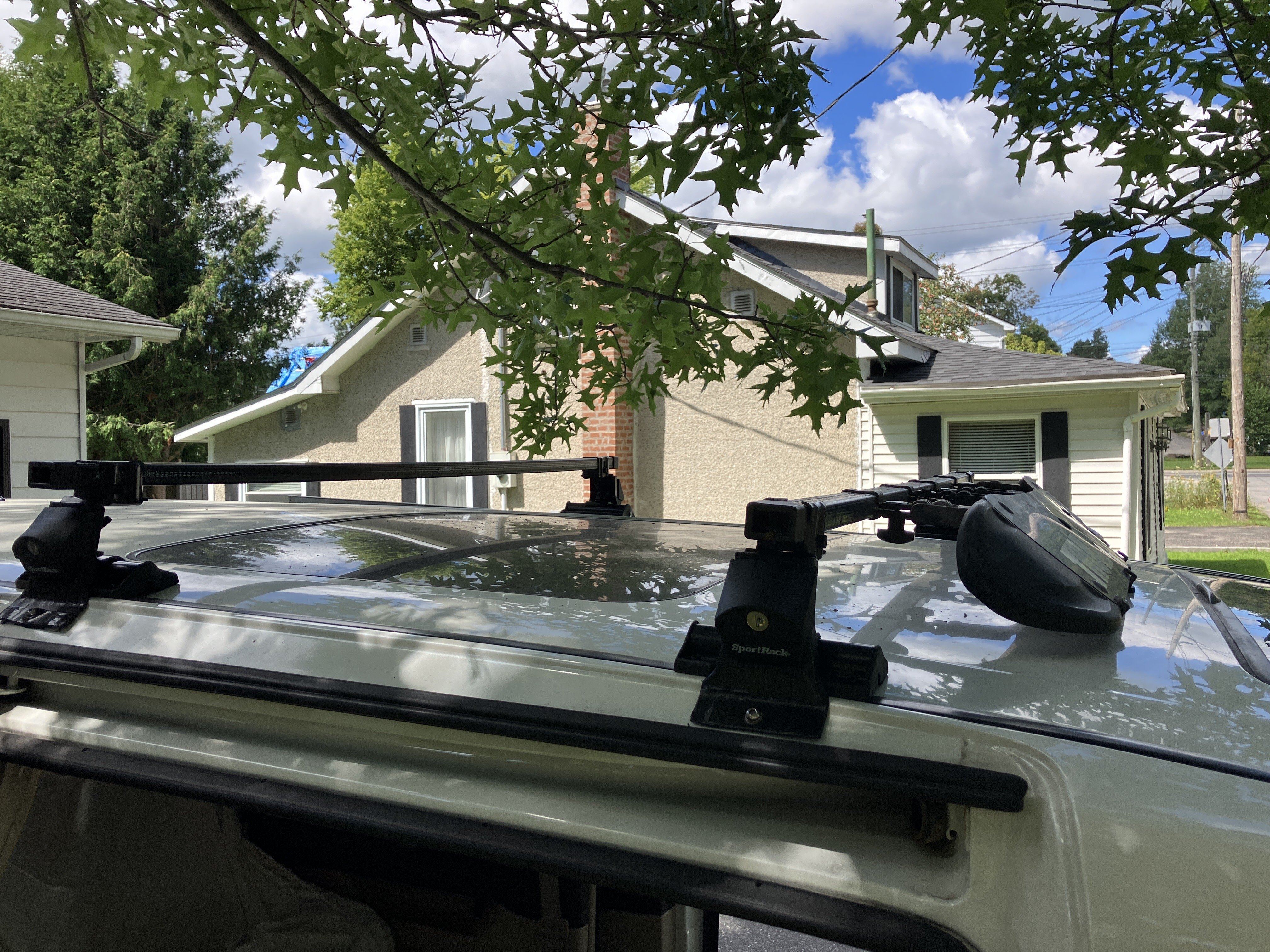

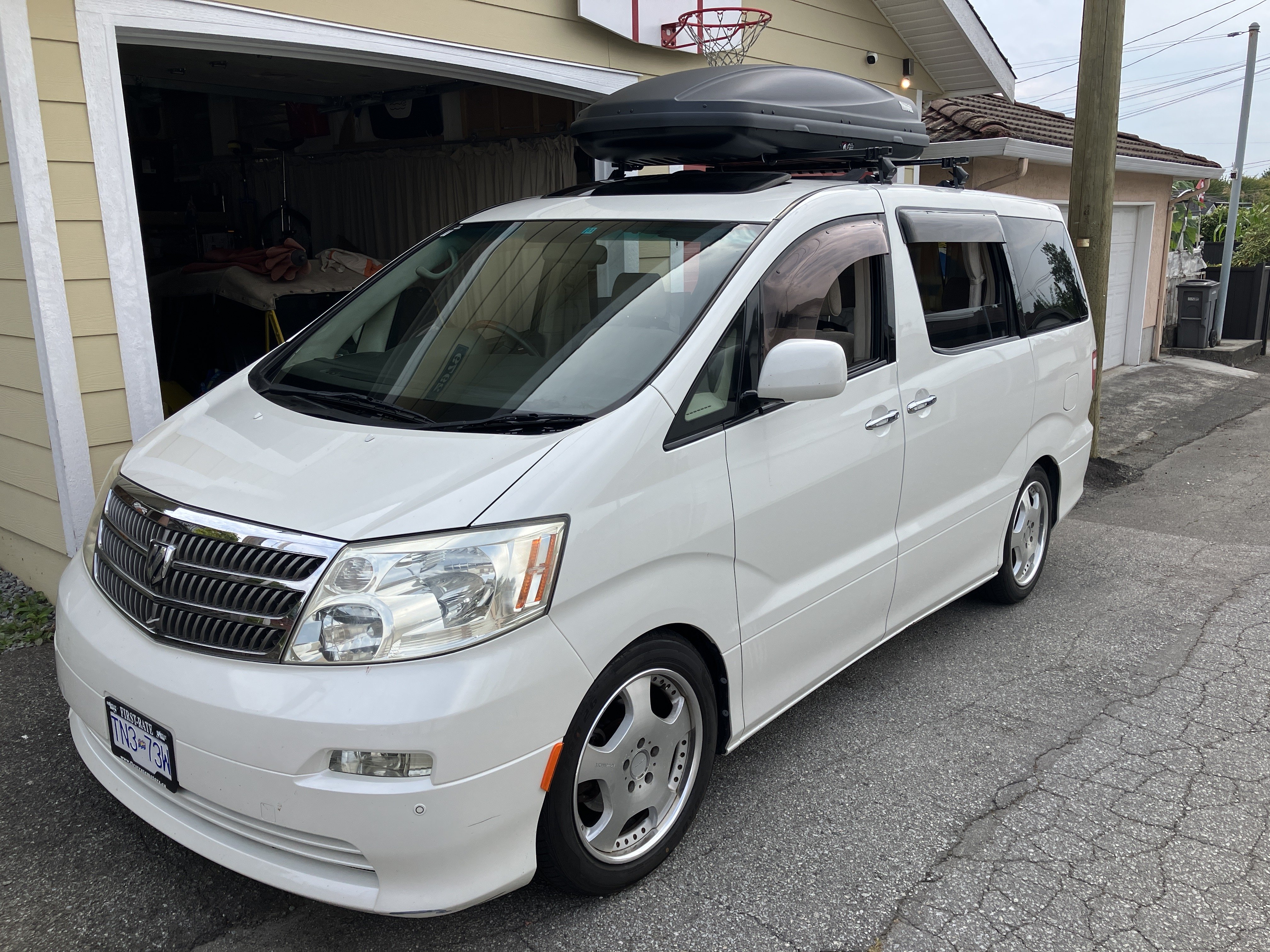

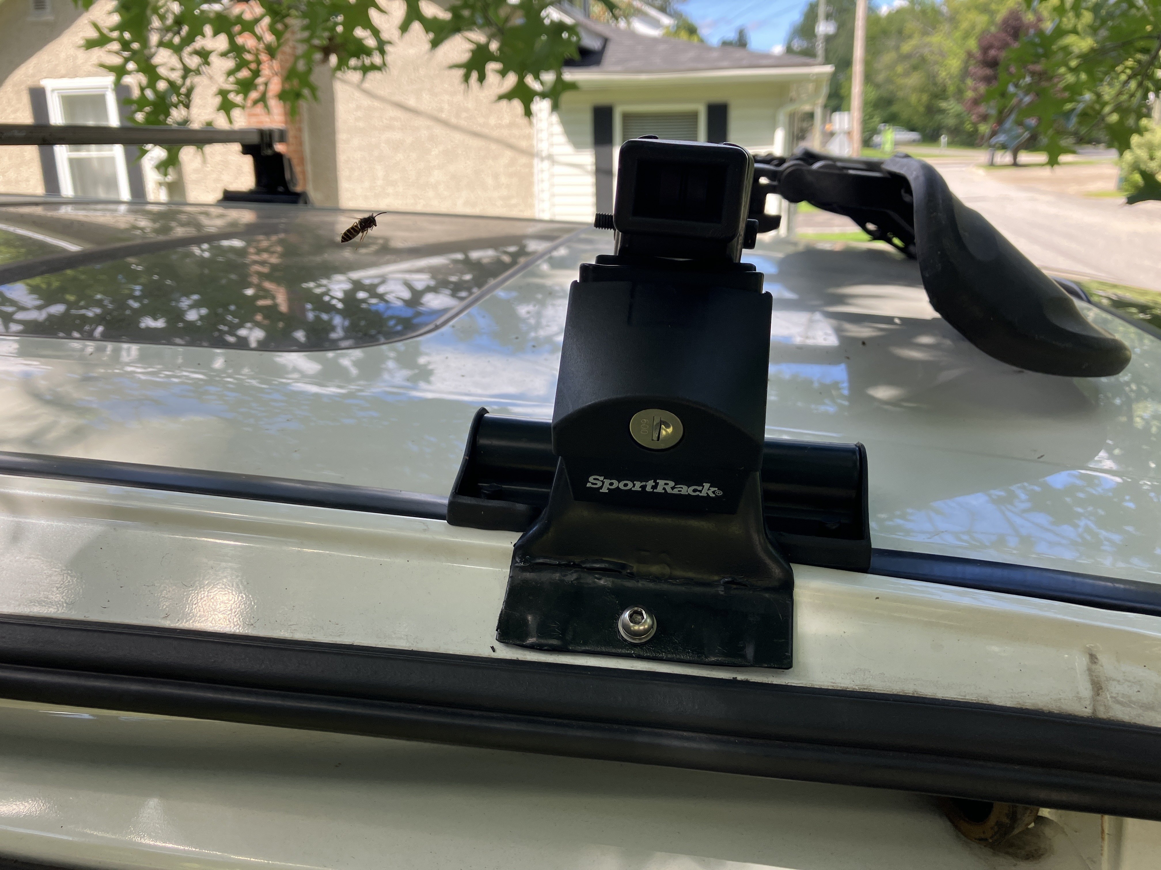

IMG_0729.thumb.jpeg.9f32530f70a232ad534580355c58da6e.jpegI just installed a rack on my 2003 MNH-15. I bought a SportRack SR1002 and modified the grip plates to follow the contour of the sliding door jamb. I used M12 cap screws to anchor the plates into the factory captive nuts.

Hi Jeff, that looks great. I'm also about to attempt a fitting on a series 10 Alphard , and the only bit that surprises me about your set up is the spec of the bolt holding the fitting plate to the roof, which you've said is an M12. Are you sure about that? I was thinking it was an M6....
Iain,
I think I was mistaken. It must be an M6 I agree.  Whatever fits the captive but in the body.

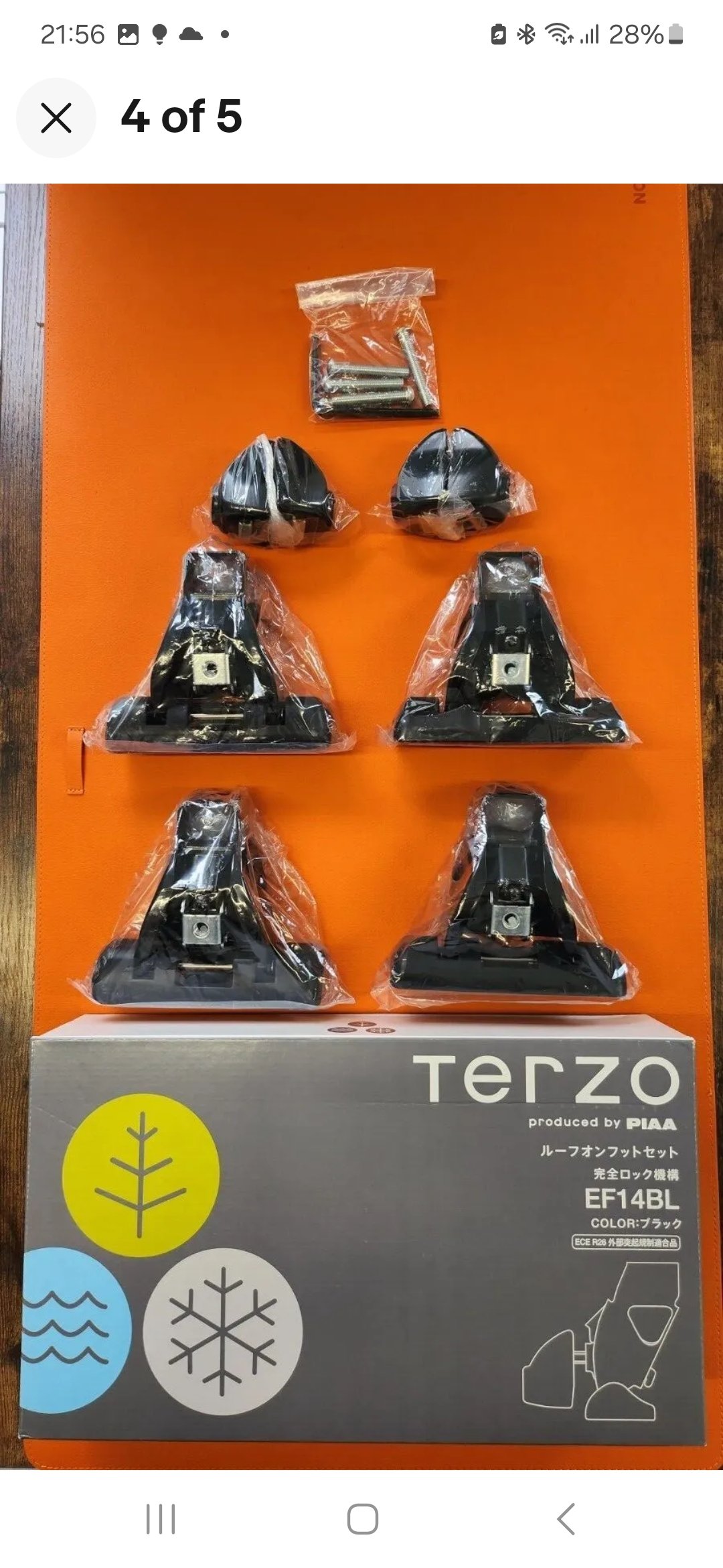

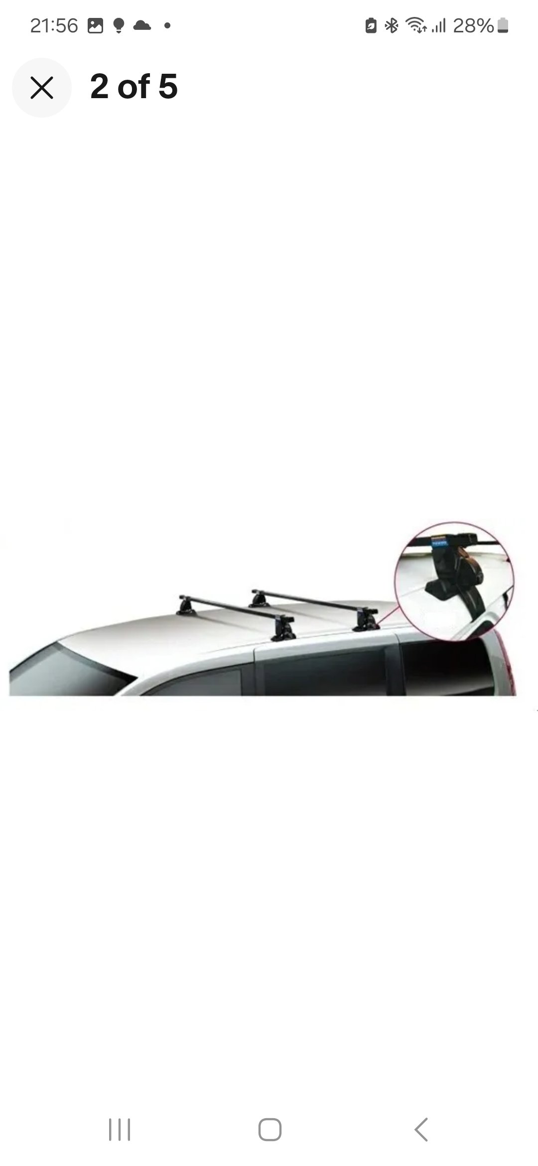

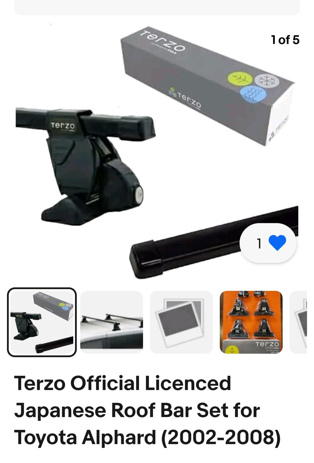

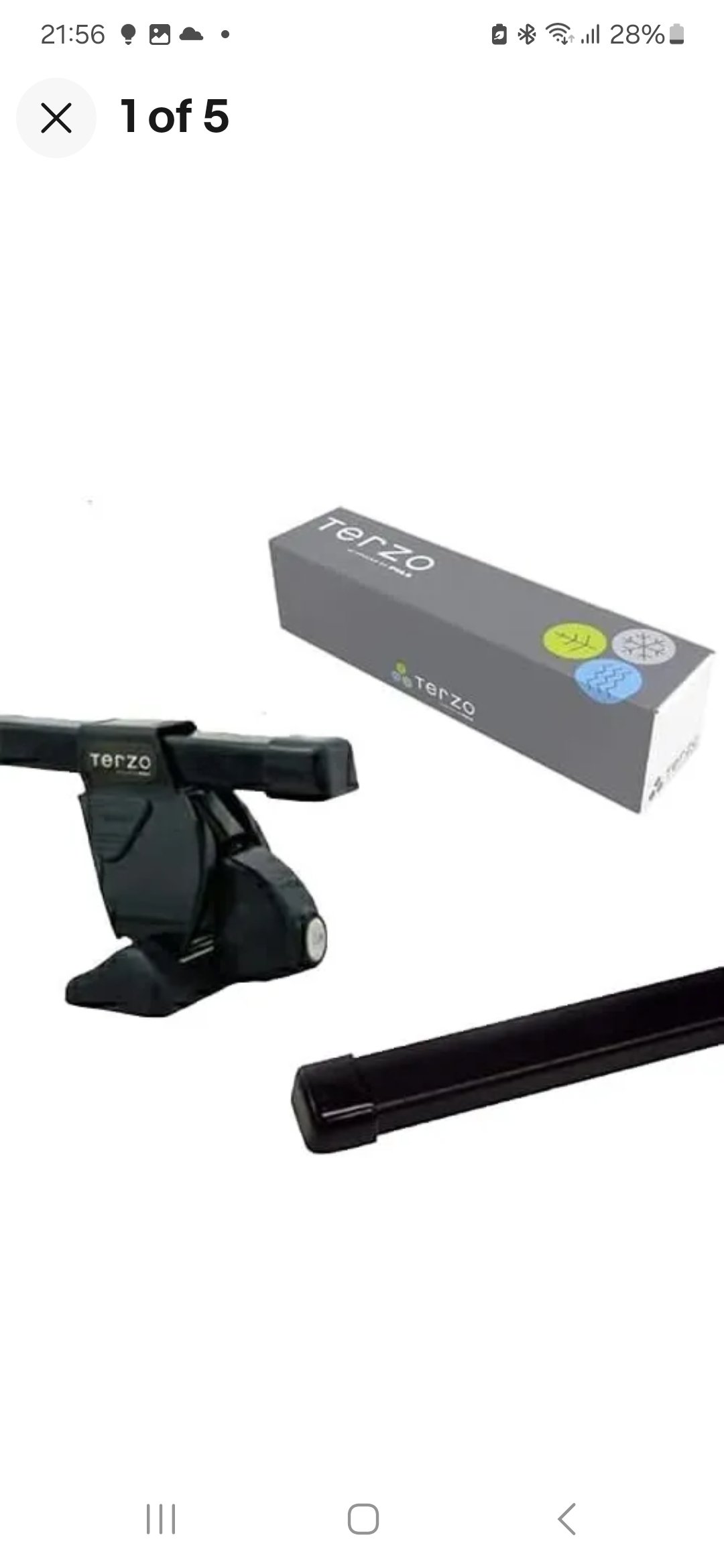

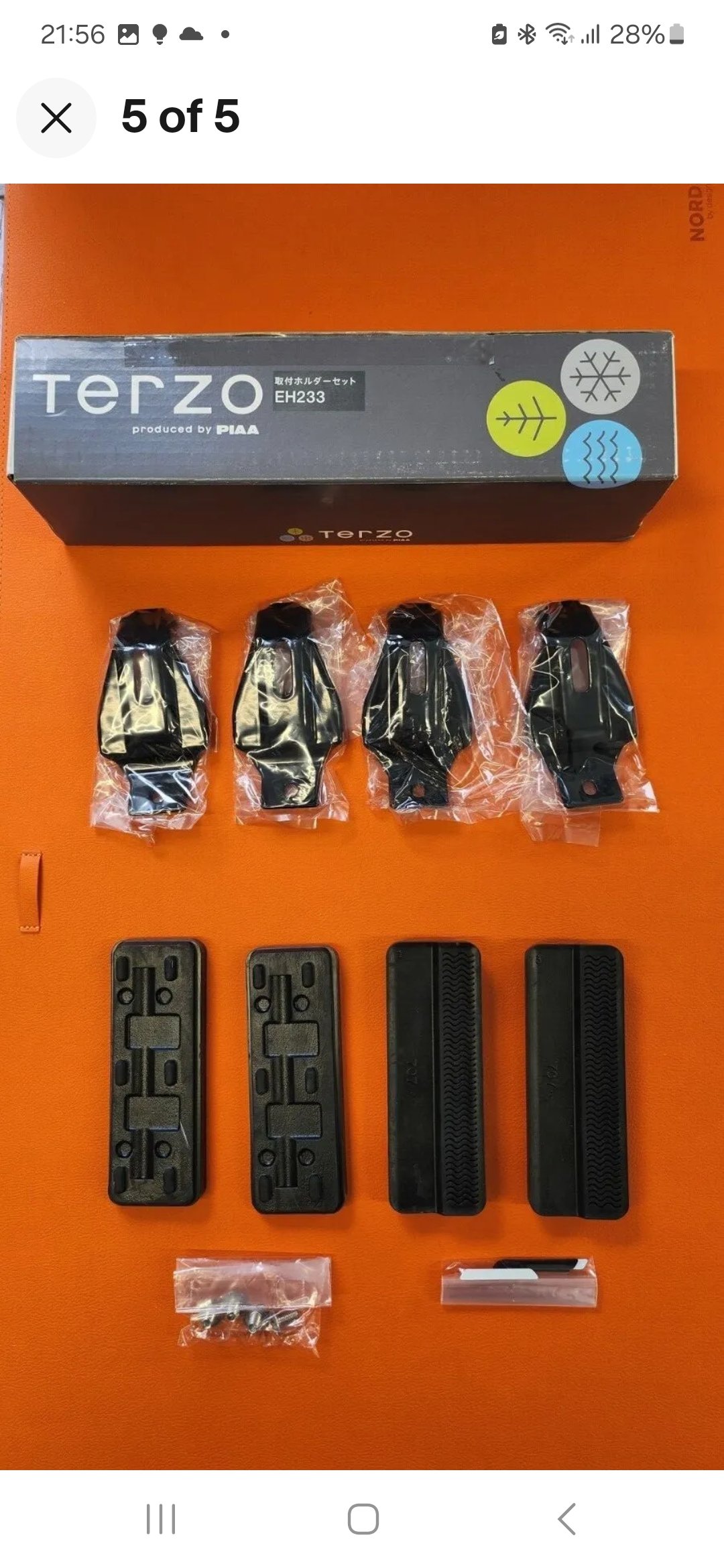

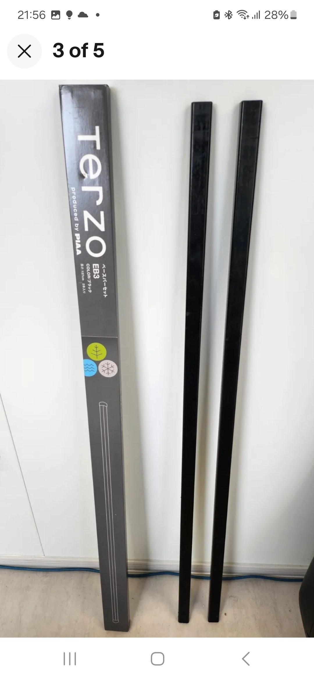

I have a set of roof bars for sale. I purchased last year and only used once before my alphard battery died on me. I no longer have the vehicle.
Edited by Merlin
To add pictures
