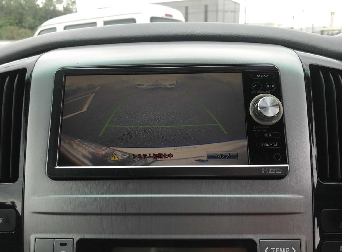

Hi everyone, I took delivery of my 2006 3L Thursday last week. I have managed to connect my phone for calls only, has anyone got experience with this type of head unit and is it possible to to stream music and hear maps through the stereo?
Any help will be appreciated
Ryan

I do not think GPS will work here. The rest can be worked out with google translate on your phone. Mine has a different head unit. I did it with google translate personally. If it is not a hybrid vehicle then you are better off getting a UK head unit installed than Bob's your Uncle.

Looks like a Japanese head unit.
Sat Nav will not work, as it won't be able to communicate with the correct satellite.

Thanks all for your replies, so no simple way of way of streaming Spotify through the Bluetooth then?
Was hoping I wouldn't have to swap the stereo out straight away but if that's the option I'll have to order one up.

Have you tried your video input on the back of your centre console ?
If you can get a analogue Spotify audio signal out of any device, that should work.

That's not a bad idea, I have the input on the front of mine. So will give that a go. I knew I'd have to replace it at some point just maybe in a month or so.
In the 4 days I've had the car it's the only thing that's stumped me 😅

I couldn't be bothered with all the hassle of changing the head unit on ours, so I bought a decent FM transmitter, which have improved over the years, plugged it in the cigarette socket, set it on 87.5, set the FM radio on the same, turned on bluetooth on phone, job done. As We use Alexa loads its on my phone so we now have Alexa in the Alphard as well as Amazon music, all for £15 , just make sure there is room to plug it in as the cigarette socket is a bit recessed.

If it it just FM you need, this should work without any Bluetooth.
I had one in a previous vehicle. It was OK; but could suffer from ignition pickup from the spark plugs.

You may have had something different as this is a transmitter which picks up everything from your phone like calls, Google maps, music etc via bluetooth and transmits it to your fm radio as long as they are both  tuned to an empty frequency, for me it is 87.5 fm, it gets its power from the cigarette lighter socket, I do not get any interference from anything electrical or otherwise, now I said that I probably will now LOL🤣
