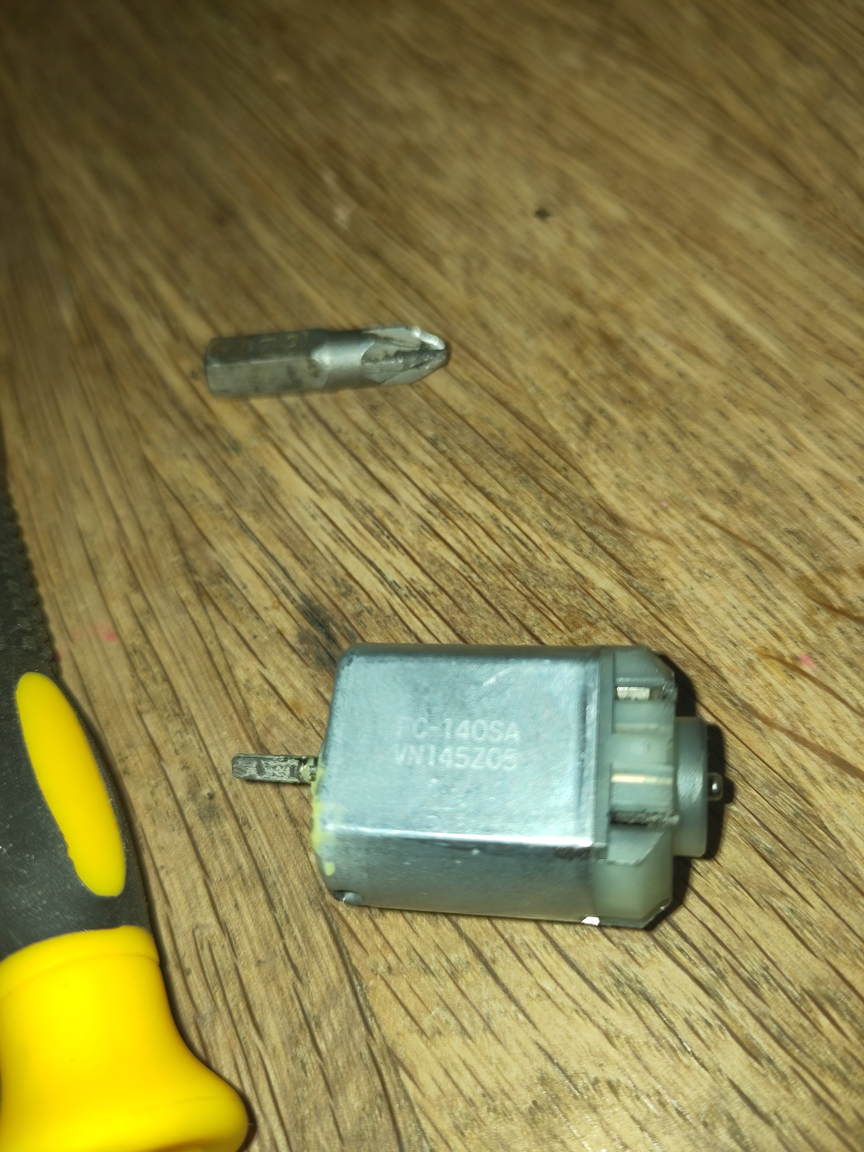

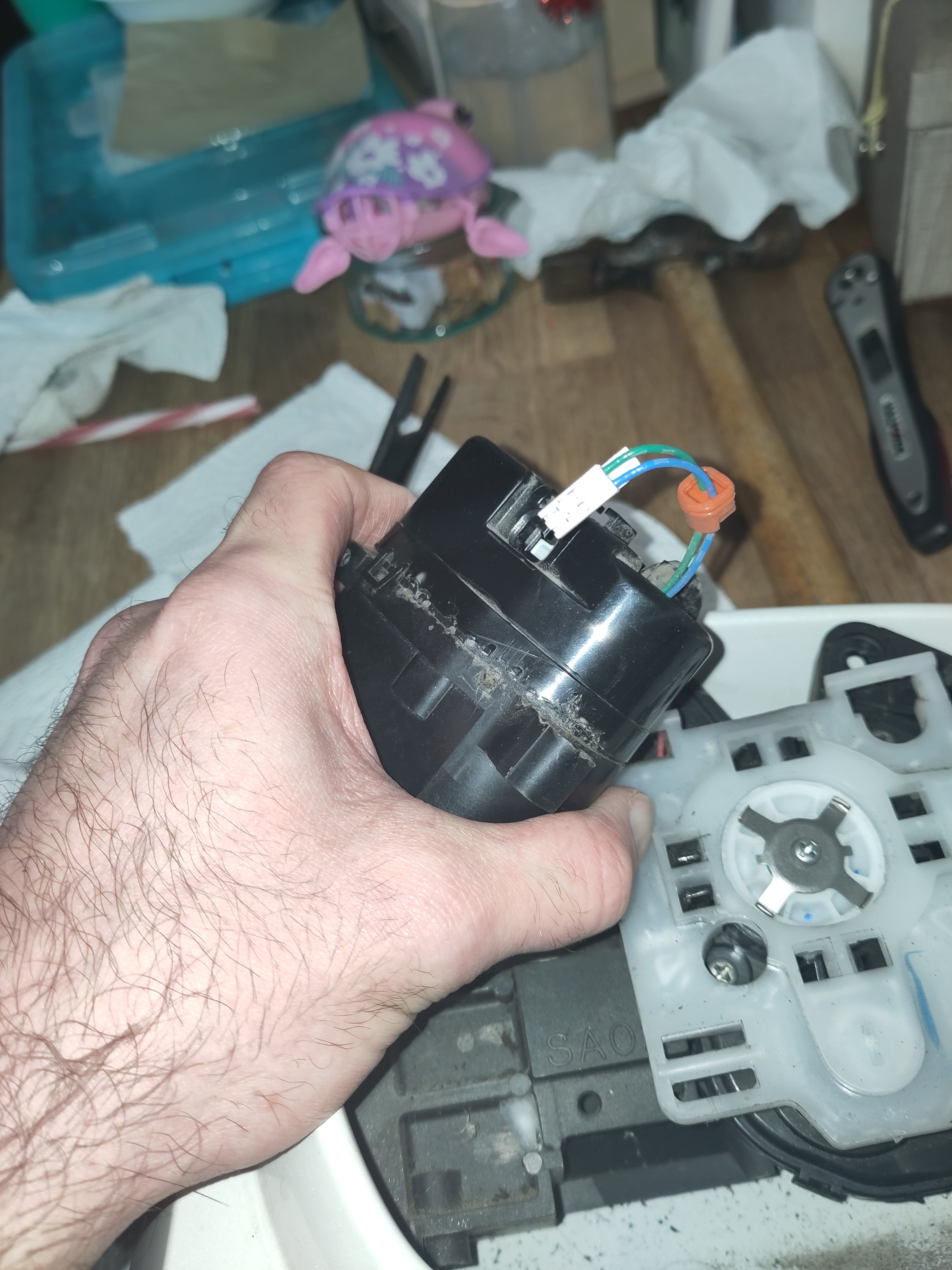

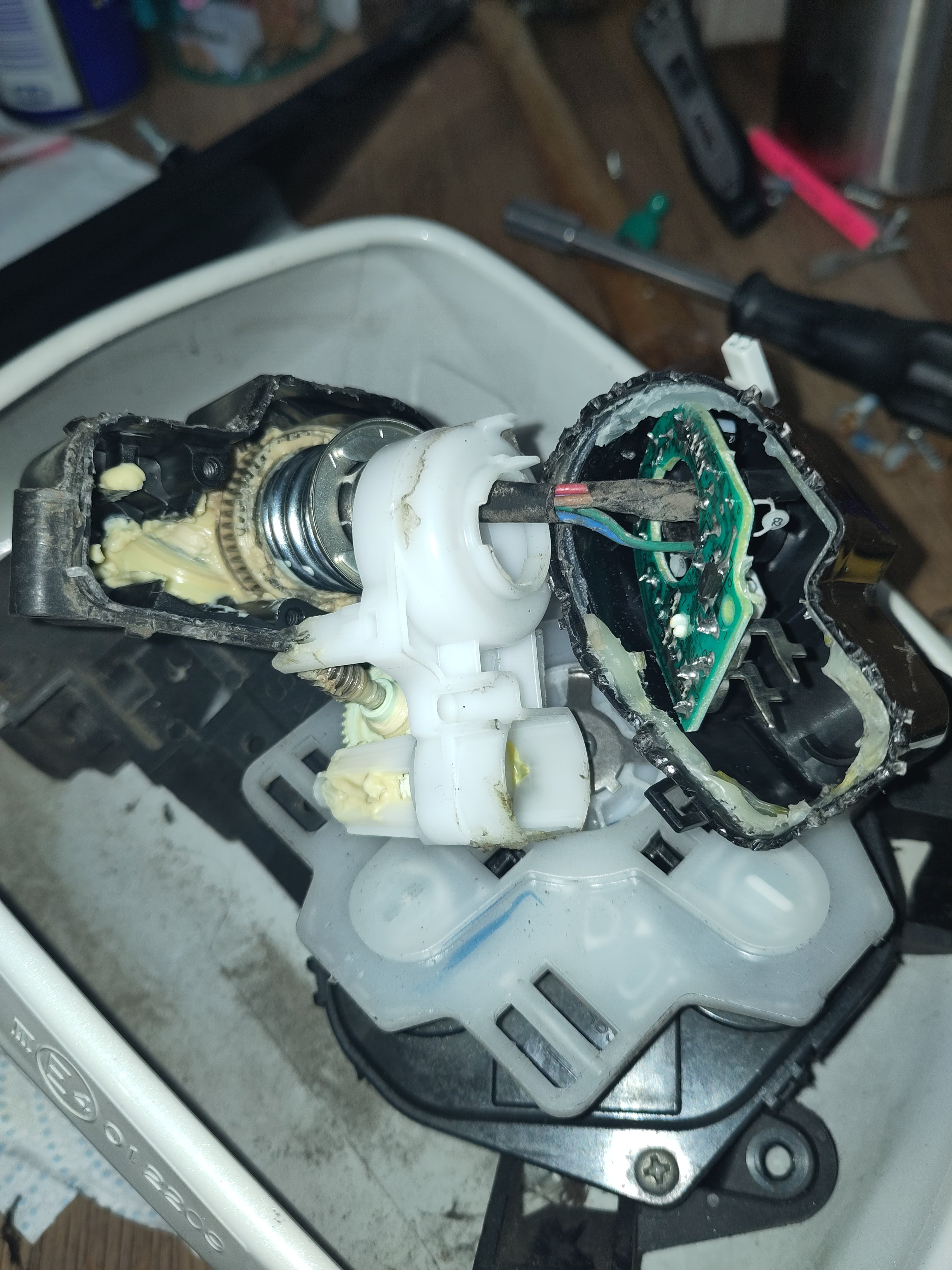

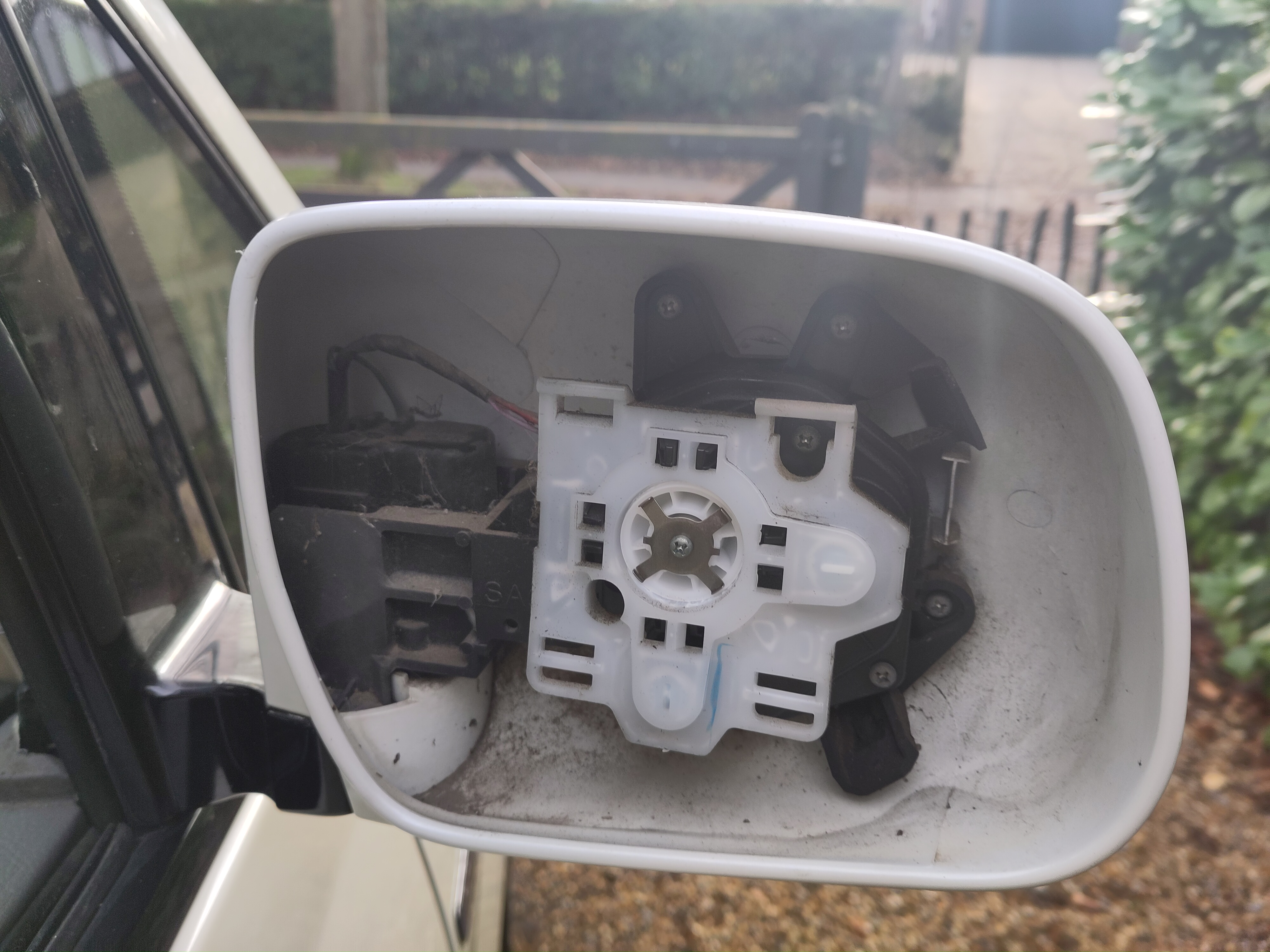

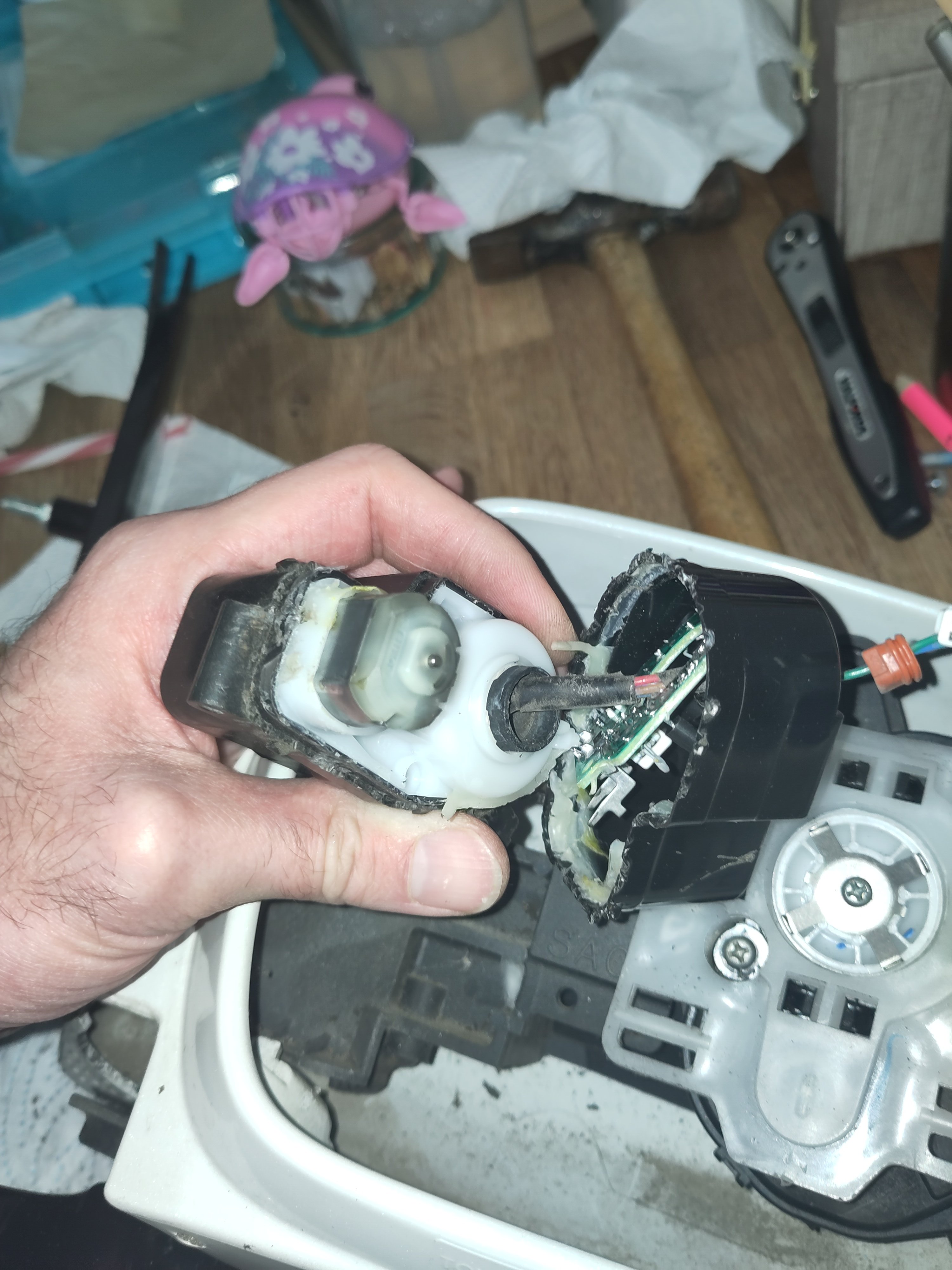

I decided to strip down the mirror assembly today.
Here's a few pictures. It motor unit certainly wasn't designed to come apart - the top cap was glued on! Made a bit of a mess of the plastic casing.
All cogs were fine, but the electric motor wasn't very free. I flushed it through with WD 40.
Once I put it all back together and plugged it in, the folding mirror moved slightly then stopped, almost like it was jambing or the motor wasn't up to the job.
Oh well, I 'might' see if I can get a replacement motor or I will just order a new mechanism....

I’ve just ordered LH and RH motors and will give that a go. I’ll measure the unit when it’s stripped down. Motors should come in March 🙂
Hi all,
finally got round to swapping the motor in the drivers wing mirror.
all sorted now! Works a treat 🙂.

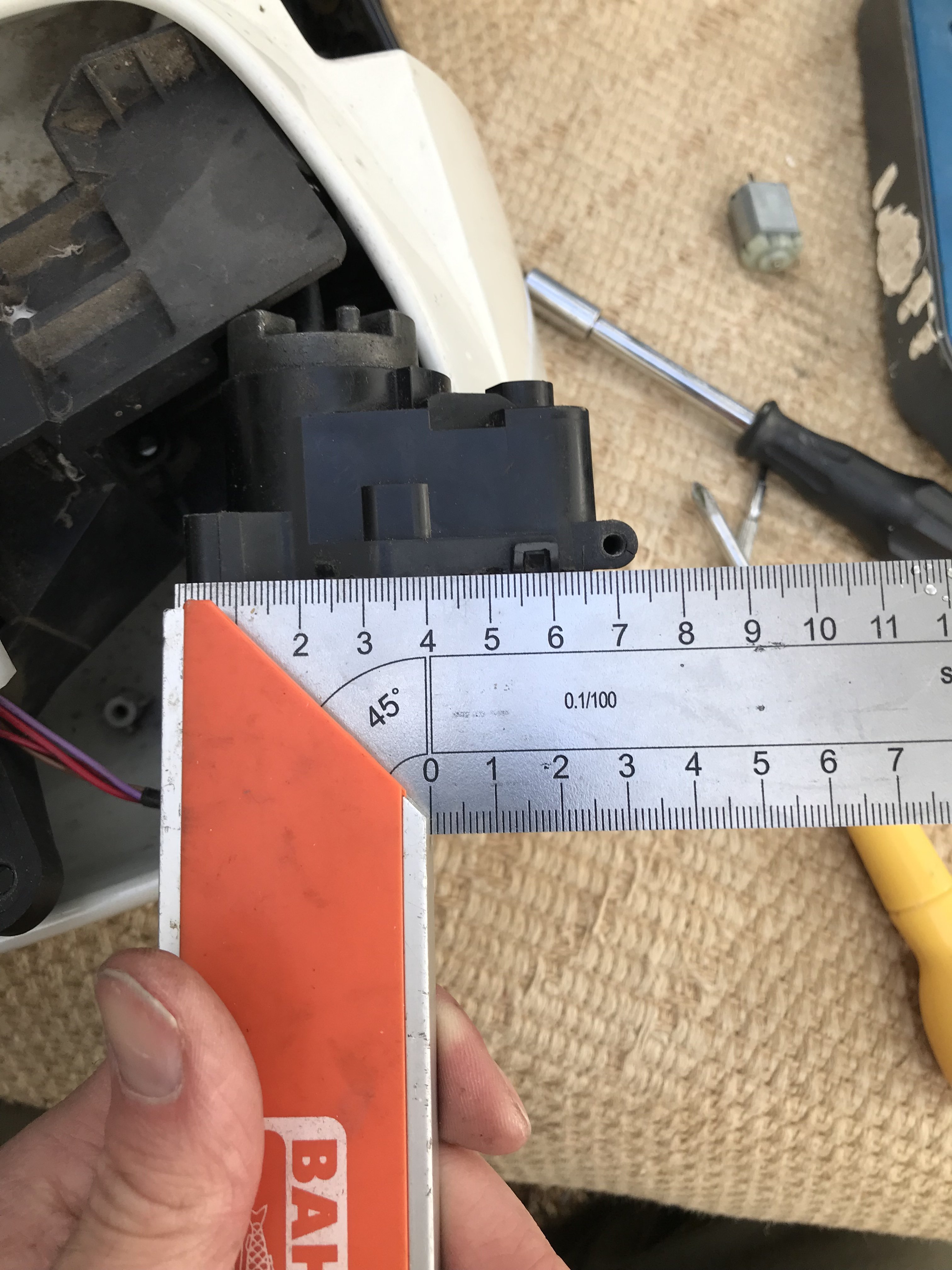

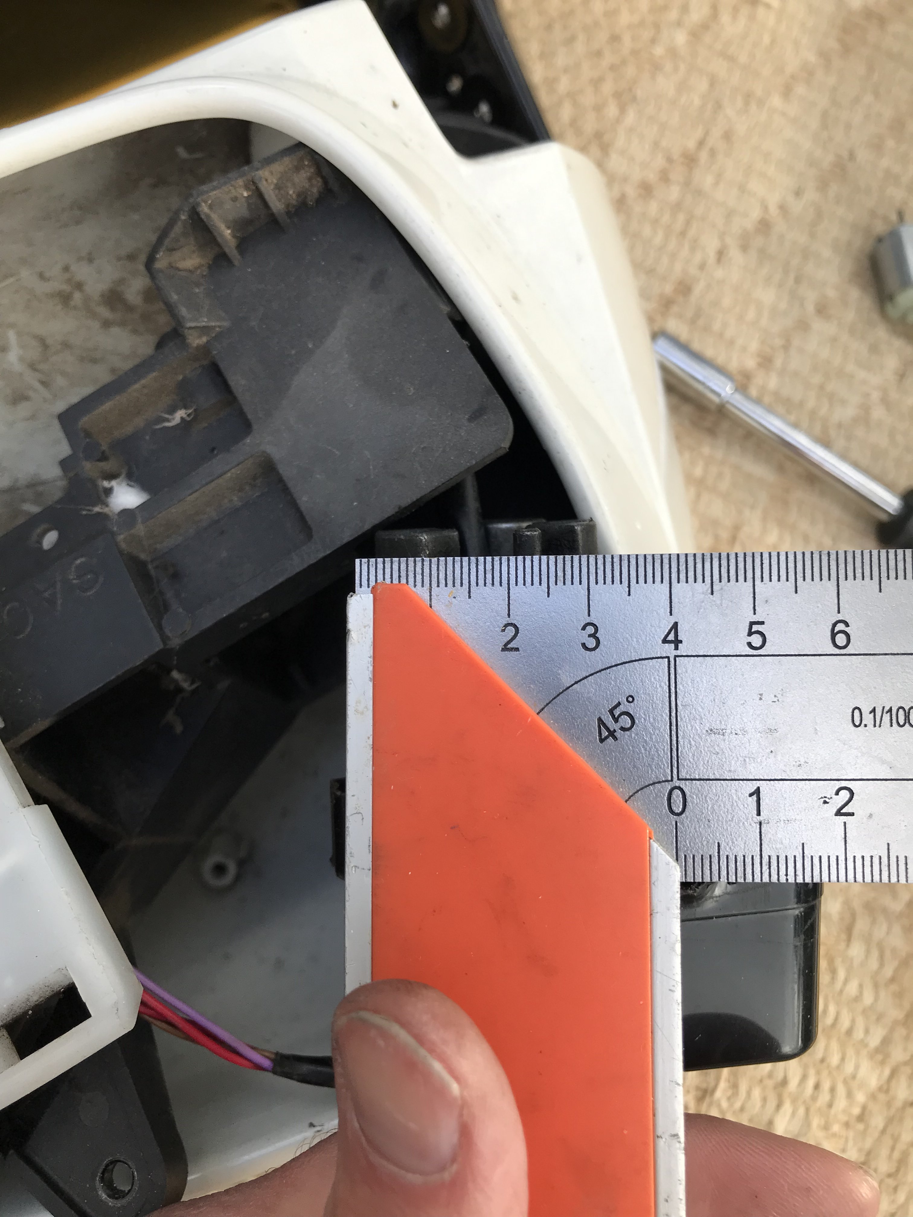

Also, @Picasso and @charliebrown the measurements for the unit were 73mm wide, and the base was 31mm wide. I’ll post the photos.
